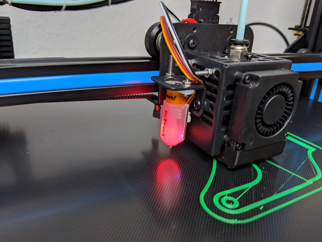

Hey,
I had to replace the Mainboard GTM32 pro. Now i flashed the firmware "A30_3D touch V3" and i tried neweset from the "smartto upgrader".
Everything works but when the auto level function is activated the printer thinks that the auto level sensor is located in front of the hotend (y-offset). But it is to the left of it (x-offset). With my old board and the stock firmware it worked fine.
Can sb point where i can set up the offset of the probe?
Thanks

- IMG_20190503_144233.jpg (176.9 KiB) Viewed 5066 times

EDIT!! Different Version of my A30
now i know where my problem is. if you look at the pictures in the manual and on the internet then the sensor is at another place.
But I have another HotEnd case from Geeetech.
There must be another firmware for my variant!! officially I don't find my variant (see first post).
This picture here is not the way my Geeetech A30 is assembled
i have already designed new ventilation ducts so i would like to build on the system i know. I need a current firmware with the sensor on the side (x-axis offset).
