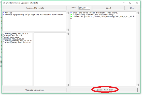

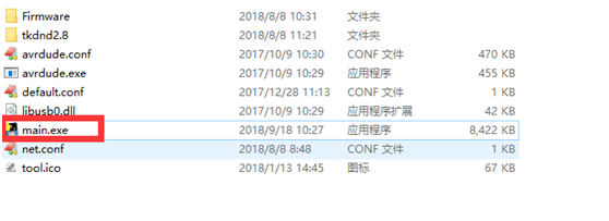

1. Go to the official website to download the toolkit first.
Then open the Smartto toolkit

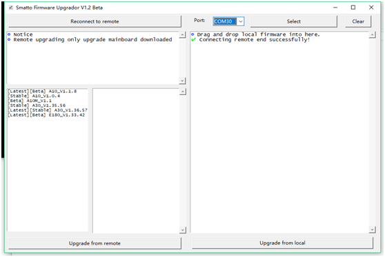

2.Select the correct USB port and select the firmware
3.Upgrade from the local
The printer configuration should be reset after a successful update to restore the default settings
first flash M file then S file
when you flash the S file,
need an sd card in the external slot
It is recommended to use the toolkit for updates.

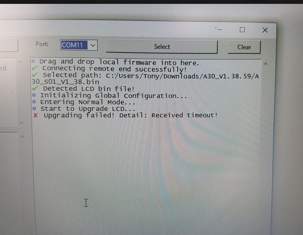

and if you have this problem during the update process
like this:

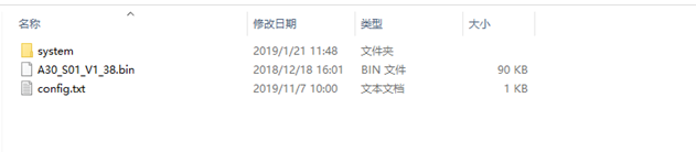

you need copy these unzipped files directly to the root of sd
T{O_EP4{%74[]2OU1UC5) 01(1.png (18.53 KiB) Viewed 849257 times

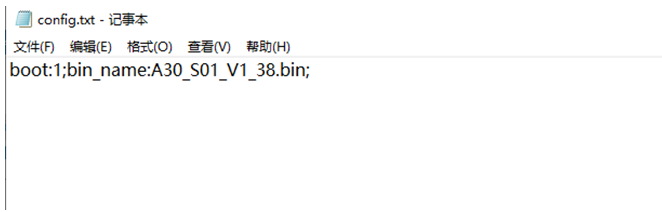

The config.txt file needs to be written by itself
Then insert the SD card into the SD card slot on the side of the screen and turn on the printer.
