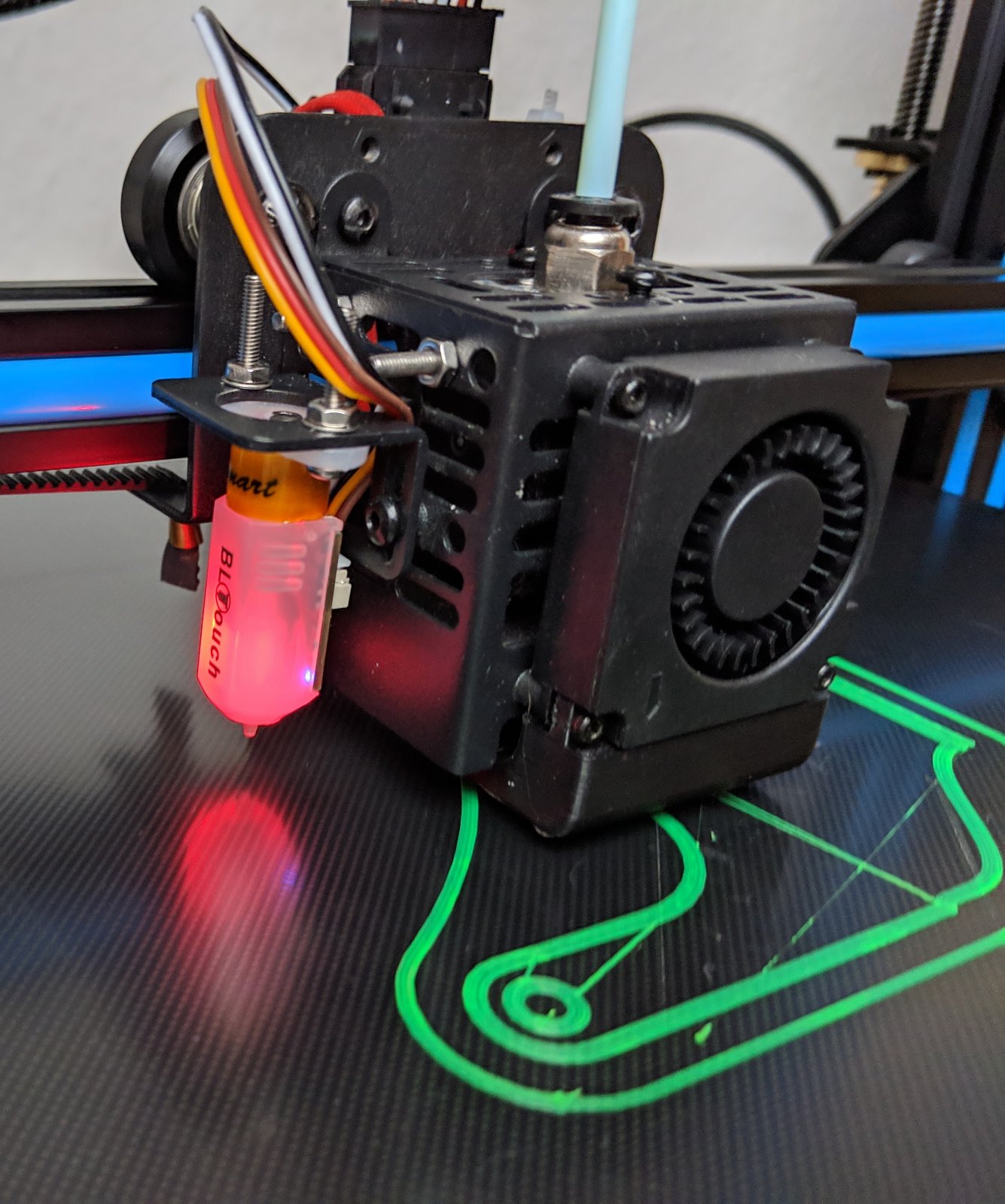

Hey out there. I really need your help to get my printer back to work. :cry:

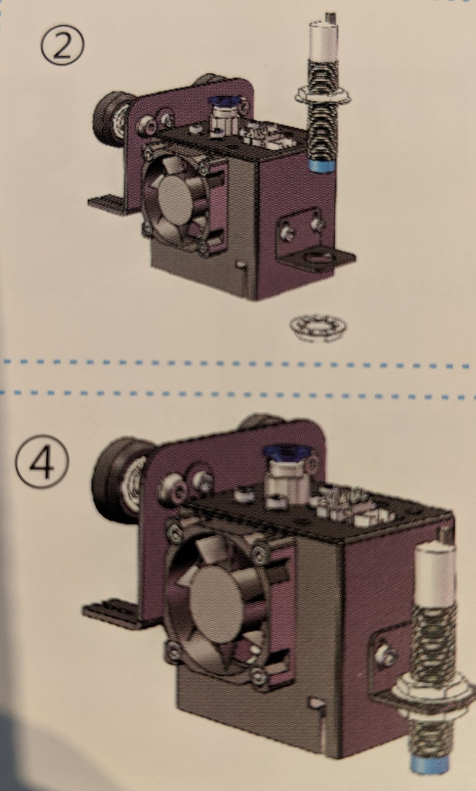

I think there are two versions of the A30. A version where the ABL sensor sits in front of the hotend(y-axis offset) and a version where the sensor sits to the left of the hotend(y offset). All firmware I've tried now has the sensor along the y-axis.
For me this is unfortunately wrong even it is the stock configuration. With an Auto Level it takes the dots relative to the nozzle wrong and often doesn't print well at the edge.
When the printer was delivered everything was correct. But I have a new motherboard and can't find the right firmware.
I also don't find any source code that I can simply compile with Arduino and bottles. The source code for Eclipse seems outdated and I'm probably missing packages.
I need a tip where to get the right firmware.
And a tip for a tutorial or similar to edit the firmware myself.
In the appendix again pictures of my printer with sensor compared to the pictures from the website. You can see the different positions of the sensor.
Changing the position is not possible because otherwise no part cooling is possible.
I think I have browsed all threads and can't find my problem, which surprises me.
If unclear I could also send a video showing the wrong Auto Level process.
My version with Sensor to the left.
Not my version with sensor in front
