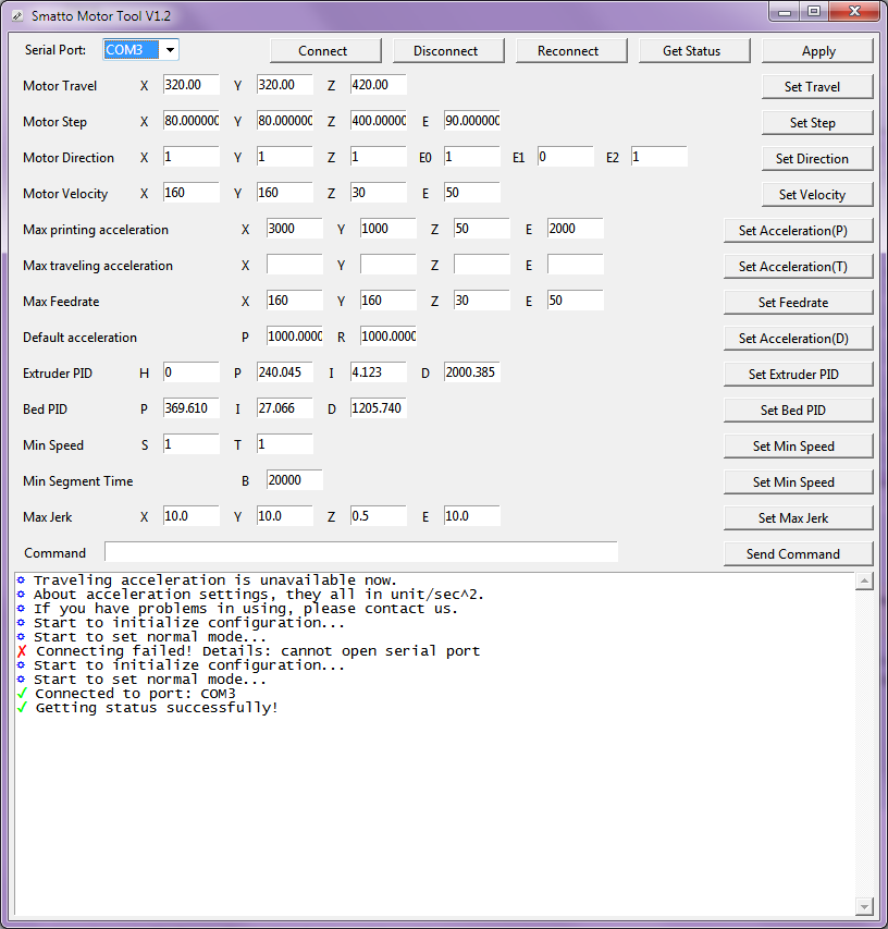

Hi All Geeetech A30 owners!
I recently managed to burn out my A30 motherboard (in general, it happened itself :) ). Could you please make screenshot of Your printer parameters (steps/mm., PID settings, etc) via Smartto tool? And post there in the forum, if possible. I need this to put together with firmware to the new mainboard, which is arrived already. Thanks!

Hi, do you mean configuration file?

And here is the Screenshot:
Note that you should calibrate the Extruder Steps (90 Default, for me it was about 98.9 after calibration) and that you can add slightly larger Maximum bed movement. I've set X 330, Y340, Z 420, check if that works for you as well (by Setting it and moving all axis to Maximum Position. If these values get your nozzle out of the bed area or there are any mechanical issues or the likes, reset to Default values).

Thanks! That's what was needed!
