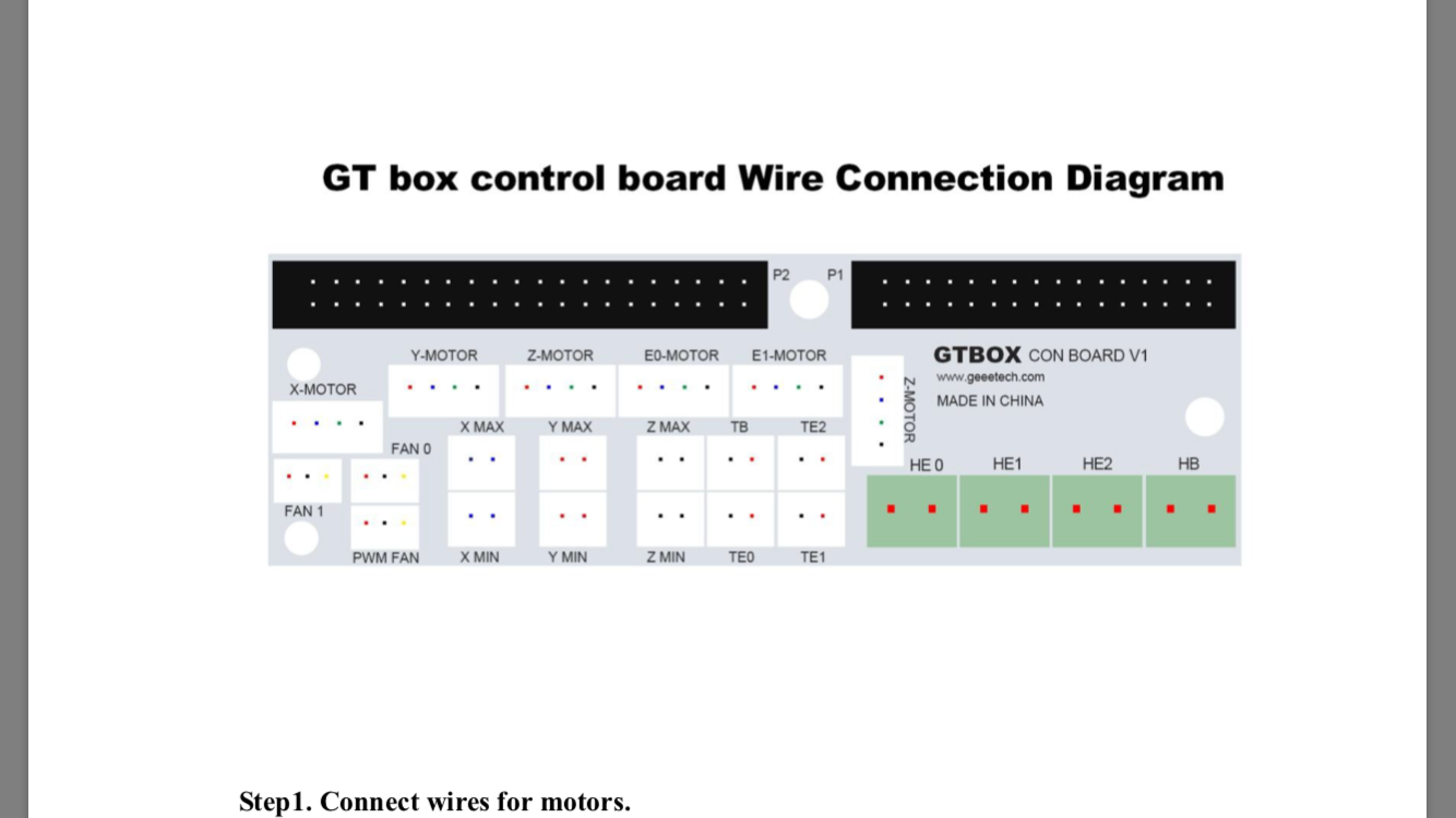

I’m in process of installing a 3D Touch to my Geeetech Aluminium Pro A and wondering if it’s necessary to go to the main GT2560 board. Having dismantled the 3 in 1 box found all pins are wired out to the sub board GT box on the printer. So if I wire the 3D Touch to the sub board with the 2 pin connector to Z min slot and then splitting the 3 pin connector using the 2 pin Z max and getting the 3rd pin power from the spare 5th servo position power pin.
My question is which pin is the live in the servo slot.
Barry

Re: 3D touch
Post by Barry-h »
Hi William,
thanks for the info But it does not show the GT box board.
I was hoping that I could Connect the 2 wire plug to Z min socket as per 3D Touch instructions and then split the 3 wire connector so that 2 wires connect to the Z max 2 pin socket and the 3rd wire to a pin on the E1 motor socket or somewhere else to get the 5v.
Hope this makes sense.
Barry

Hi William,
Can a inductive sensor be used and if so is there somewhere on the GTbox board to get the 5 volts
Cheers
Barry
