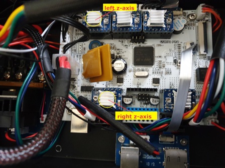

Many thanks for the answer. The problem is the stepper drivers of the z-axis A4988. The right one was faulty. How many volts do they need? These are now set to 0.750V. I want to know it very well, please. Do all other stepping drivers have to have the same attitude?
Thank you so much
Thank you so much

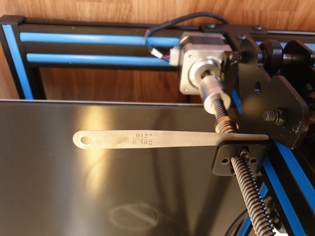

Addition: The right spintel nut of the z-axis I have also corrected with 0.30 mm.
