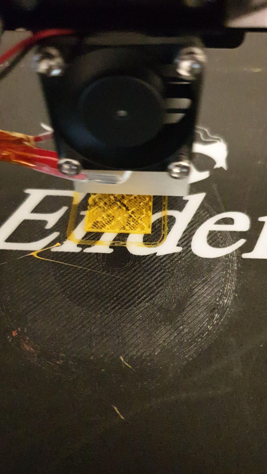

The Extruder Motors are so weak they are not able to push enough filament through the nozzle. Its under extruded. When i push the filemant by hand with a bit more force, the filament will extrude properly, so the nozzle is not clogged.
- hwuI0i5 - Imgur.jpg (262.33 KiB) Viewed 11251 times
