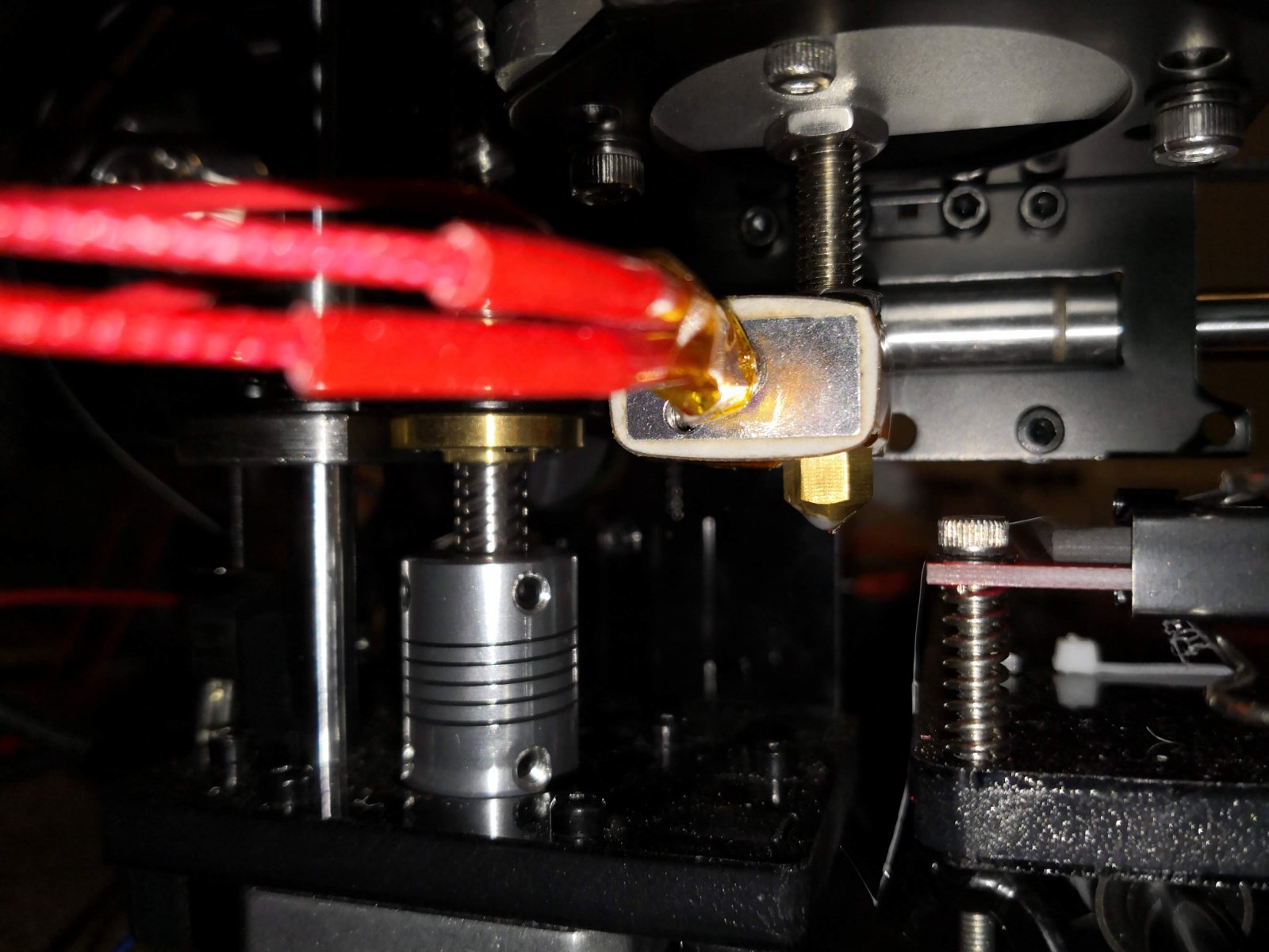

When I home the printer, the extruder moves to this position seen in the photo below, which is obviously below the plate and I'm not sure that's right?
But I don't know how to fix it.

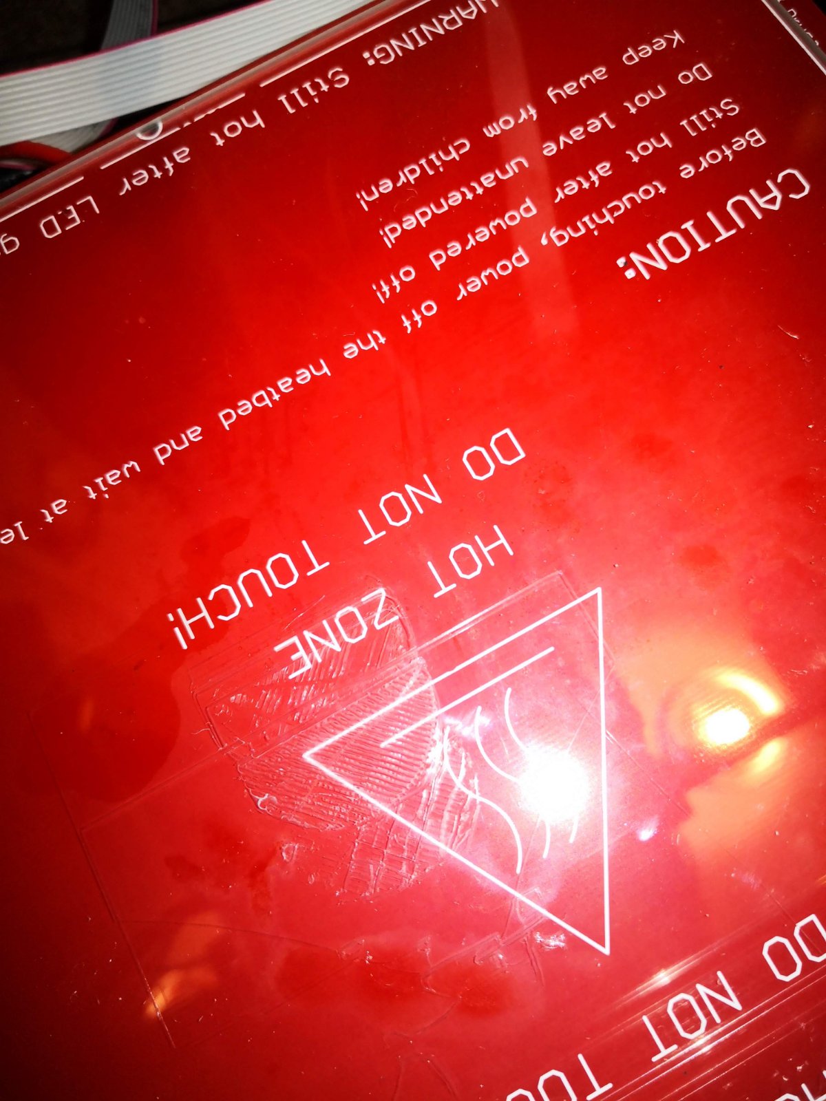

After attempting to print a Vase from the examples, again the extruder seems to press/drag along glass but I'm not sure how to fix that either.
It also doesn't seem to print any filament onto the glass, just makes really thin lines and doesn't layer anything as seen in the photo below:
I manually tested the extruder and it does extrude filament when I try it manually, but the lines don't seem that as much filament is being extruded as required?
(The filament is the start filament, which I presume is PLA 1.75mm although manual does not say)
Any help/advice much appreciated!
Re: First Time 3D Printing
Hi, you can try to install the limit switch slightly higher. From your print model, it seems that the distance between the nozzle and the hotbed is too close so that the printed object is pressed on the hotbed to make the consumables fail to discharge normally.

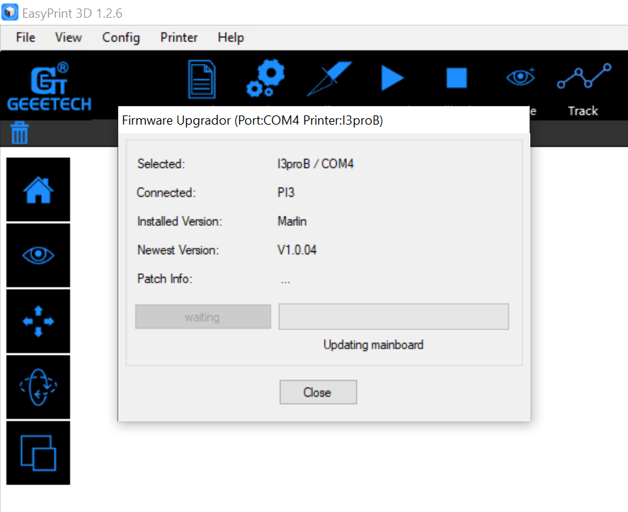

When I try and use the auto firmware updating in the Geeetech easy 3D print app, the following comes up:
Firmware Warning.PNG (34.55 KiB) Viewed 5567 times
It seems the app finds a mismatch between the printer selected and the firmware?
When I force it to update anyway, it doesn't update and just stays like this constantly:
Firmware Upgrade.PNG (85.3 KiB) Viewed 5567 times
I've looked at the downloads section on the Geeetech website for the i3 pro B, and there's a hex file to download, but I'm not sure what to do with that? If that's any relevance.

Hi, you can download the firmware on the official website to refresh the firmware, but I want to determine if your hot bed is level; for extruder extrusion problems, you can try to heat the extruder to 200°. Then manually push the consumables to see if they are discharged to determine if the nozzle is clogged.

Hi, the only firmware on the official website is in a hex file, and I'm not sure how to use the hex file for firmware upload.

Hi, The Hex file is compiled directly into the format.
For example,
you can use the Cura slicing software to update the firmware
Settings<printer< Manage printers- update firmware -chose file
I hope this can help you.
