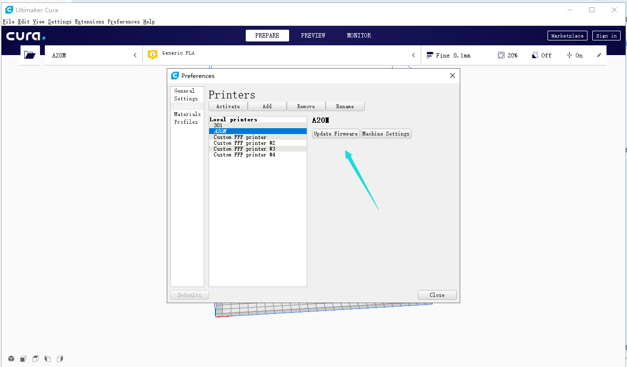

Hi,1. If you use Arduino for updates,
You can download the firmware you need here.http://www.geeetech.com/forum/viewtopic ... 20&t=17046
you can refer to this for specific operations:
http://www.geeetech.com/forum/viewtopic ... 20&t=17181

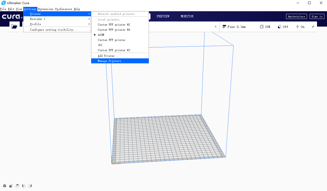

2. If you download the HEX format firmware from the official website,
you can try to connect to the printer for the update using CURA slicing software.
Update the firmware in settings-manger printer -printer
Configuration.h can be modified as needed;
HEX is firmware that has been compiled and cannot be changed.
You can download and update according to your needs.
I hope this can help you.

worked fine! Thanks! Firmware successfully upgraded!
