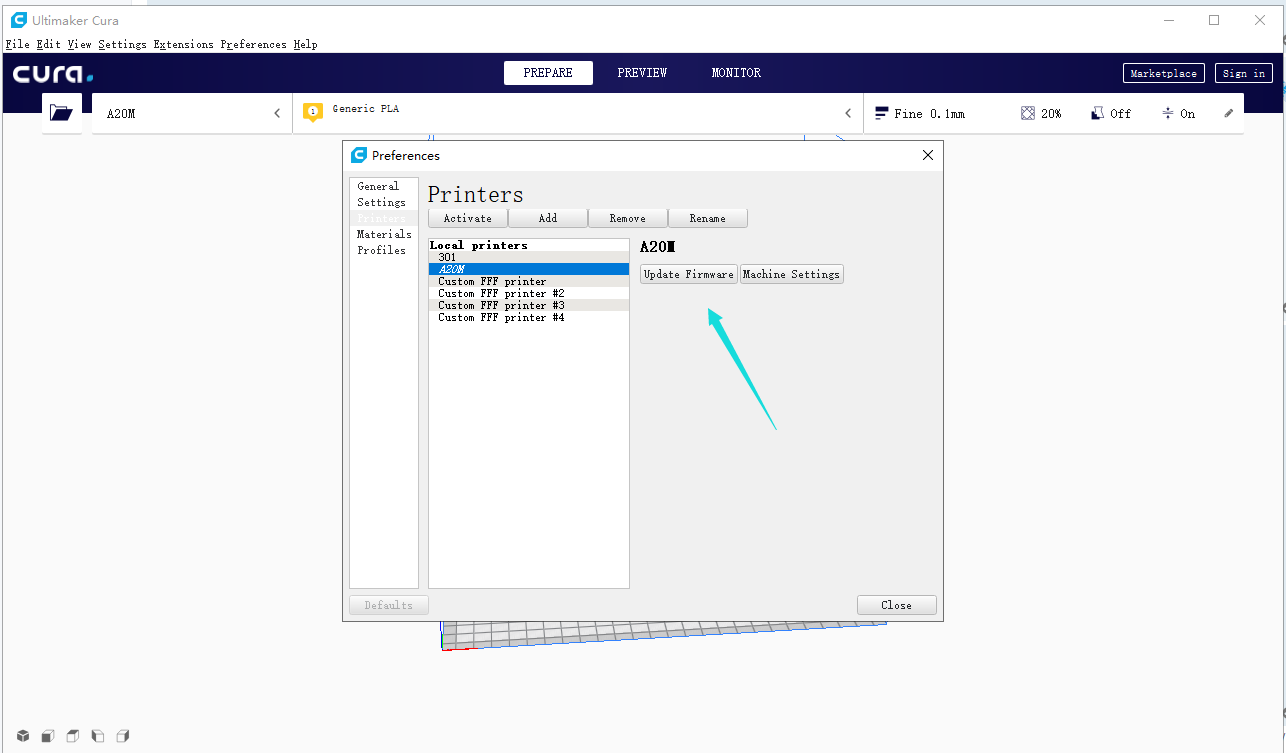

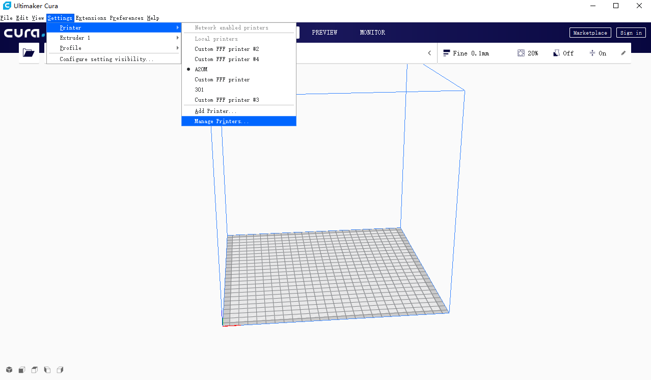

2. If you download the HEX format firmware from the official website,
you can try to connect to the printer for the update using CURA slicing software.
Update the firmware in settings-manger printer -printer
Configuration.h can be modified as needed;
HEX is firmware that has been compiled and cannot be changed.
You can download and update according to your needs.

by JoergC
worked fine! Thanks! Firmware successfully upgraded!
