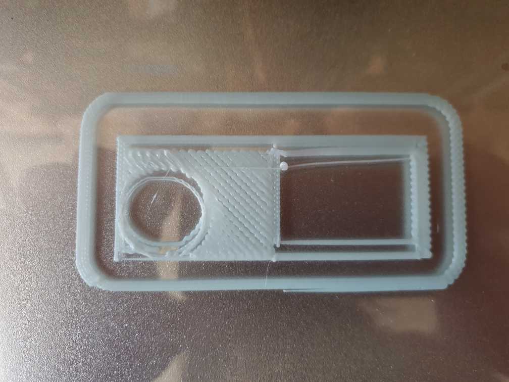

But all printing attempts gone wrong, because while printing the Y-axis seem to move!?
The printed lines wander in direction of the front of the printer more and more.
The grip of the filament on the surface of the glasplate is perfect.
I tried the newest version of Slic3r, the effect stayes the same.
I cant find a mechanical reason for this. Or can this happen, if the Y-Stepmotor is defect?
Additionally the printed lines are not straigt, they look more like a corkscrewer...
I reduced the printing speed to 30mm/s without effect, except longer printtimes ;)
Is there a configuration to fix this too?
I dont know, how to fix this. Can somebody help me, please?

The problem you're facing is layers shifting.
Almost everyone has to deal with it.
Look for topics in the forums that contain this problem. There are many of them. :D

Hi, You may need to adjust the belt tension on the y-axis;
The drive board voltage can then be adjusted (0.8-1.2V).

Your stepper motors do not give positional feedback to your printer. So, if you forcefully move your motor during print, then the printer will not notice, and simply pretend it never happened.
