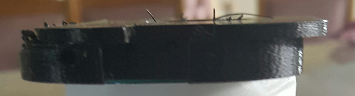

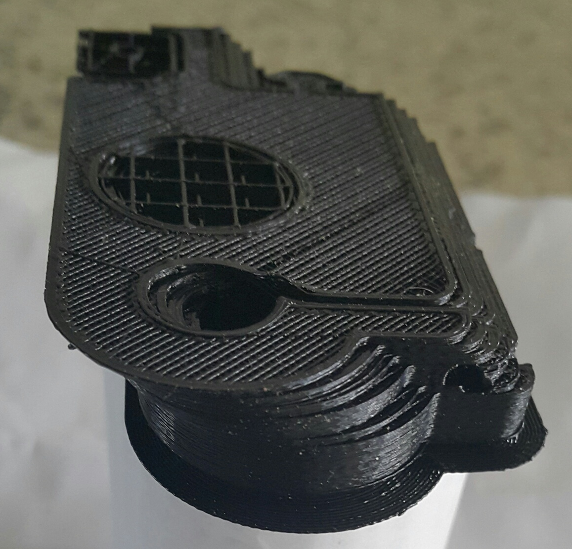

I thought I'd try printing from the SD card instead and what I got was after about the same amount of time the "Y" axis started to creep forward so instead of having a vertical edge to the part it would be stepped forward. I thought maybe I was unlucky and tried again but at the same time it started to step forward again.
