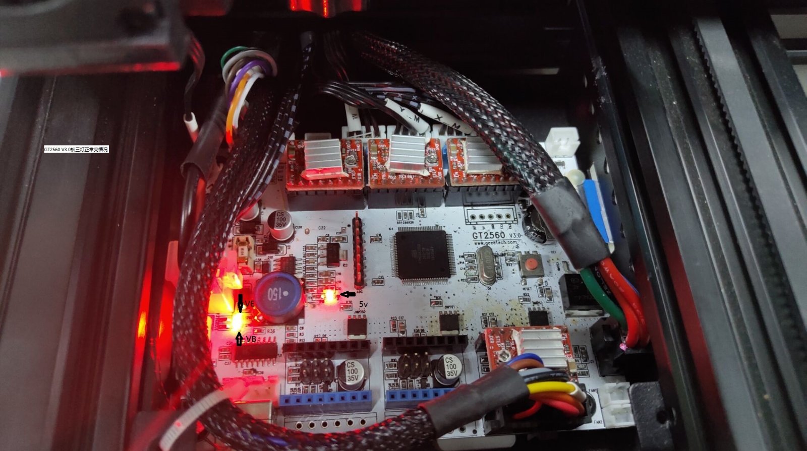

Hi, You can try
1. Reconnect the screen cable to try it out;
2. Check if there are three lights on the motherboard when the printer is turned on.
You can refer to this: I hope this can help you.

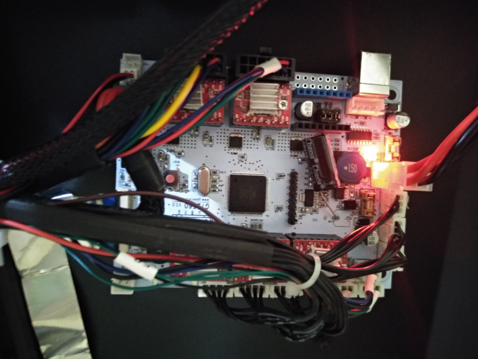

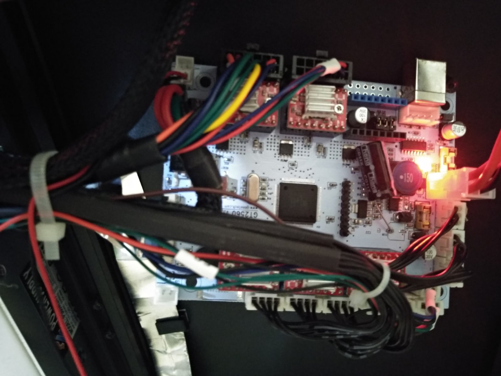

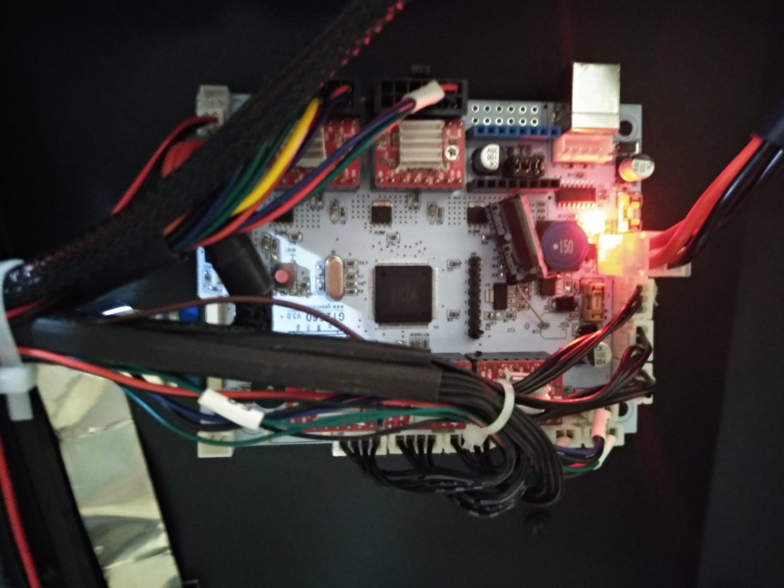

Re: LCD doesn't work, power supply is on, USB not detected from PC
only one light for me, the one 12 VB
the led on power supply is green.
I need another motherboard?
Hi, If only one light is on, it is not normal.
You can contact your sales to replace the motherboard.
Problem solved by Geeetech support that sent to me a brand new gt2560. Thank you!
