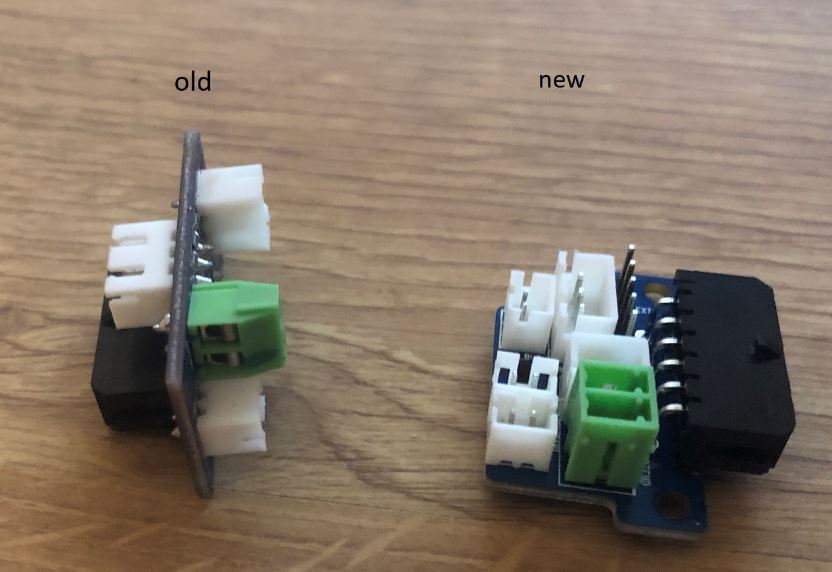

Hi, is there anything to change from the wires when i connect a new extruder Extension Board to my A30? on the original board all temperatures are ok but on the new from geeetech the hotend shows minus degrees and fans don't turn

I checked yesterday all connection 2times but i have only 15volts output on the connector for proximity switch(i think the new board is 12v), on the old(original board) the output is 24volts on the same pins. my A30 is a 24volts version but i have not seen anything on the website with 12v version and 24v version.
in the first step i thought the board is defect but i ordered 2 and on both is the same. so i went back now to the original and think the boards are for the trash can.

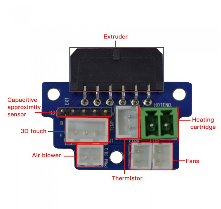

Hi, You can refer to this to connect:
Re: Extruder Extension Board from Geeetech
Aren't the capacitive sensor and 3d touch sensor connections reversed in this description? The 3d touch sensor has 5 wires and the capacitive sensor only has 3 wires.
Hi,there is no problem connecting as shown.

William, jm1 seem to be right, the BLTouch/3DTouch needs 5 wires and I recently connected one to the connector with 5 pins with success - it is not possible to connect 3DTouch to 3-pin connector.
