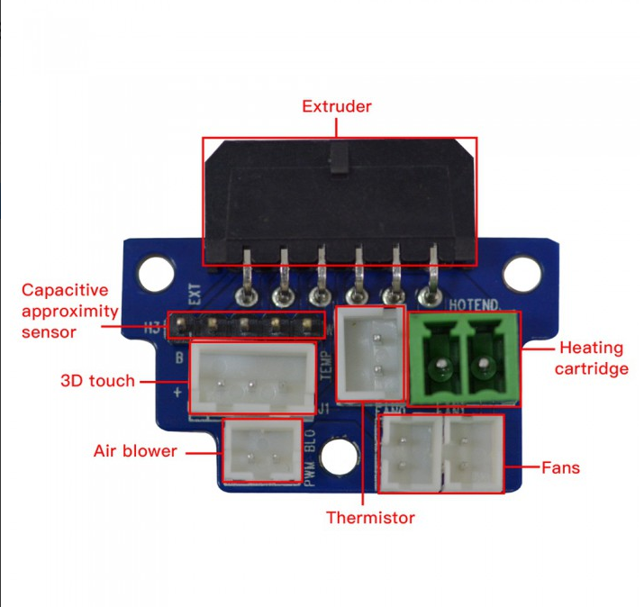

Hi, You can refer to this to connect:

Aren't the capacitive sensor and 3d touch sensor connections reversed in this description? The 3d touch sensor has 5 wires and the capacitive sensor only has 3 wires.

Hi,there is no problem connecting as shown.

William, jm1 seem to be right, the BLTouch/3DTouch needs 5 wires and I recently connected one to the connector with 5 pins with success - it is not possible to connect 3DTouch to 3-pin connector.
