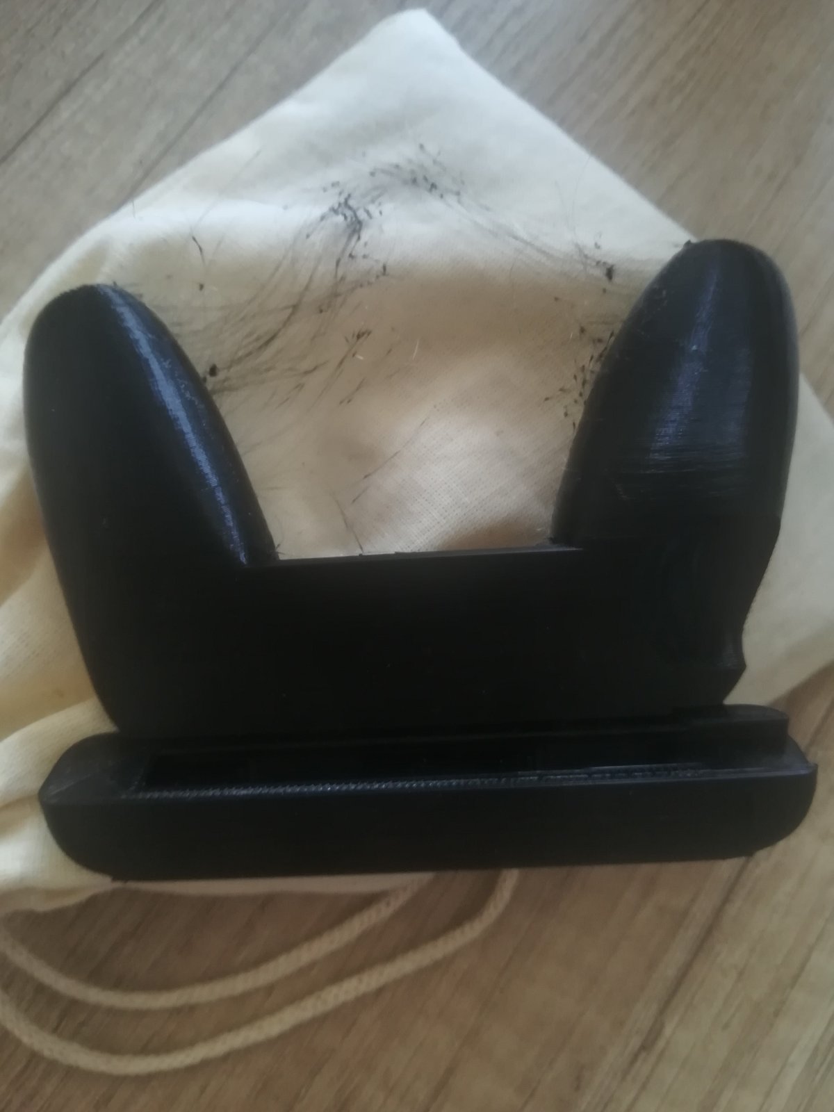

One month ago, I bought the Geeetech A10M. From the Beginning i had bad stringing / oozing problems. In this forum i found the solution, which said to remove the little disks from the hotend. I removed them and started to find the best retraction settings. First i used two little 2mm cylinder which had a distance of 12mm. I found the best setting at 6mm by 40mm/s. Then i printed this controller grip and had bad stringing.
stringing switch controller.jpg (125.88 KiB) Viewed 13984 times

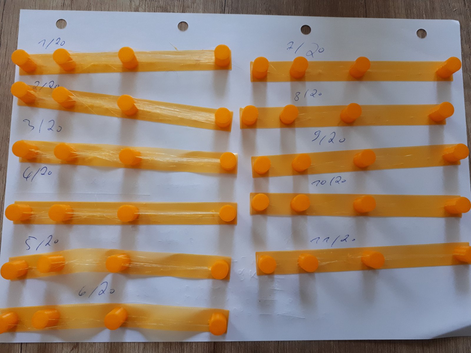

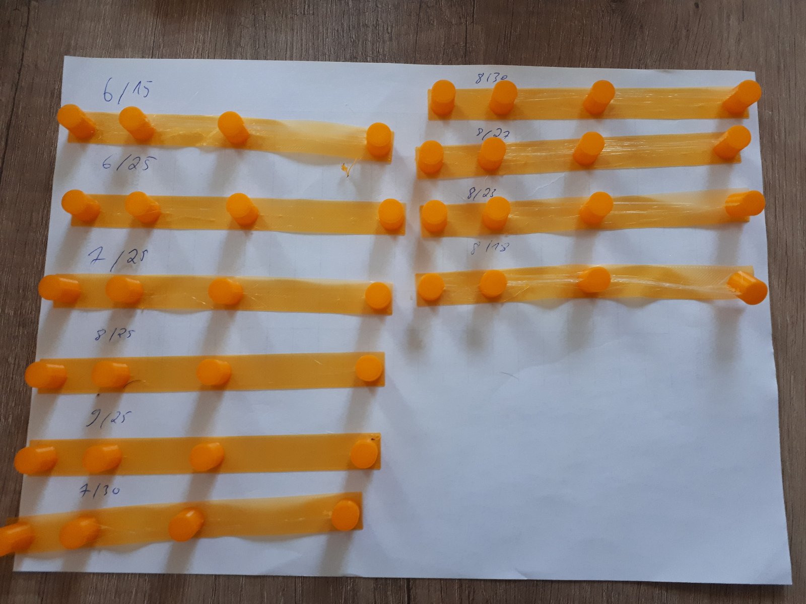

I decided to print another stringing test which had 10mm cylinder with distances 15mm, 30mm and 50mm. I startet with 1mm up to 11mm at 20mm/s. I found the range 7 to 9mm are the best. I increased the speed up to 25 and 30 mm/s.
string test 1.jpg (216.06 KiB) Viewed 13984 times
string test 2.jpg (222.82 KiB) Viewed 13984 times

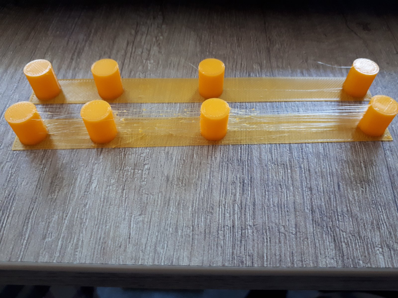

Today i want to check if 8mm at 25mm/s is best and printed it again. but now i have stringng which is really bad. Here you can see both prints with 8mm at 25mm/s
8 25.jpg (338.07 KiB) Viewed 13984 times
Can anybody helb me? I have no idea what i can do now. What cold be the reaseon, why i have different results with the same settings?
