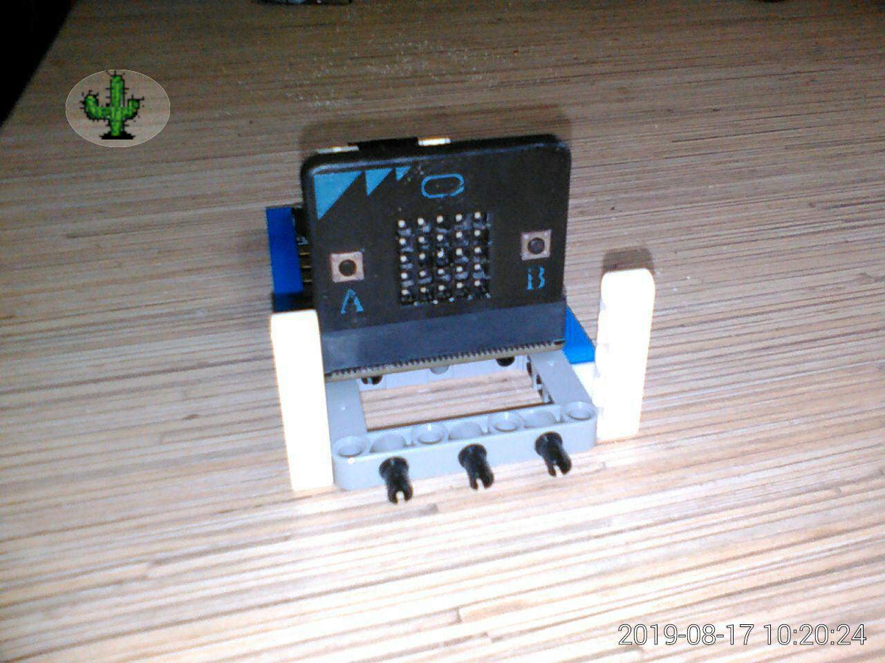

The M201 is known for its ability to mix colors and create gradients. However, there is nothing to stop you from also making printouts where the two colours are clearly separated. This way you can achieve interesting effects. :!:
In order to achieve an effect similar to the one presented below, it is sufficient to properly prepare a model design. :idea:
The blue elements are very small, which was an additional difficulty.
For making this model I used a nozzle with a diameter of 0.3mm. 8-)
If someone would like to make similar prints but does not know how to do it, please ask, prepare a manual. ;)
Geeetech filament, ABS only
