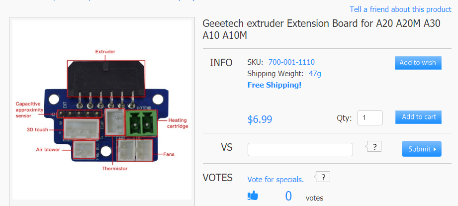

So I contact where i bought the device from and they say i don't need to solder 3 pins as there is a 3 pin header down near the thermistor connections I should use? does this make sense?
Re: 3d touch with Prusa I3 W
This is the board I have, I've connected it up this way and it doesn't respond to test codes, I assume this is because the pin is different do you know the pin number, or would you advise to use the top header only
