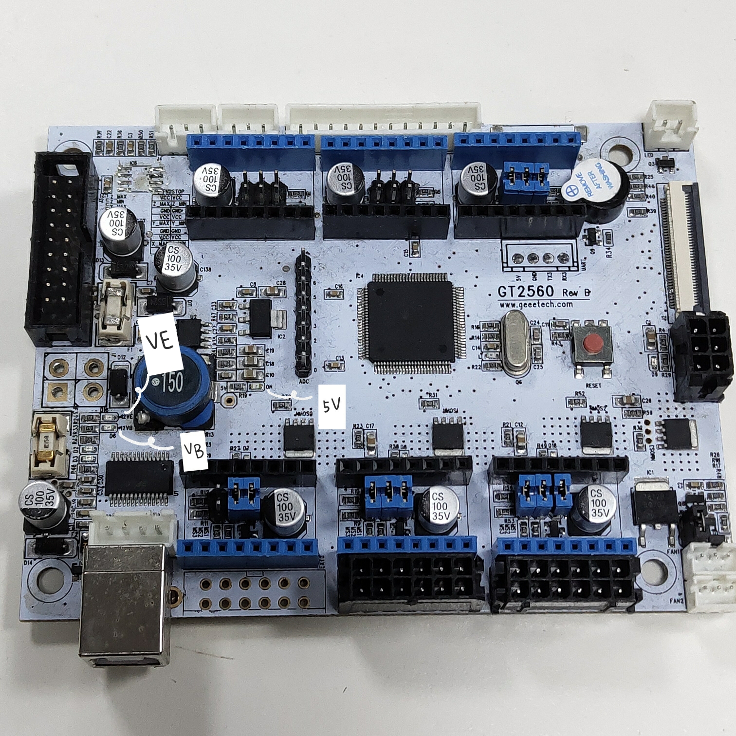

Picture of the normal lighting position of the GT2560 and GTM32
1.GT2560 Rev A+
A+ 三灯亮起的位置.jpg (1.43 MiB) Viewed 29709 times

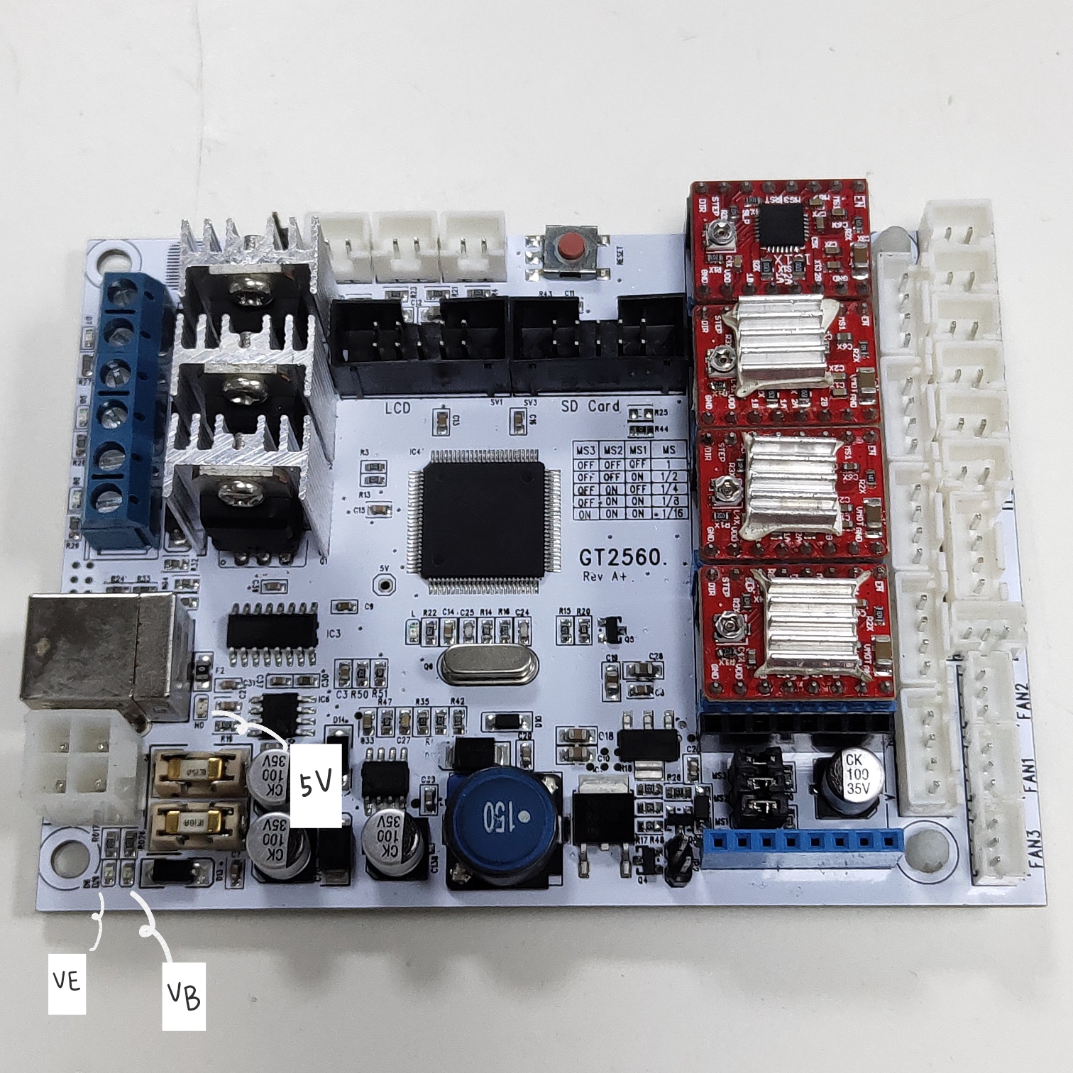

2.GT2560 Rev B
Rev b.jpg (1.59 MiB) Viewed 29709 times

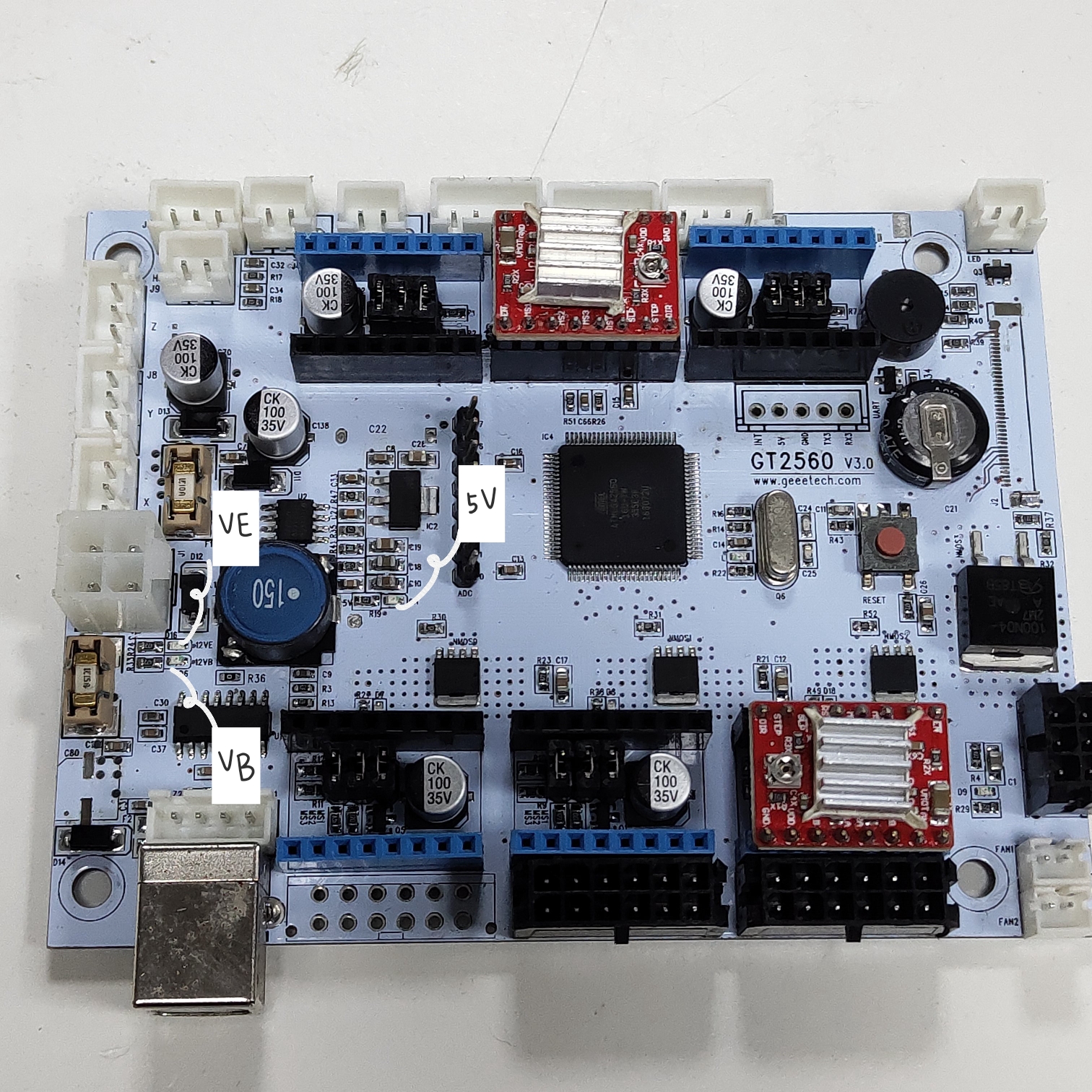

3.GT2560 V3.0
V3 三灯亮起的位置.jpg (1.51 MiB) Viewed 29709 times

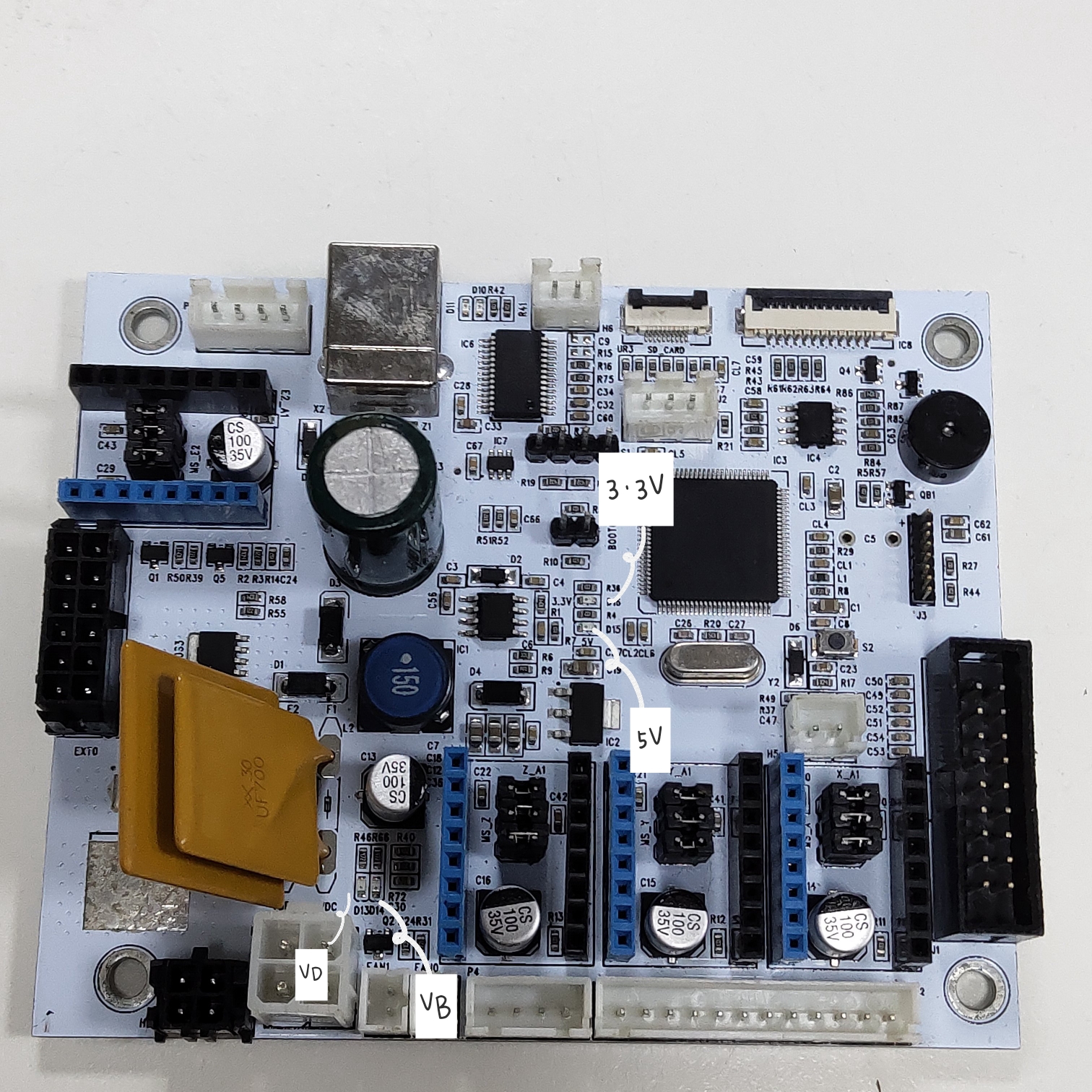

4.GTM 32 MINI
mini 板.jpg (1.44 MiB) Viewed 29709 times

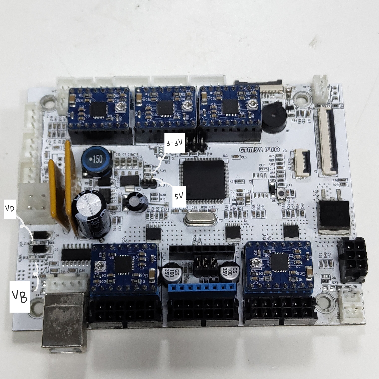

5.GTM 32 PRO VB
GTM32 VB 亮灯位置.jpg (1.39 MiB) Viewed 29709 times

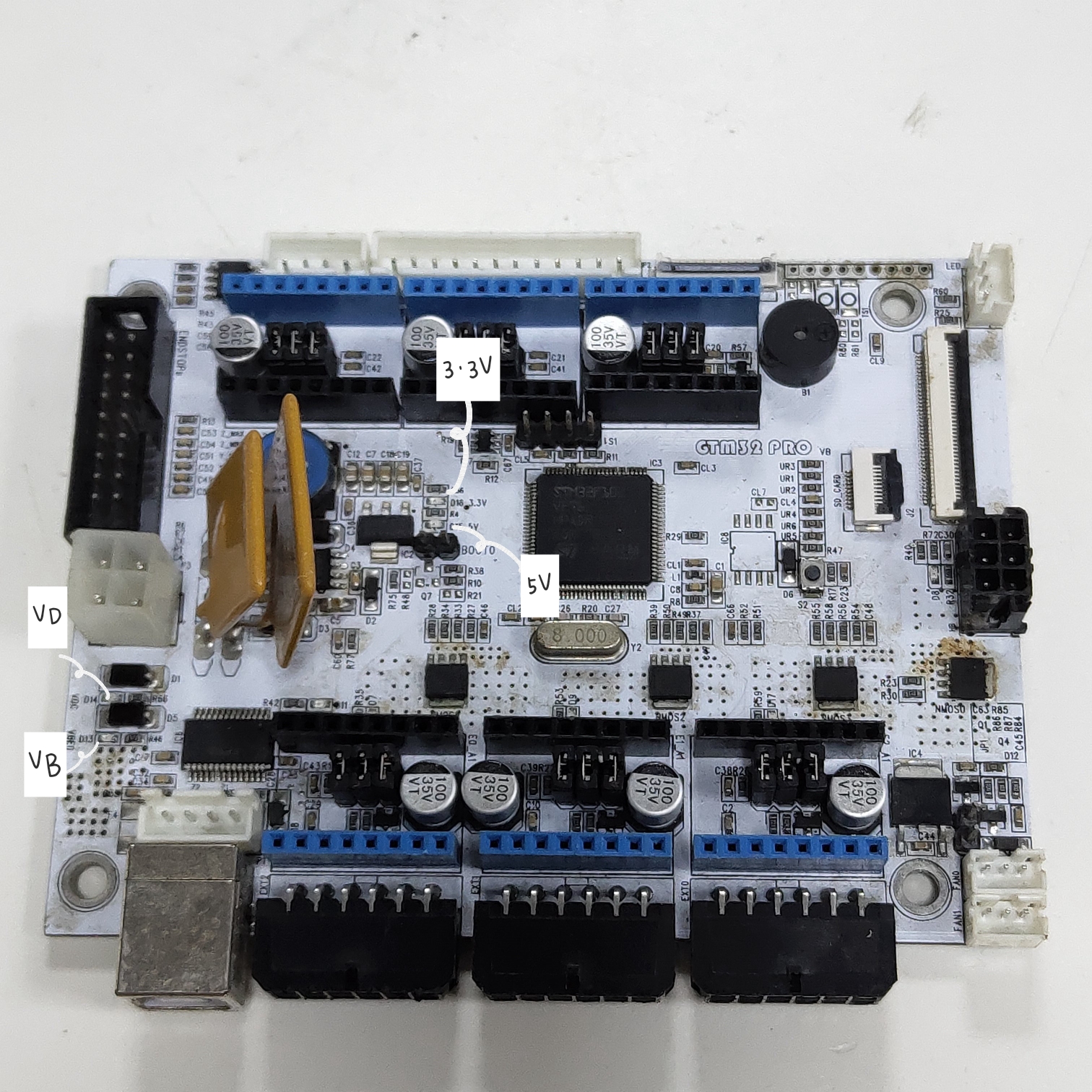

6.GTM 32 PRO VD
GTM 32 VD 亮灯位置.jpg (1.37 MiB) Viewed 29709 times
