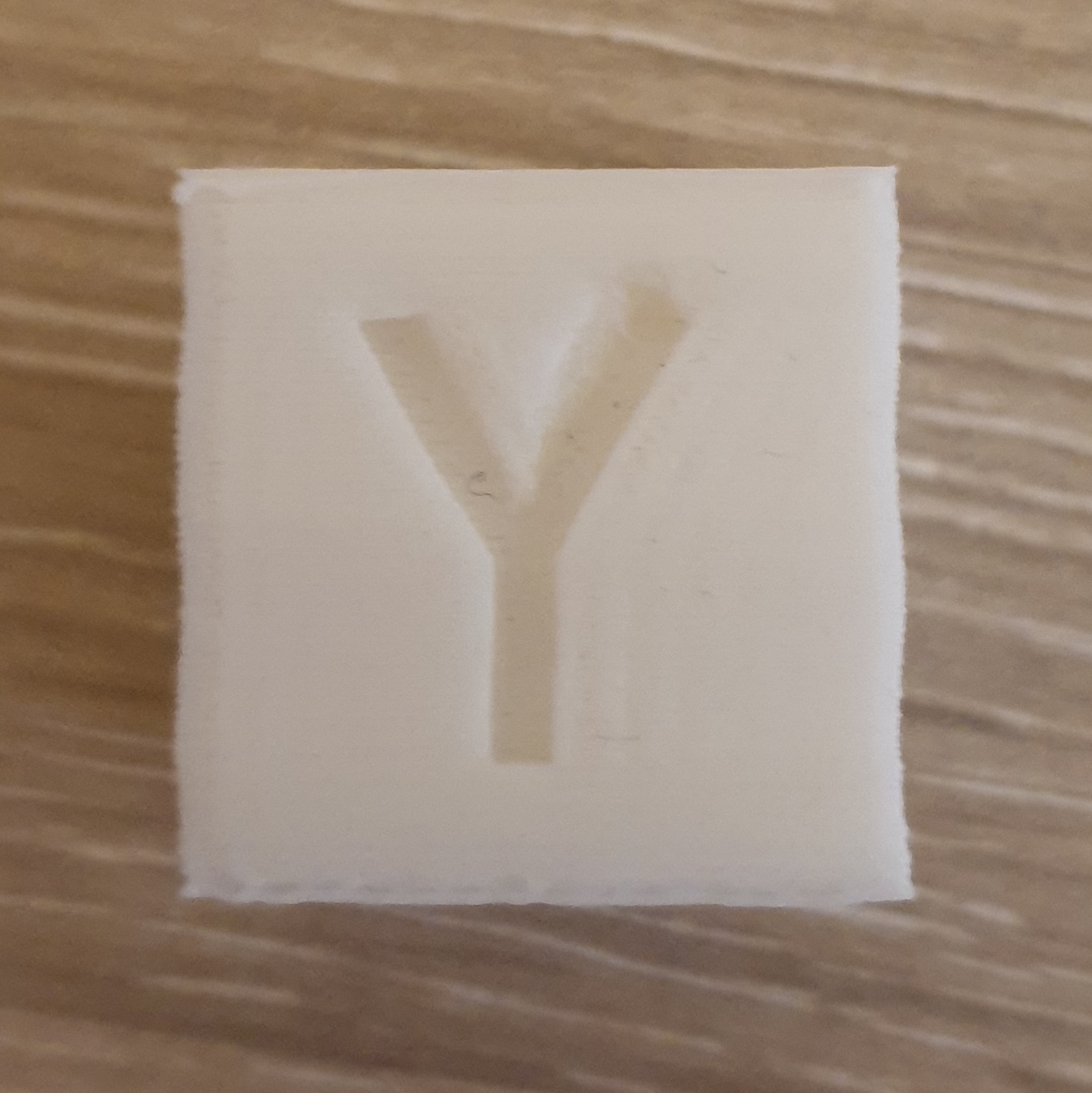

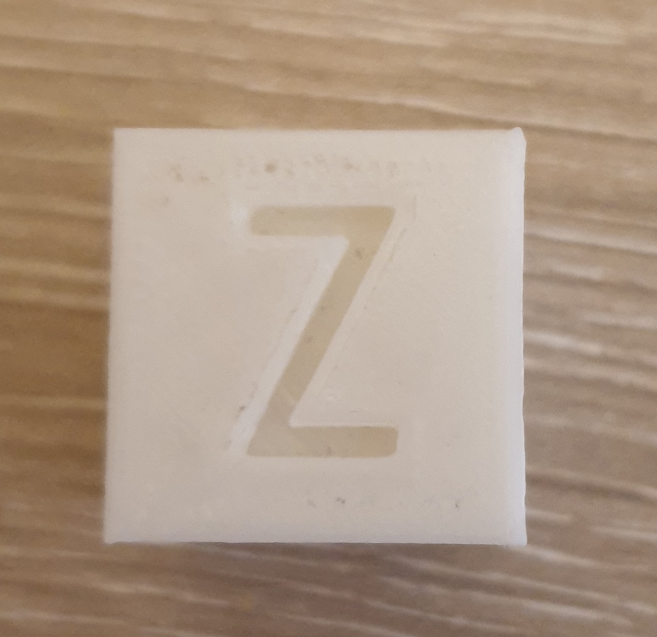

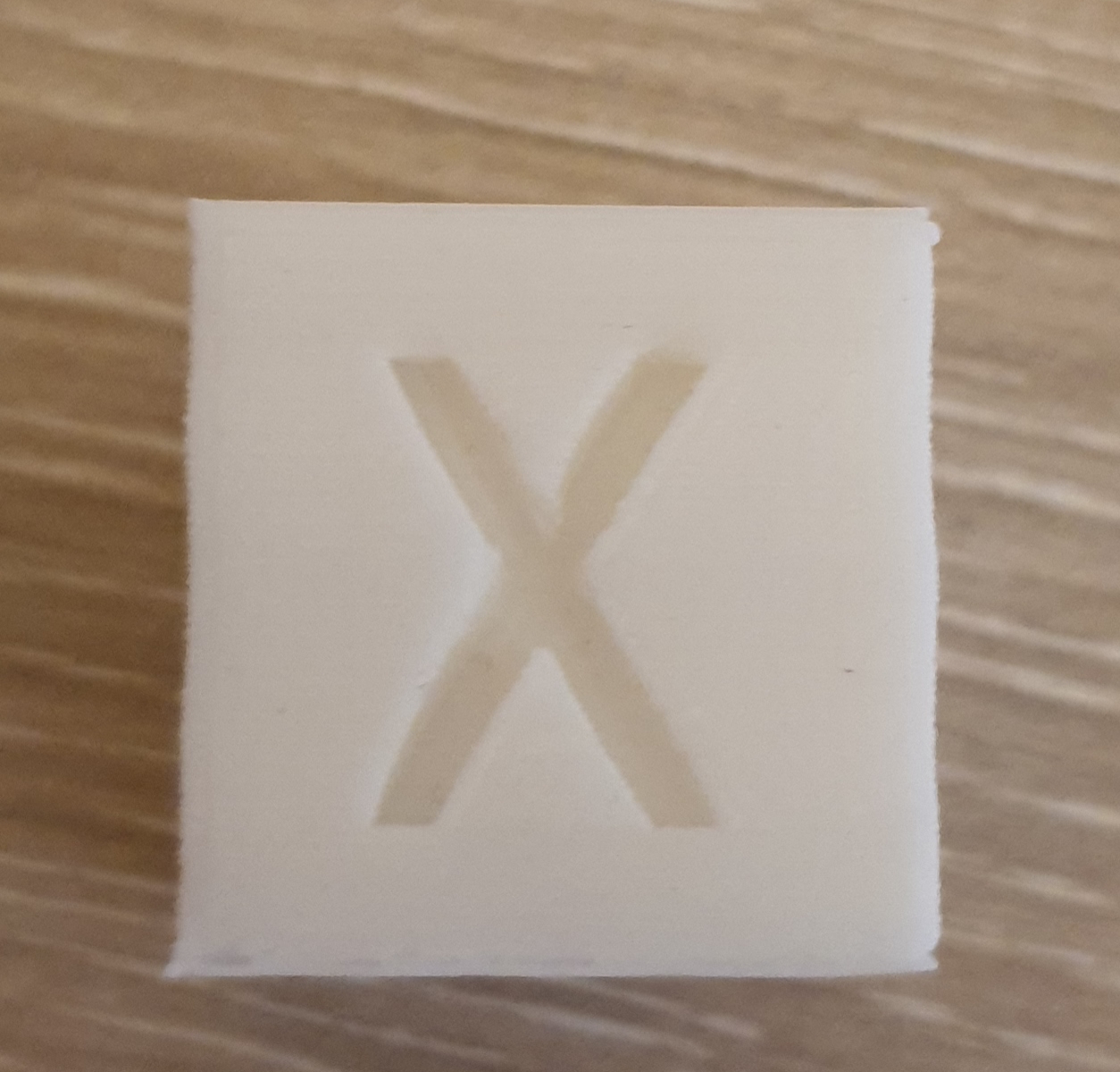

I have test to print a calibration cube and i have imperfection.
Can you help me to understand the problems?

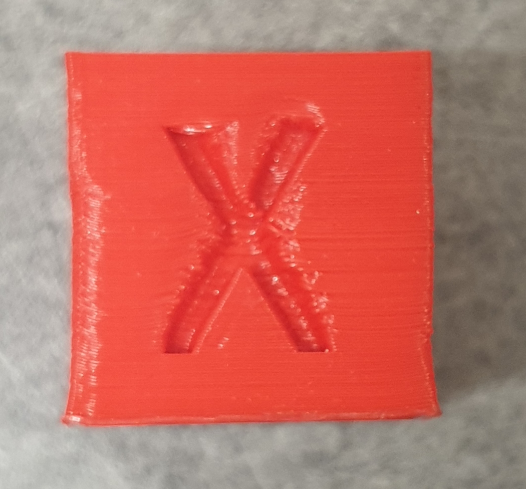

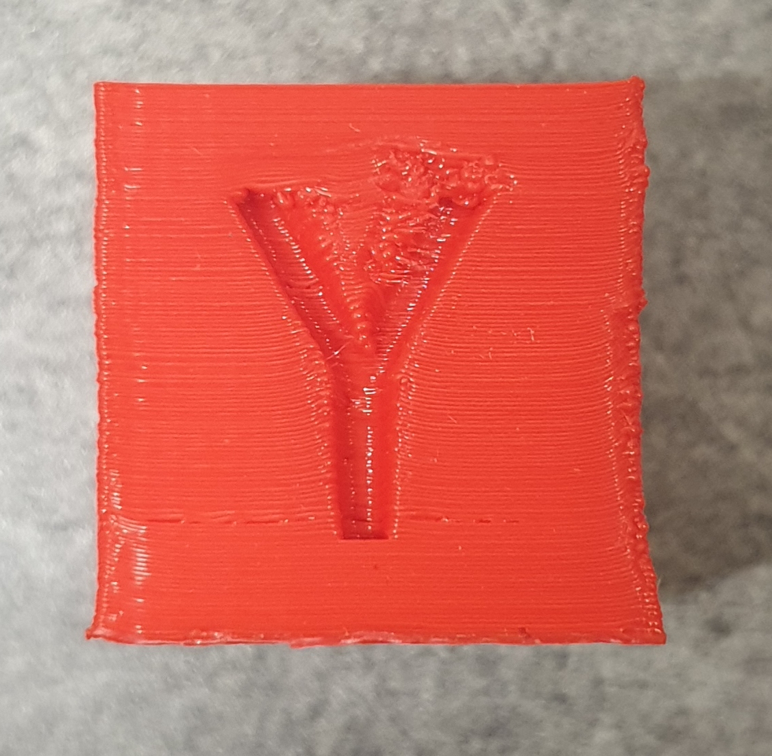

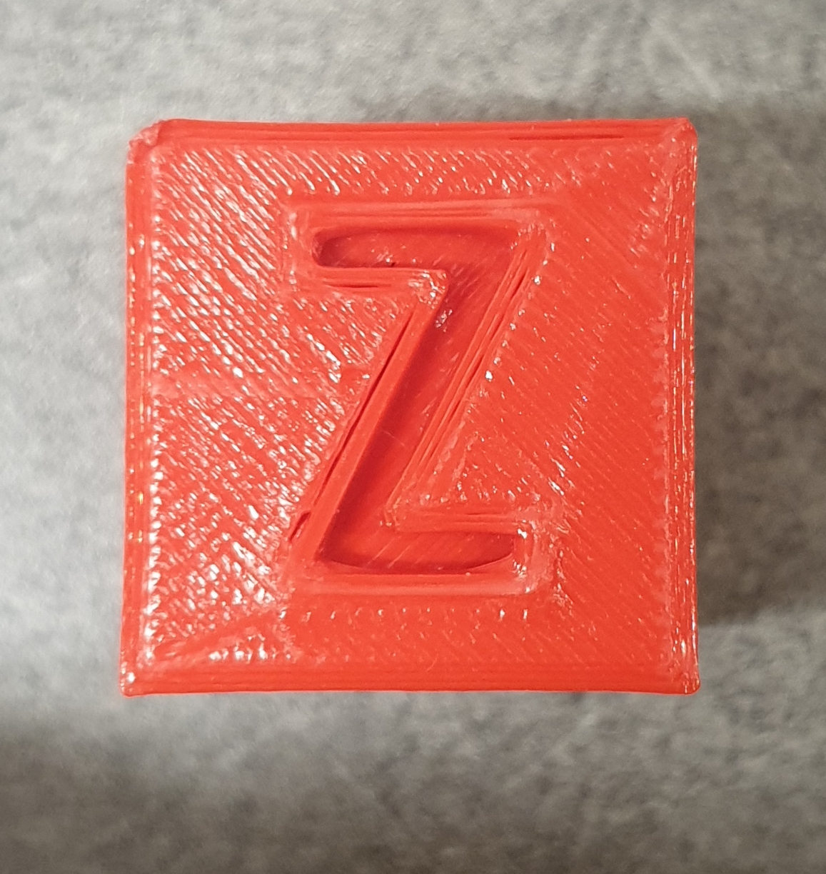

I have tested with other paramètres and that no work better :lol:

Hi, You may need to check the following points:
1. Check whether the bearing or the pulley is issued (the card can be lubricated for lubrication);
2. Check if there is looseness and tighten it properly;
3. Whether the printing speed is too fast, can be adjusted appropriately, the reference range: 30-60mm/s.
