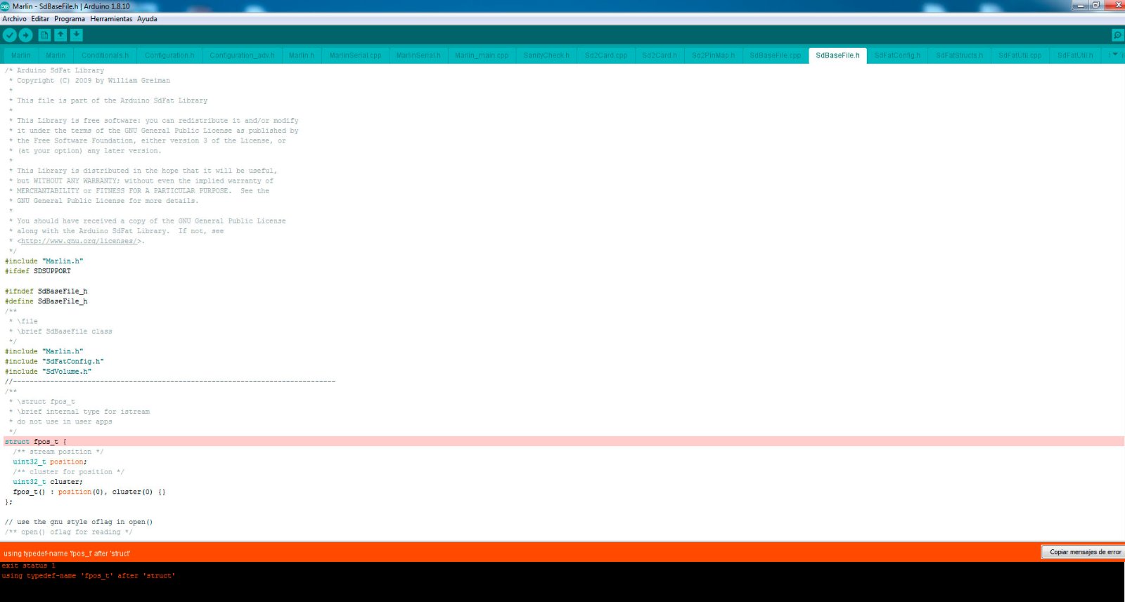

Re: Problem with firmaware Geeetech Rostock mini G2 & G2s pro
I already tested with all firmware for delta g2 & G2s and now I get this error attached screenshot.
- error arduino.jpg (115.5 KiB) Viewed 10071 times

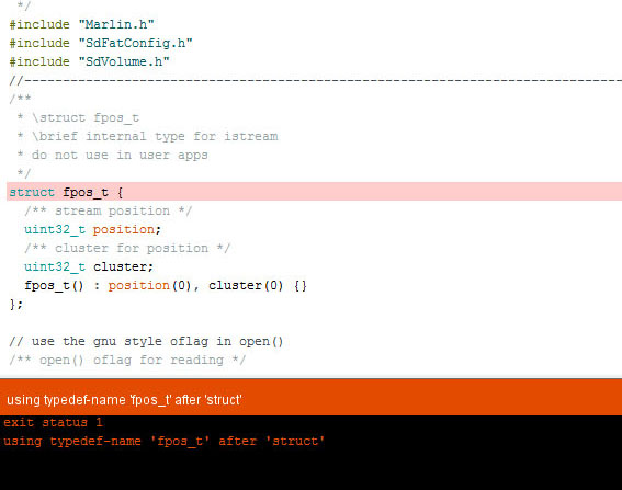

maybe the previous one doesn't look good
I put an enlarged image again
- error arduino2.jpg (63.47 KiB) Viewed 10071 times
Hi, I just did a related search. If you don't want to use the old version of Arduino, you may need to
:replace All Replace all fpos_t with f_pos_t
Note that when you replace Replace All, select "Search all Sketch Tabs"
The specific source is here: https://reprap.org/forum/read.php?146,691608
I hope this can help you.
with what you told me fix the problem, thanks
