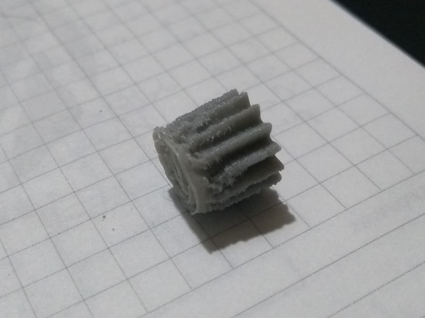

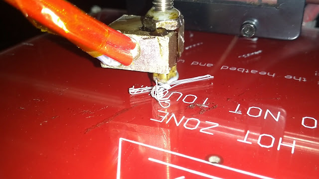

Hello, please I need your help, normally even if I calibrate the distance and the temperature, the material does not adhere to the surface and is dragged by the tip of the needle.
I no longer know what else I can do and I am becoming disillusioned with 3D printing in I3 Pro B.
Atached pictures.
Recurring begining failure

Hi, from the pictures you provided,
You need to level the hot bed,
The distance between the nozzle and the hot bed is the distance of a piece of 70gA4 paper.
and the print speed is recommended at 30-60mm/s.
I hope this can help you.

Hi Juan183,
You don't say what first layer height you've chosen.
What material ?
What nozzle temperature and bed temperature ?
Are you using anything on the glass to help first layer adhesion ? - Any glue or spray ?
Once you have made certain the bed is level...
I periodically manually check all four extreme corners are the same - About every 10 - 15 prints or so...
And I have a probe to check the level every print !
I print in PETG - I've never printed anything else on my i3 Pro B.
I have blue painter's masking tape on my printing bed - it helps the first layer stick correctly.
I always have a first layer of 0.3mm
I usually print all other layers at 0.2mm
I have the nozzle at 245 deg C for the first layer, then may drop this to 240 deg or sometimes 243 deg...
I have the bed temperature at 75deg C for the first layer, then may drop this to 70 deg for other layers...
Getting the first layer to print correctly is critical to getting a successful print - If this fails, I would abort the print and check as follows...
Check the 'Zero' height of the nozzle and re-set accordingly.
(Even though I have a BL Touch probe, this can change - especially if I've played with the filament extruder release at all.)
Check the bed is level...
Maybe time to change the blue masking tape ! - I usually get more than 10 prints off each application though.
Gerry
