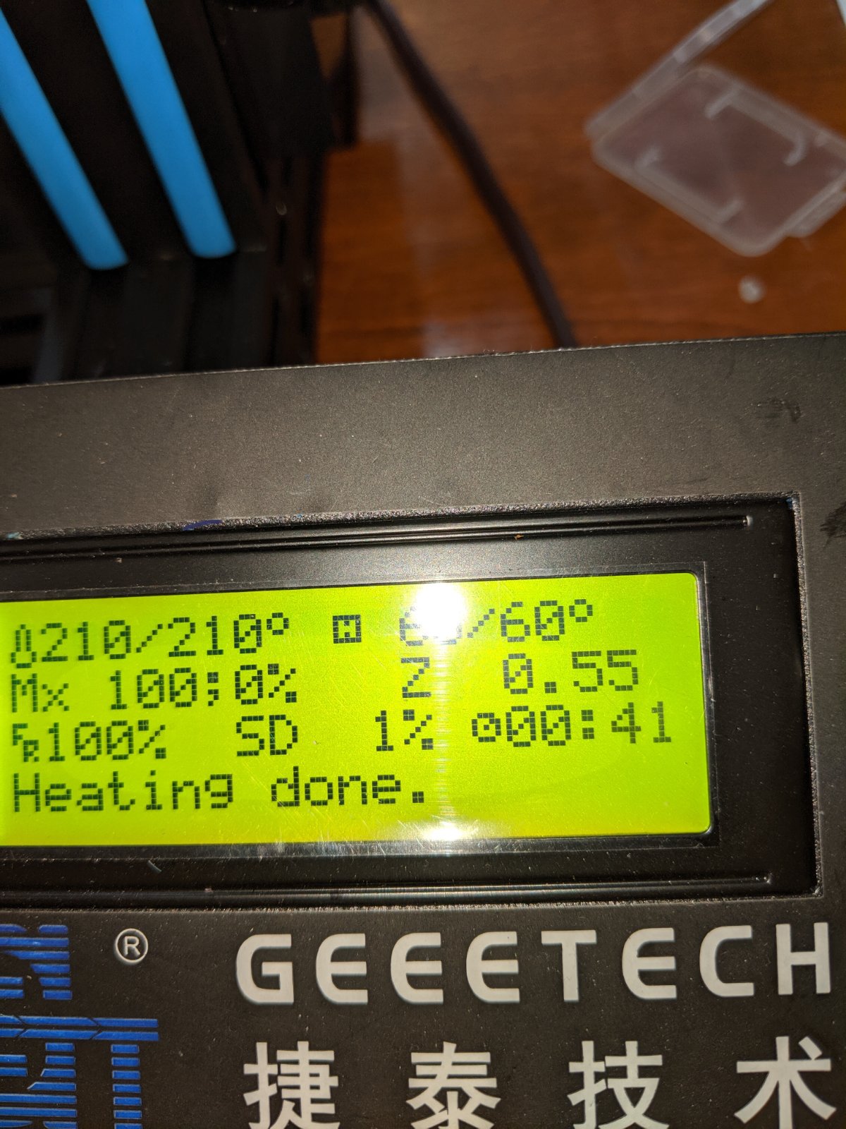

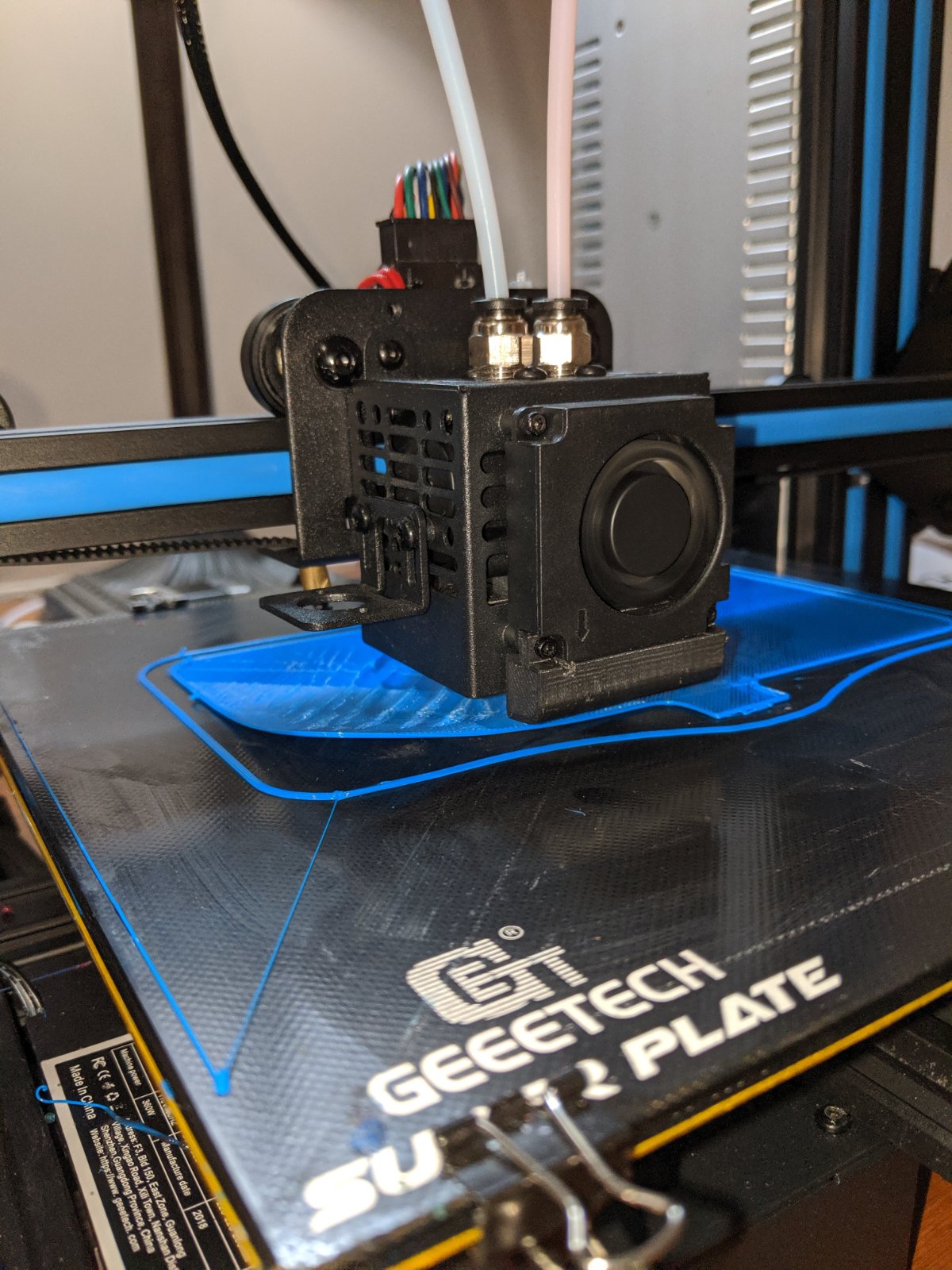

Why does the same corner on every print curl recently? Still printing with bed at 55 ?Same when I tried 60 ddeg, Only this corner of the bed. Heat or cold spit of bed? See photos of problem, material and setting

Hi,You can check if the hot bed is level,
The distance between the nozzle and the hot bed is the distance of a 70gA4 leveling paper;
If the print model is still not sticky, try applying a textured paper to the hot bed.

hotbed is dirty, it need to be cleaned. And for Superplate use for first layer hgher temp, try 70 or 80°C.
