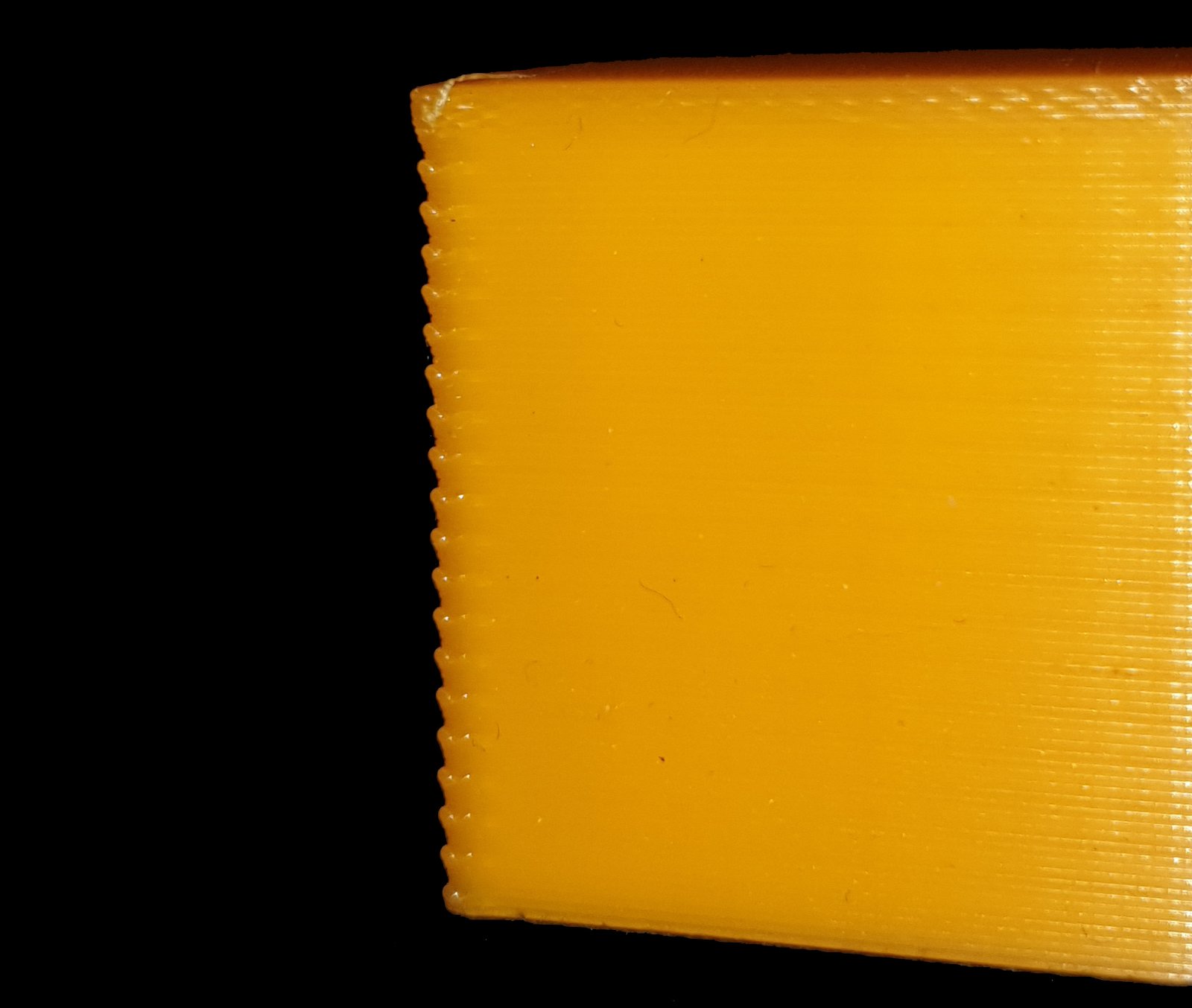

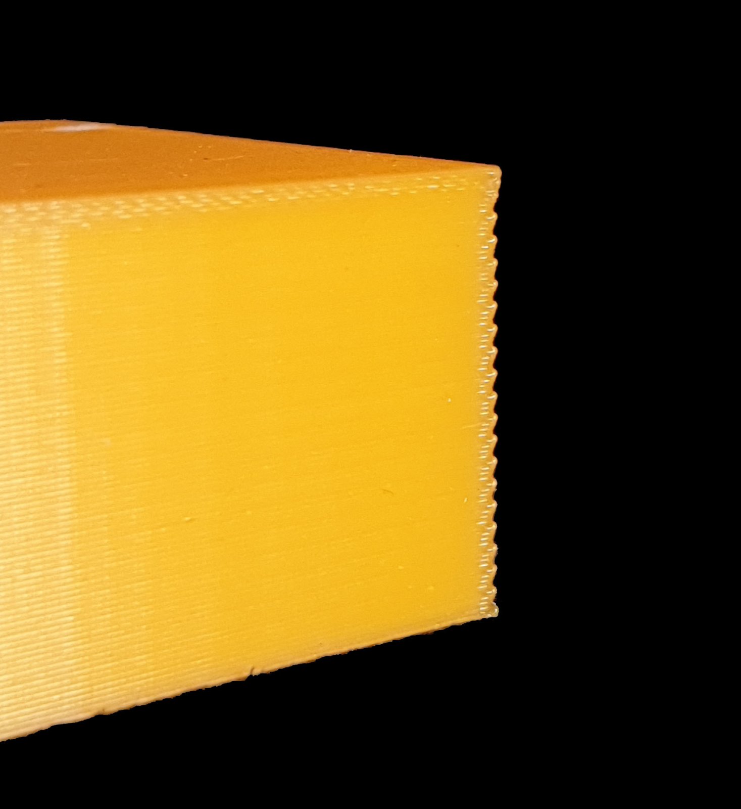

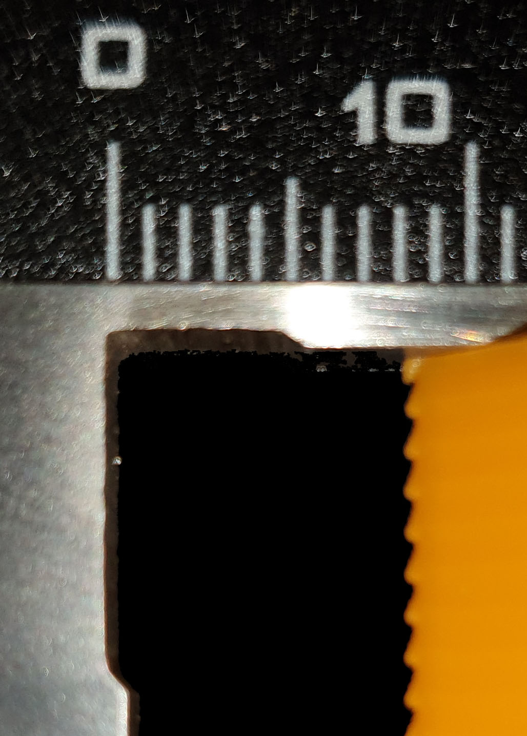

On the A20m I got non planar wall, look like mini stairs (see pictures), specialy on cube border along z axis, this is a very small default but I have not this problem with my other printer.
Those mini stairs are constant along z axis on the whole height.
Any idea ?
Any idea ?
- pictureB.jpg (136.15 KiB) Viewed 20645 times
- pictureA.jpg (138.39 KiB) Viewed 20645 times

the right side of X axis is too tight. And left side at Z screw possibly not tighten well.
Top side seems over extruded

thanks, so I should try to lose a little right X axis wheels ? I start a new print with this modification to see if it help.
The top layer is fine, probably the photo give this impression of over extrusion but it's really nice in reality.

I tight the left x axis wheel and lose the right one but unfortunatly no change
, result is the same, little stairs are still there, do you think I should try to tight it even more ? NB: they appear in all the fourth borders along z axis.

NB: with layer of 0.1mm all print are ok, with or without infill, at least my vision is not enought accurate to see them...
It is a very small defect, less than half a millimeter, that appear with layers of 0.3mm height, nearly invisible with lower layers height.
