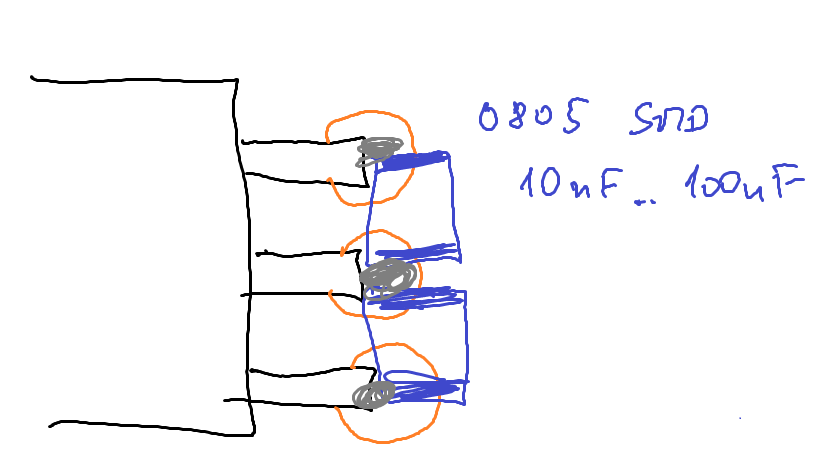

This is on my I3 Pro C with a GT2560 A+ board and LCD2004
It seems to need a variable number of rotation "clicks" to move the pointer on the menu - sometimes 3 or 4, sometime 1.
It also goes the wrong way to my way of thinking - I have to rotate it clockwise to move down and anticlockwise to move up.
Interestingly when on a number field it seems OK.
Any suggestions welcome,

Add two 10nF to 100nF capacitors between the three legs of the encoder.
