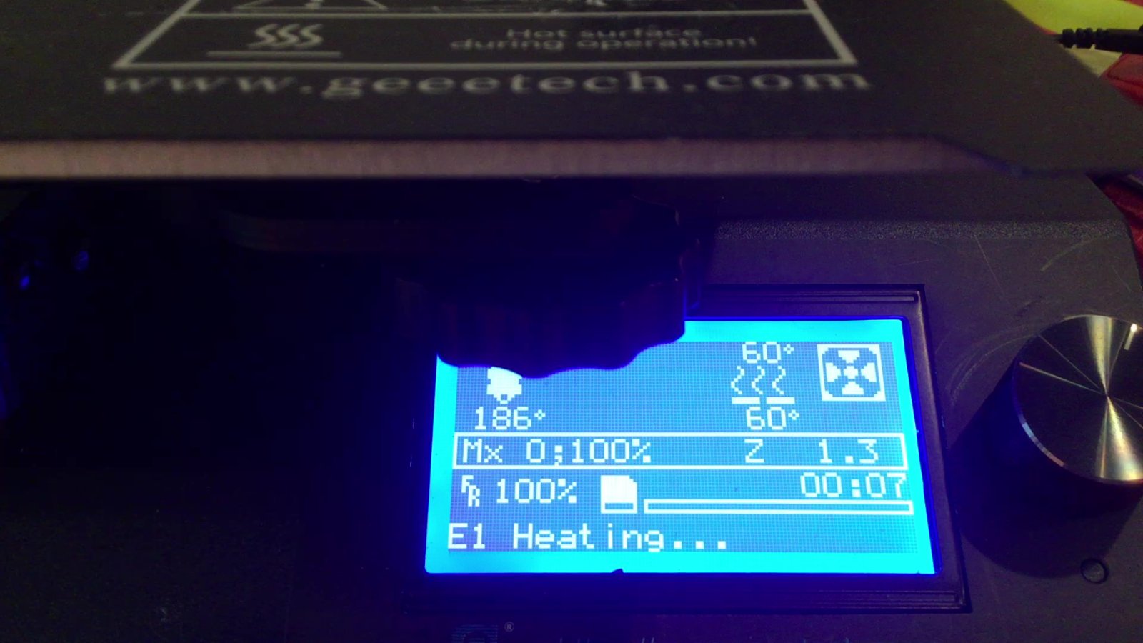

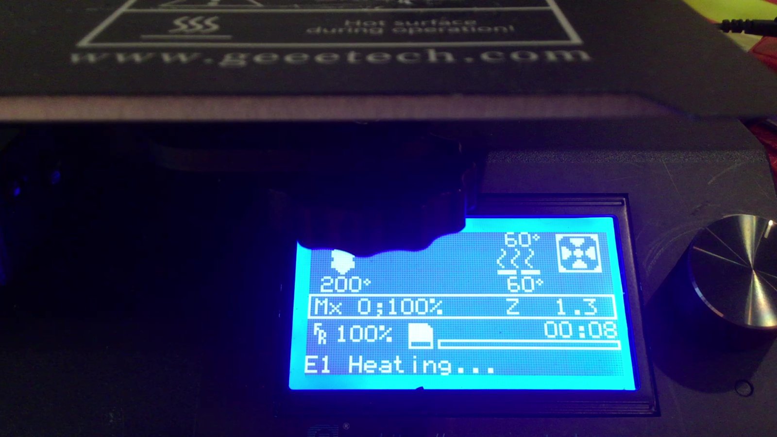

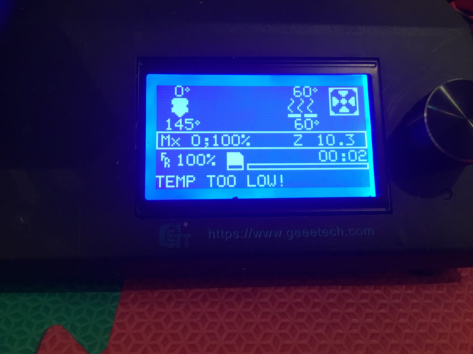

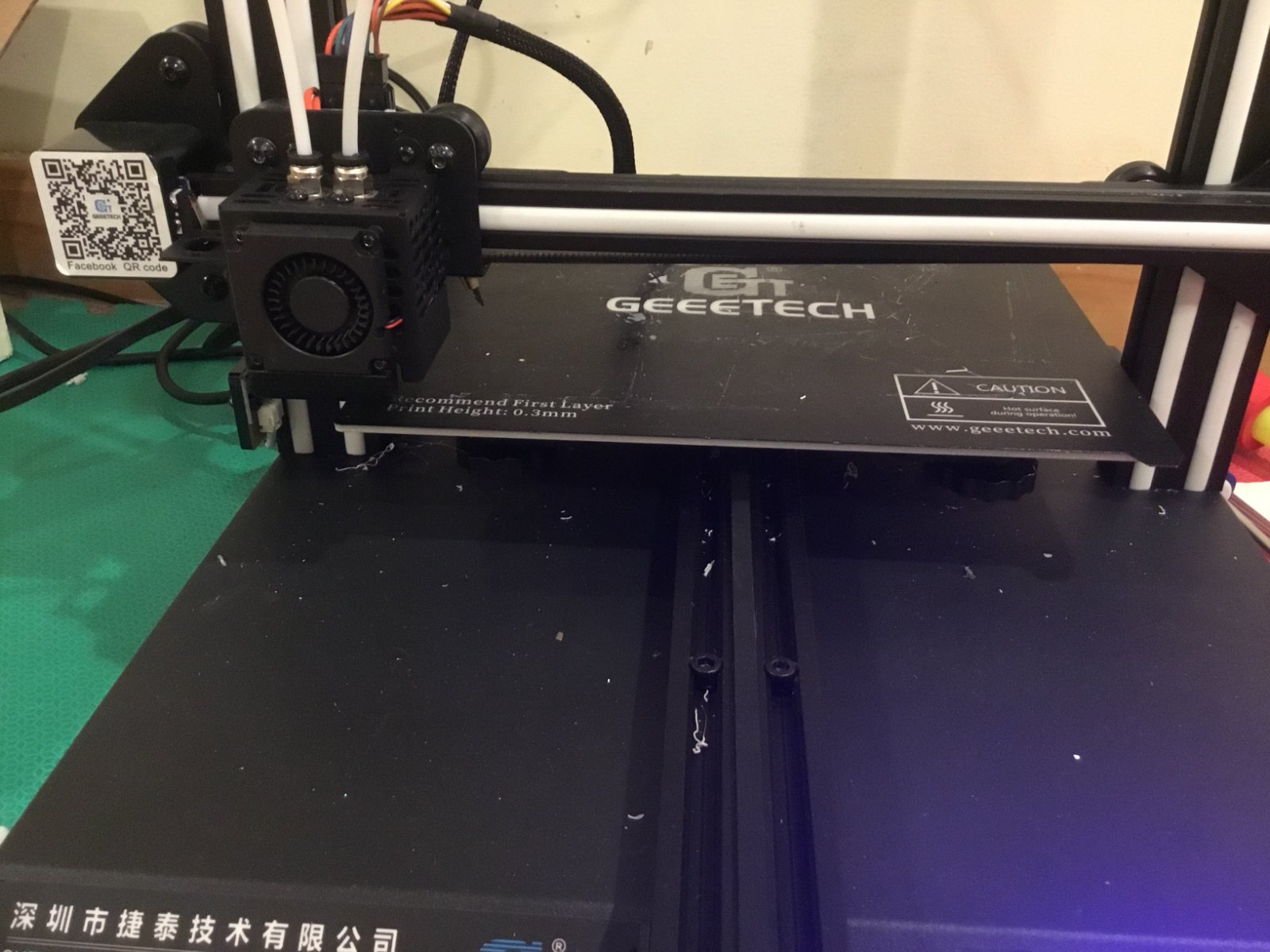

I have sent an email to the help service which still hasn't replied. I have an a20m printer and whenever I start the print it heats up properly, however, then goes to center, goes back to auto home and displays "TEMP TOO LOW". Therefore, I can't even start the 3d print.
Also, I have PVA as a support material and it never prints for some reason/does not extrude.

As a software I use Cura

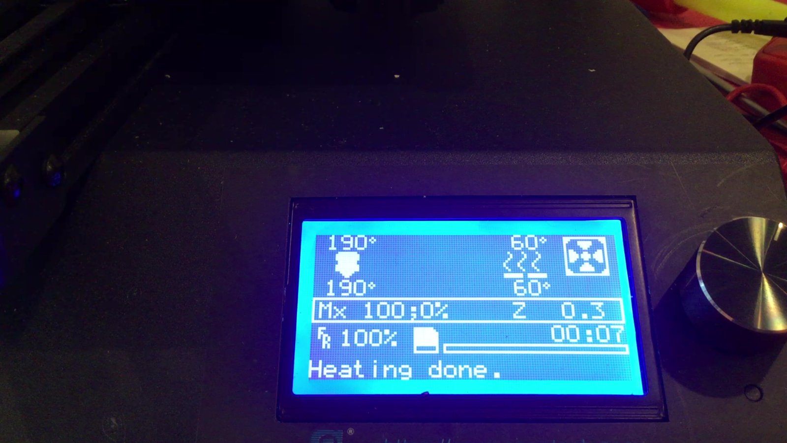

It heats up fine. Both plate and extruder heat up.
But then when it starts the E1 requirement drops to 0 and then it stops and displays TEMP TOO LOW.

There is a really good youtube video by 1zRadio that explains this issue and how to resolve it
https://www.youtube.com/watch?v=N9x9de4nYI8
essentially it is an issue with the way CURA deals with multi extruders. It tries to be clever and switch the temperature down on the first extruder when using the second. As a result the temp of the (one) nozzle cools and the printer cuts out.
It can be resolved in 2 ways;
1 - set all the temps including the standby temps to the same extrusion temperature
2 - follow the guidance in the youtube video and all a post processing script to remove the code that turns off extruder 1
