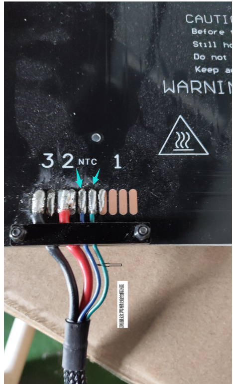

:D Hi, regarding the temperature of the hot bed you are referring to,
You can try to unplug the hot bed line from the motherboard and check the temperature display.
If the high temperature is displayed, there may be problems with the motherboard that need to be replaced.
If the temperature is -14°, you need to measure the thermistor of the hot bed.
I hope this can help you.

Hi, If you mean that the temperature of the hotbed rises automatically,
I still recommend that you unplug the hotbed line to see how much the temperature is displayed and
determine if there is a problem with the motherboard.
If the temperature does not rise, you need to measure the thermistor of the hotbed.

Re: A30 Continuing Problems
Hi, you can use a multimeter to measure the position of the blue-green line.
