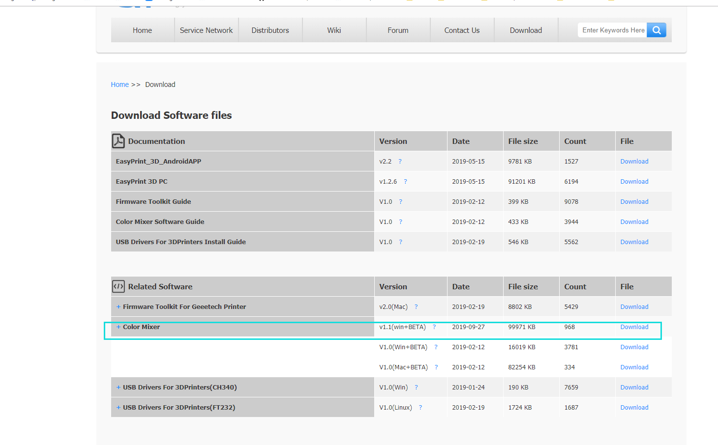

Hi, You can try color mixing with Color Mix,
Download here: https://www.geeetech.com/download.html?download_id=40
Choose this:
You can refer to this: viewtopic.php?f=92&t=69600
