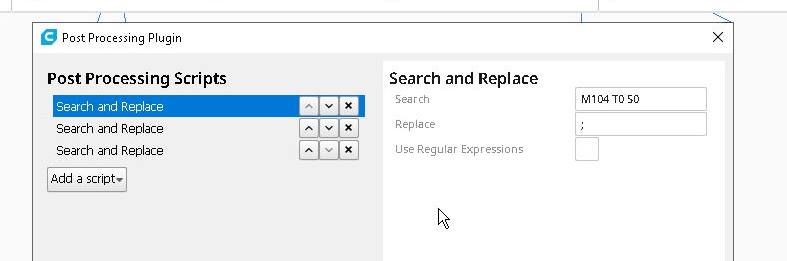

Hi..
I am having a strange issue with geeetech a20t.
Is there any 3 color g code printable test for this printer (small quick printable item would be best) NOT A COLOR MIX OR BLENDING..
A 3 SOLID COLOR ITEM post sliced for this printer..
My ISSUE Is explained here
viewtopic.php?p=104417#p104417
I am kinda at the end of my Testing and assuming there is a firmware flaw in this printer that i am apparently the only one in the Universe owns
I found a fix for this issue...Someone from another forum the issue is the g-code is telling the machine to turn off the heaters to early..

Are you using Cura/ S3D/ MeshMixer for your slicer? I've noticed that most of the slicer programs try to start cooling down the extruder too fast when you get to 98% of the prints completion. In Cura this setting is found under Material>Final Print Temperature and making that the same as my "Printing Temperature" I'll never understand screwing up a print in the last few layers for the sake of cooling the print head quicker.
I can send you the gcode file for a 3 color model if needed. Just let me know.

I've got an A20T and using Cura 4.4.1. I was having the same issue, and the post processing fixed it for me. Thanks ericarenee for that help!
