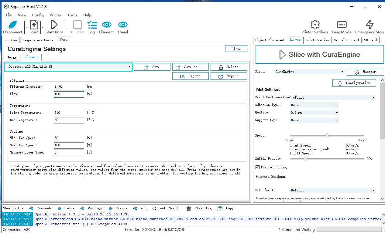

:D Hi,Guys
something about how to import .rcf .rcp configuration in Repetier Host

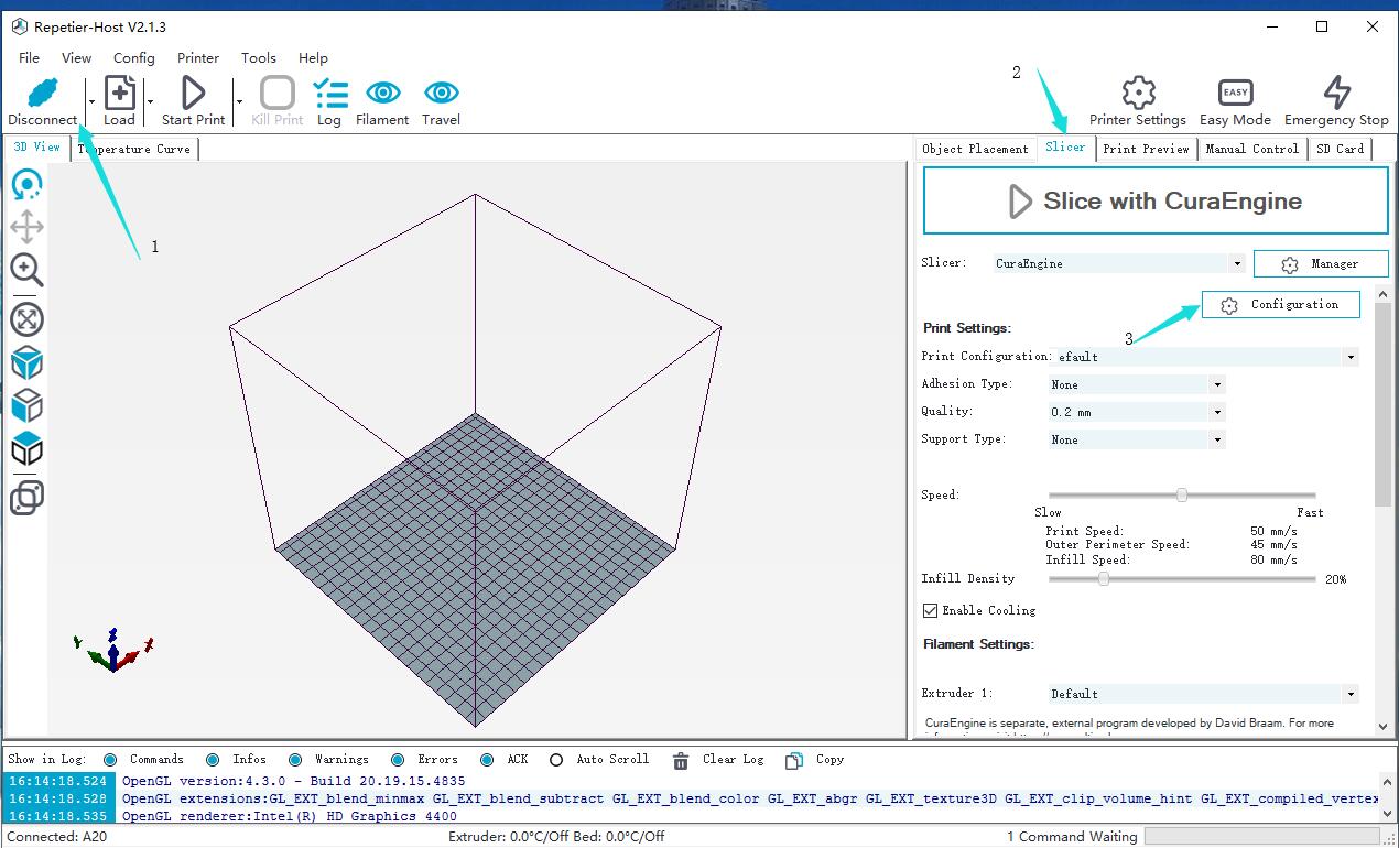

I take A20 as an example

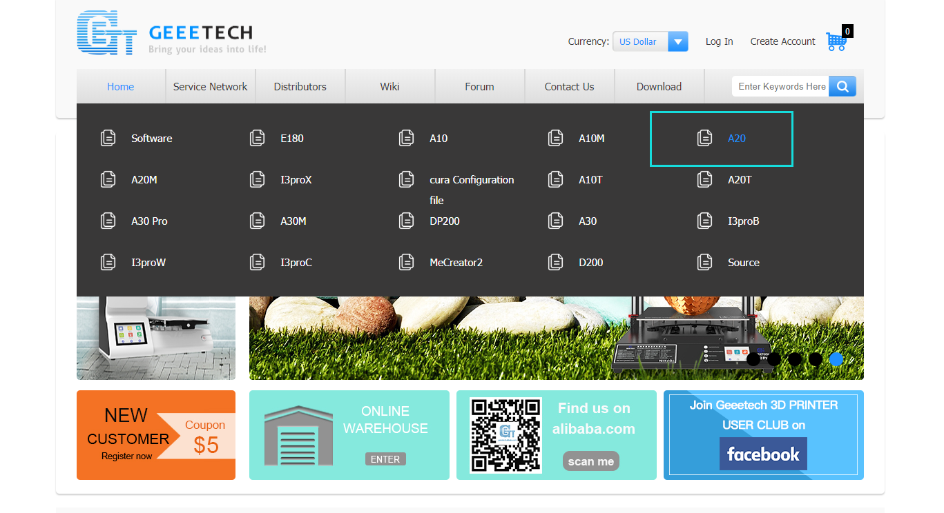

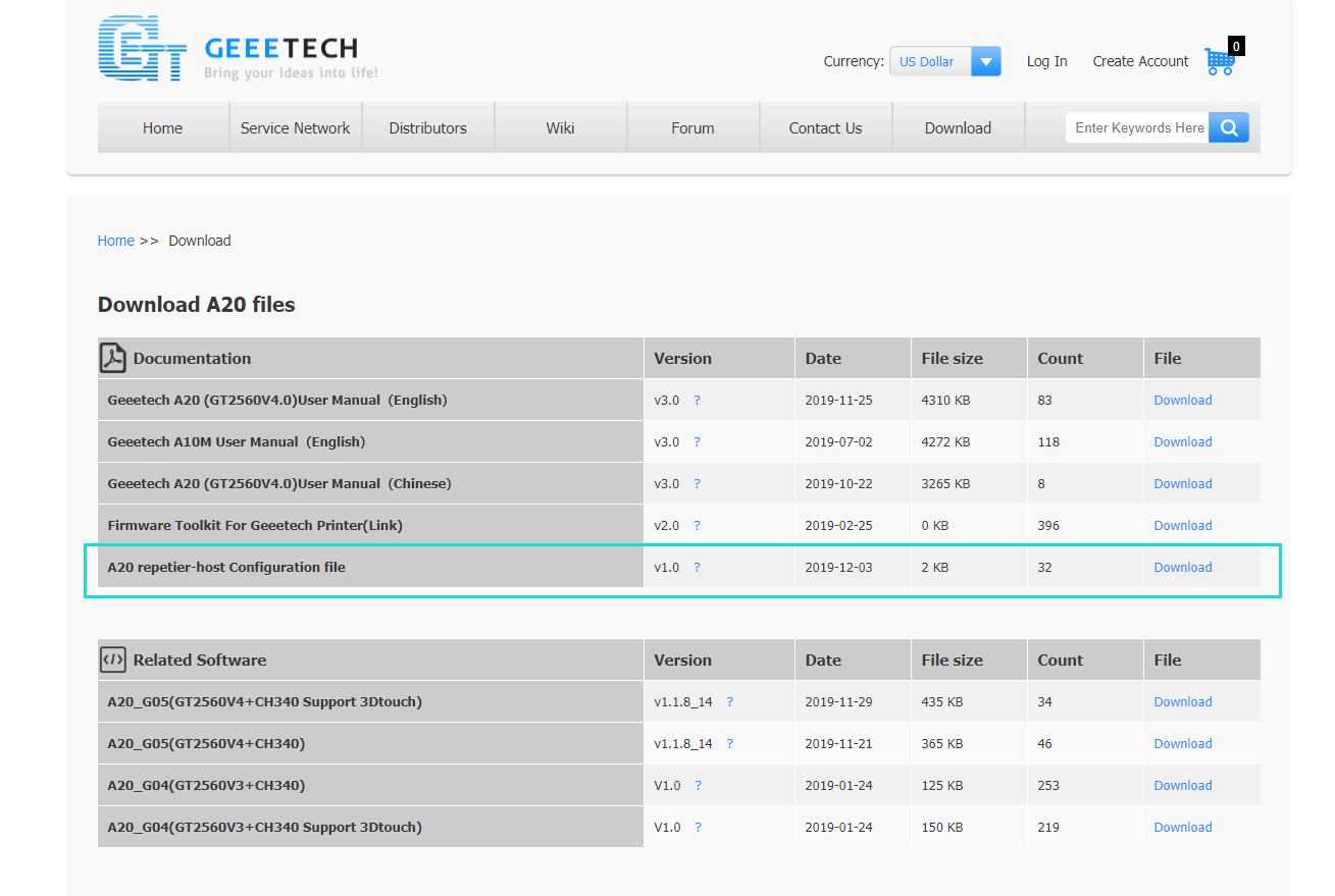

1.First you need to download the configuration of the corresponding model of Repetier Host on the official website.
the link: https://www.geeetech.com/
2.Decompress the compressed package, and the configuration of .rcf .rcp appears.

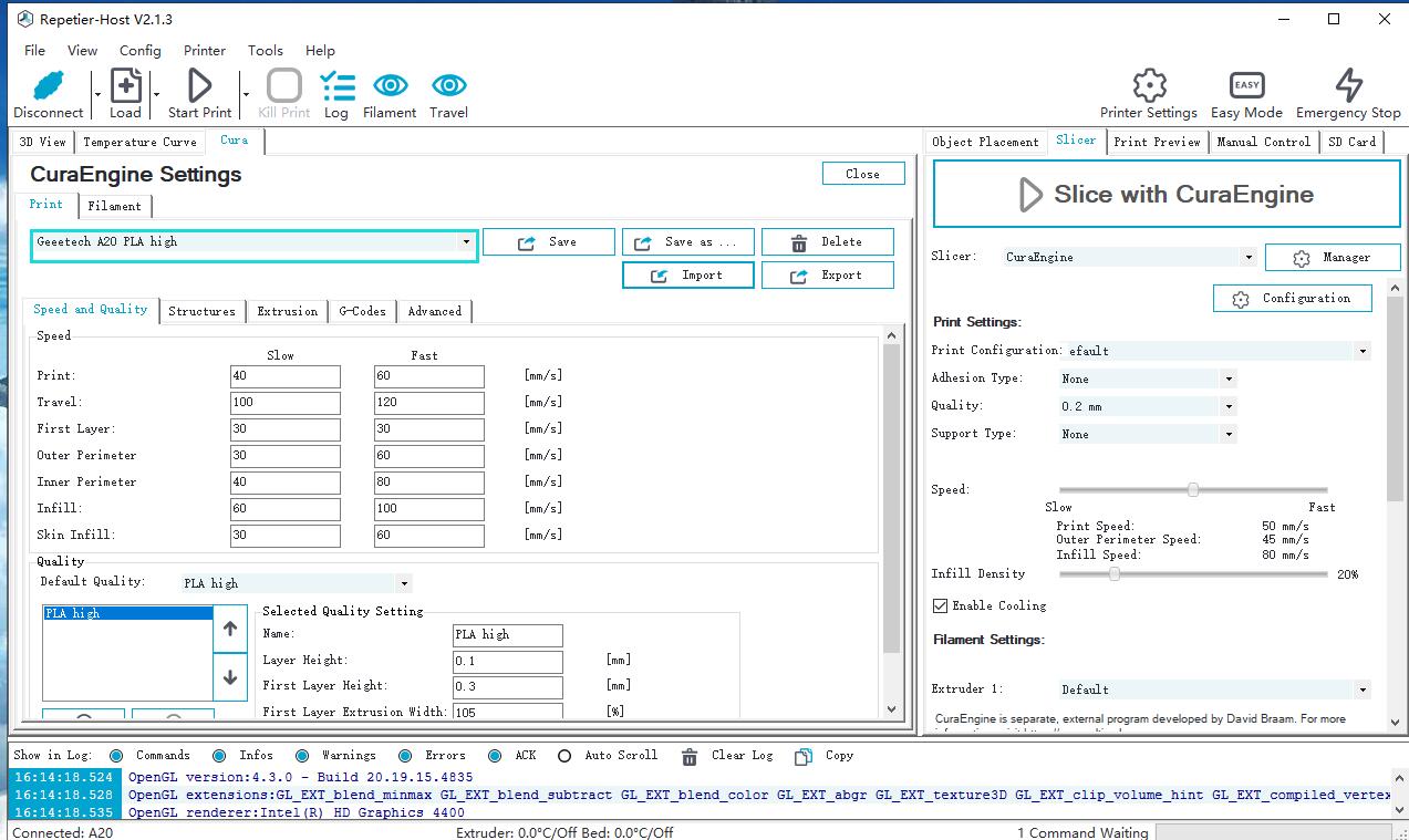

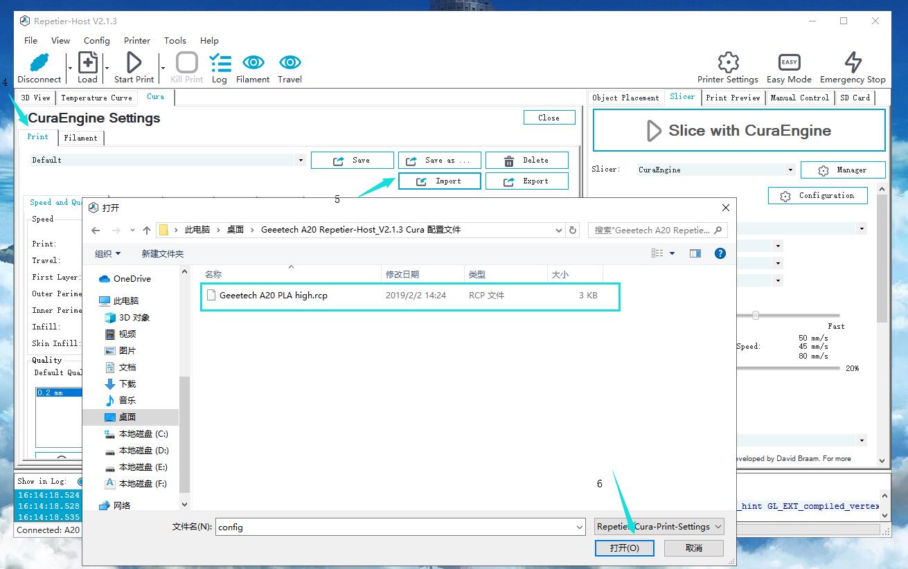

3.choose slicer- configuration -print-import

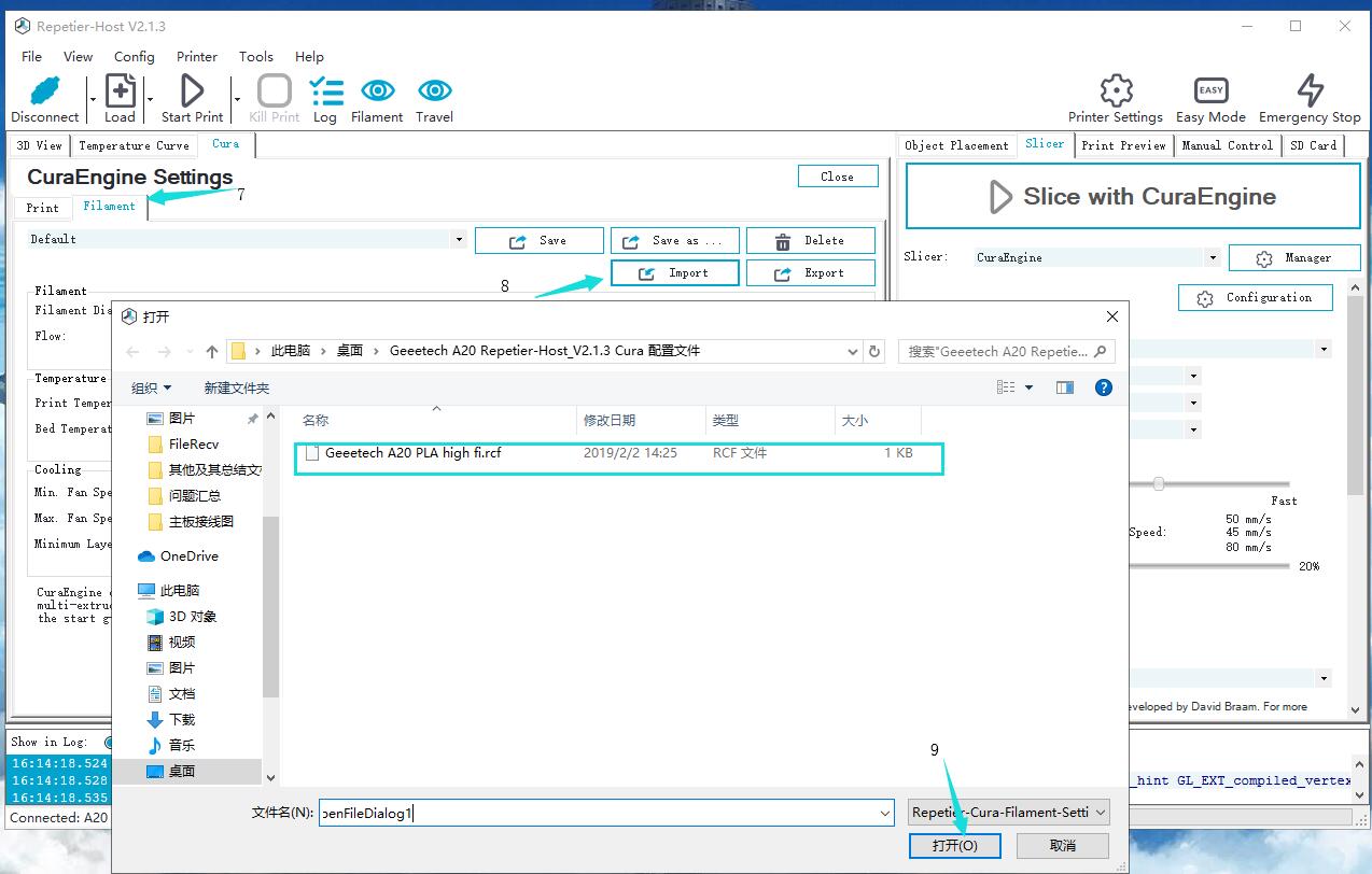

4.choose Filament -import
5.Done
