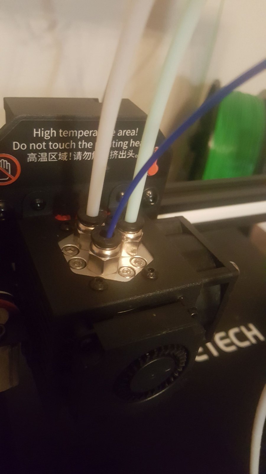

Re: Cannot push one color through the hot end
There is really nothing to show on video.
Picture: The hotend is heated to 250 degrees. I insert filament into the input of the hot end -- I push on the filament. It will not go in.
I have attached a photo. The blue filament cannot be pushed into the input in front. I have removed the bowden tube just to demonstrate for the picture.
For the other 2 inputs, filament can be pushed in and extruded out the nozzle. This one input is somehow blocked internally.
You may need to replace the hot end.
