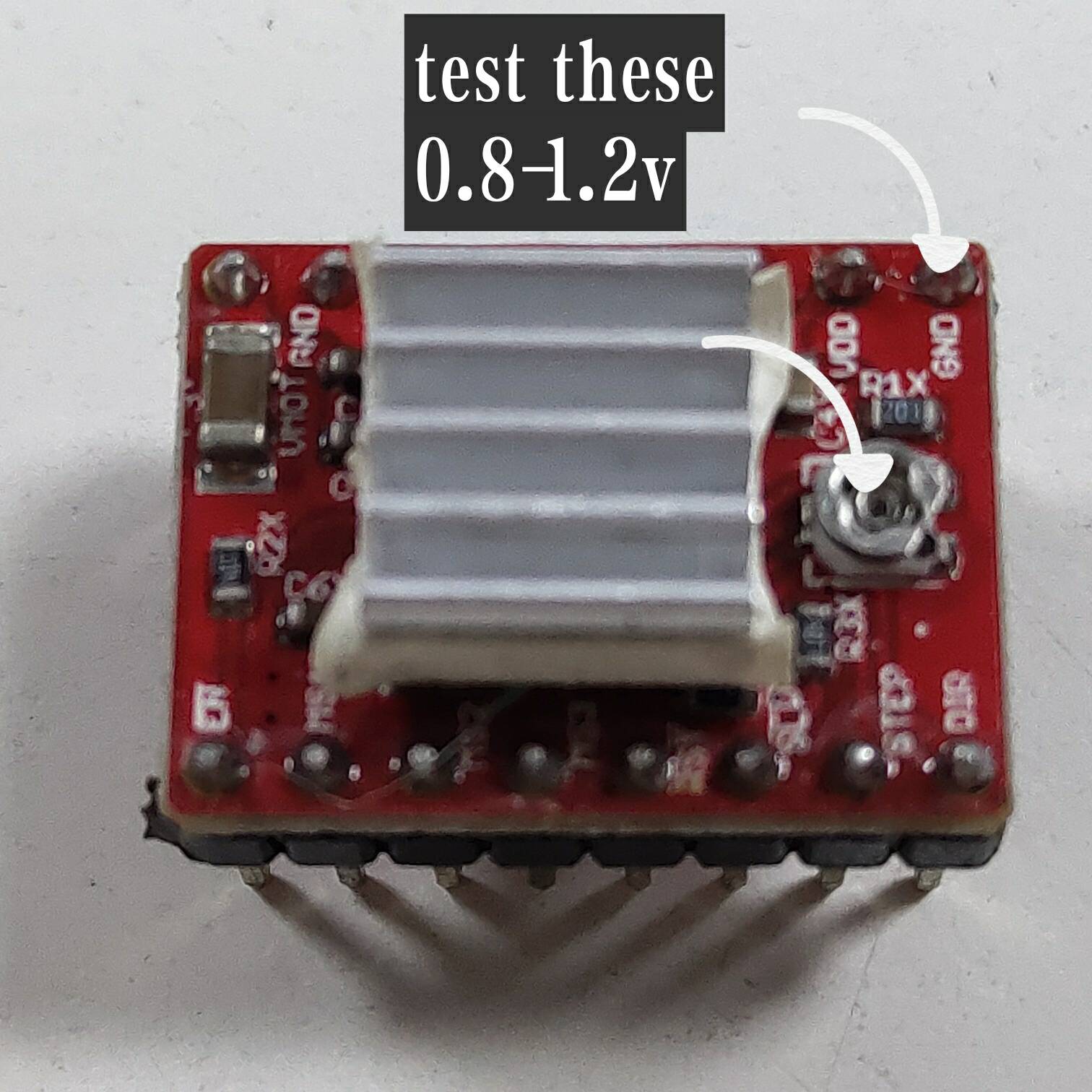

:D Hi, Is your driver board red A4988?
It does n’t have a mute function.

@William,
I'm not sure to understand the question. Do you mean the motherboard ?
In case of here a photo of the driver back:
Re: 'Singing' (and noisy) extruder
Hi,the A4988 is :
A4988 测量位置.jpg (192.77 KiB) Viewed 10560 times
