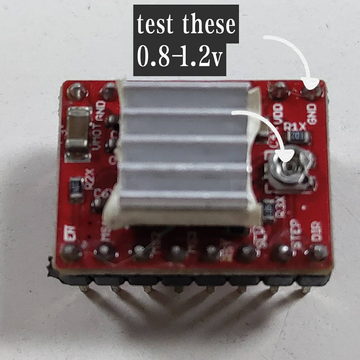

@Jarda3D, I'll give a shot to untigh a bit the screw on the frame althought I don't see why this one would be noisy and not the two others (unless it is unfunctional).
@William,
I'm not sure to understand the question. Do you mean the motherboard ?
In case of here a photo of the driver back:
Re: 'Singing' (and noisy) extruder
Posted: Wed Jan 08, 2020 9:05 am
by William
Hi,the A4988 is :
A4988 测量位置.jpg (192.77 KiB) Viewed 10567 times
