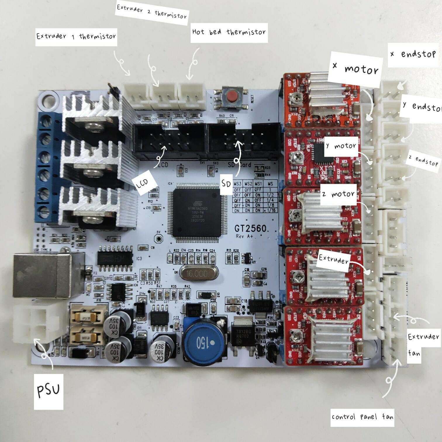

Re: My printer will not heat up and the motors do not move.
:D Hi, You can check the wiring on the motherboard:
