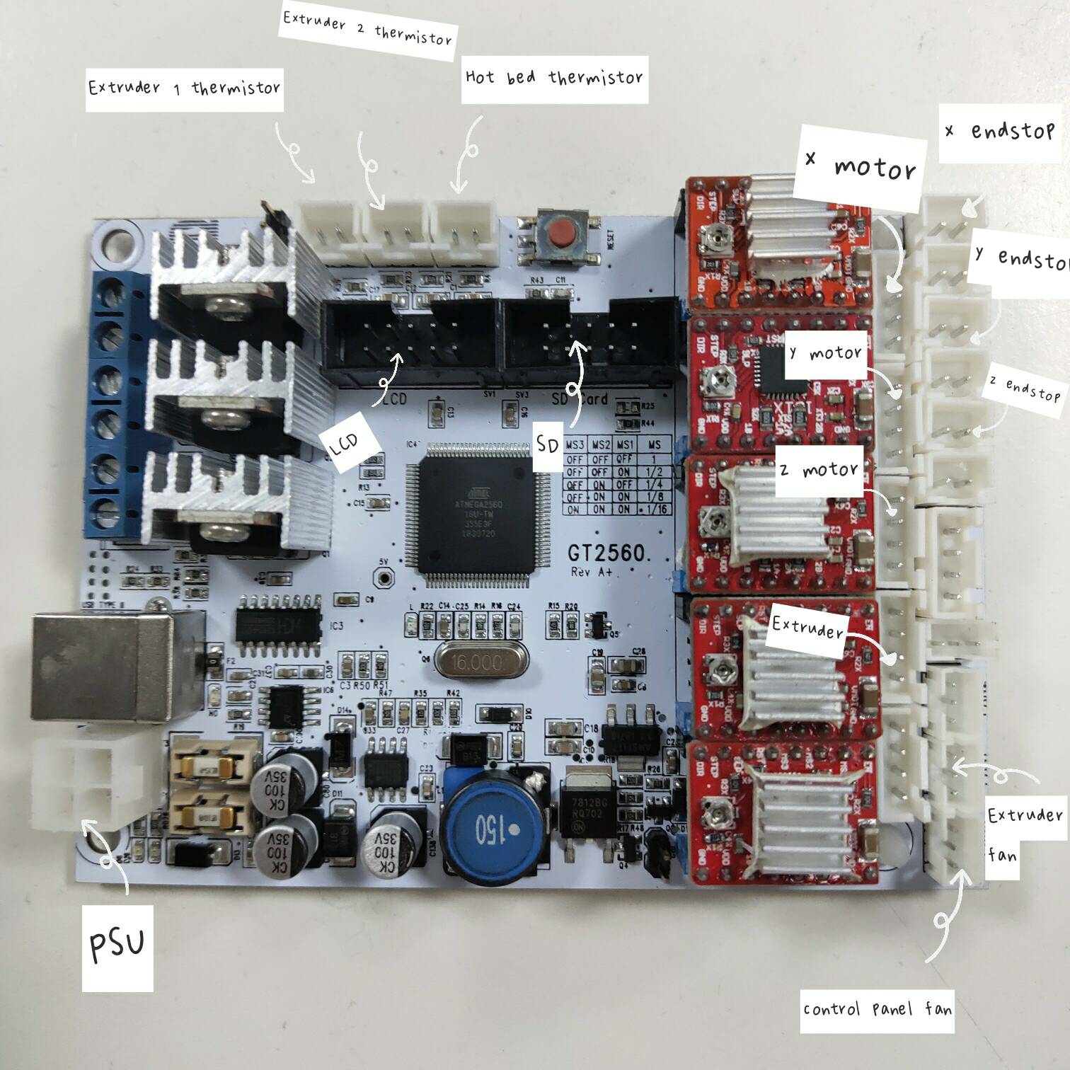

whether the installation position of the x-axis drive board corresponds to the position of the x-axis motor;
2. You can connect the printer via USB, enter M119 in the manual control mode, and check the limit switch.
Specific operations can refer to: http://geeetech.com/forum/viewtopic.php?f=17&t=60927
3. If the extruder motor cannot run normally,
you can exchange the normally running motor line with the extruder motor line
(do not exchange the position on the motherboard) to see if the motor line is damaged.
I hope this can help you.

Hi,You can try to replace the normal motor cable and other motor cable ports on the motherboard. If the exchange does not work, the motor ports on the motherboard may have problems.

I've plugged the x axis motor into the z axis and when i do that the x axis moves!! So yes I think its a problem with the board! I re-uploaded the firmware to it to see if this had any effect but it did not. I still cannot get the z axis (up and down motion) to work though, the motors just 'vibrate' both threaded shafts without turning them.

Hi guys sorry it's been so long since my last reply, this is starting to get me down as this was my Christmas present. I have checked both threaded rods and they are both perfectly straight, the z axes will move by hand without any tight spots ect, but motors are still 'vibrating' without turning. I will remove the couplings and make sure the motors turn without a load applied to them.
Now the X axes, I can manually move it side to side by hand without any tight spots BUT my main thinking with it being a electrical fault is if I plug the X axes into the Y axes spot the X axes will move side to side without any issues. Obviously in this setup the Y axes is plugged into the X axes spot and the Y axes will not move at all. No matter what I do I cannot get the X socket on the board to produce any output at all.
Again really sorry for the long reply, thanks in advance
