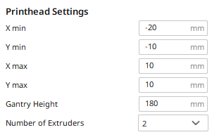

:D Hi, You can view your print range settings
Set the maximum and minimum ranges,
Set the print range to the center of the print.
The printed model should not exceed the print range.

Sorry. I'm not sure I follow what you mean.
Are these the settings you are referring to?
Re: Printing not centered on Y-axis
:D Hi, You need to adjust the print range of x max ymax,
Select to print in the center.
