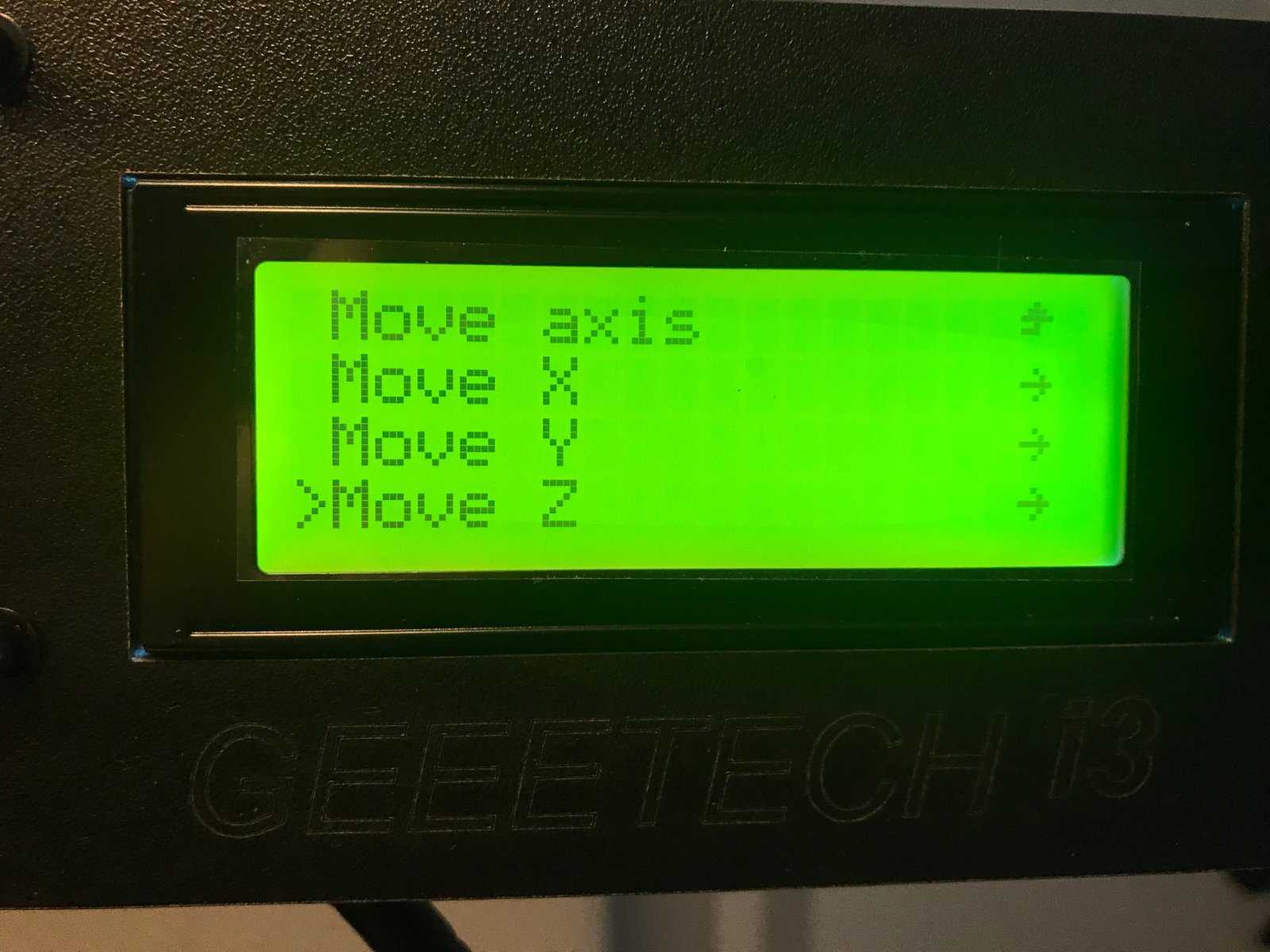

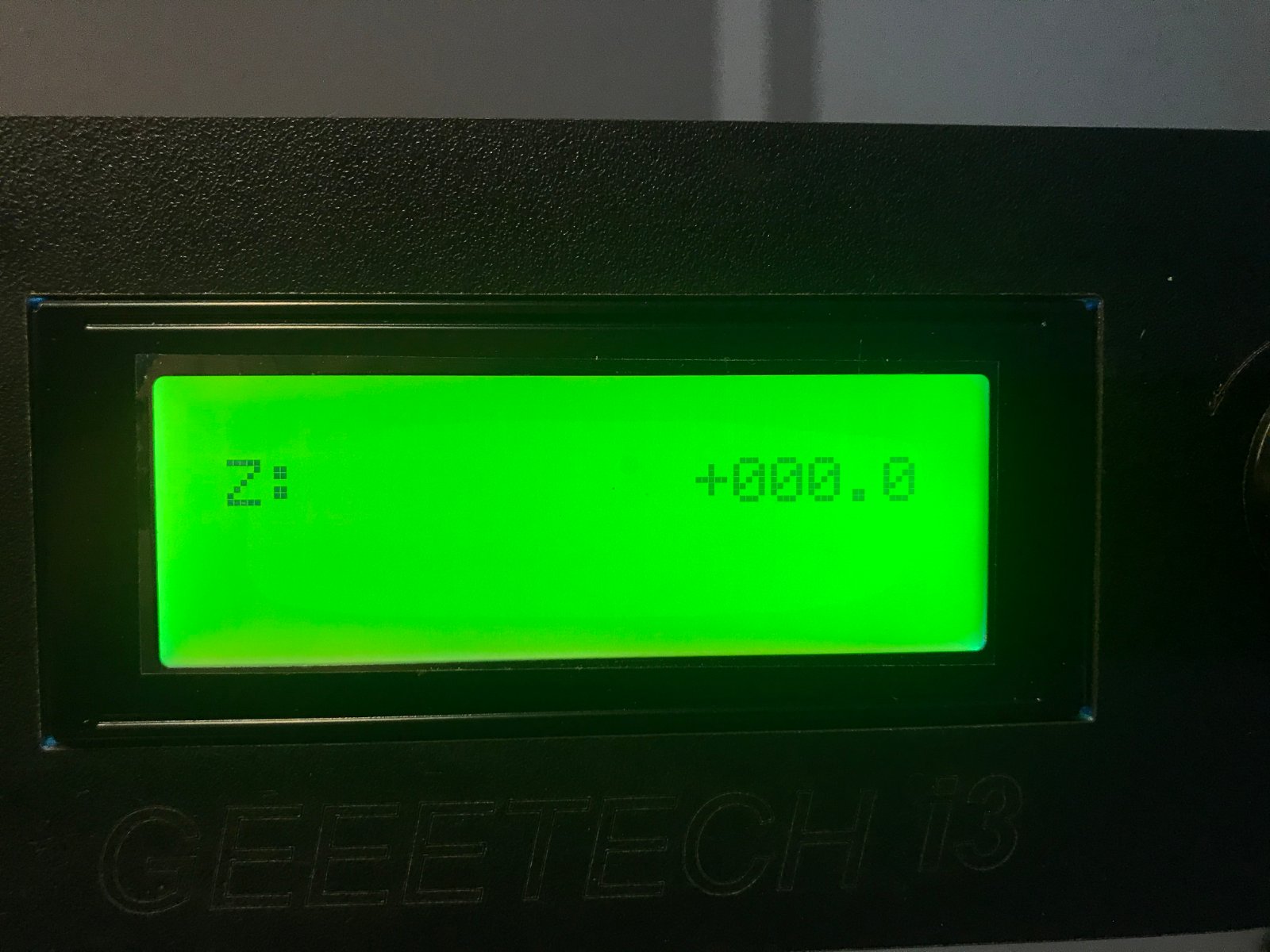

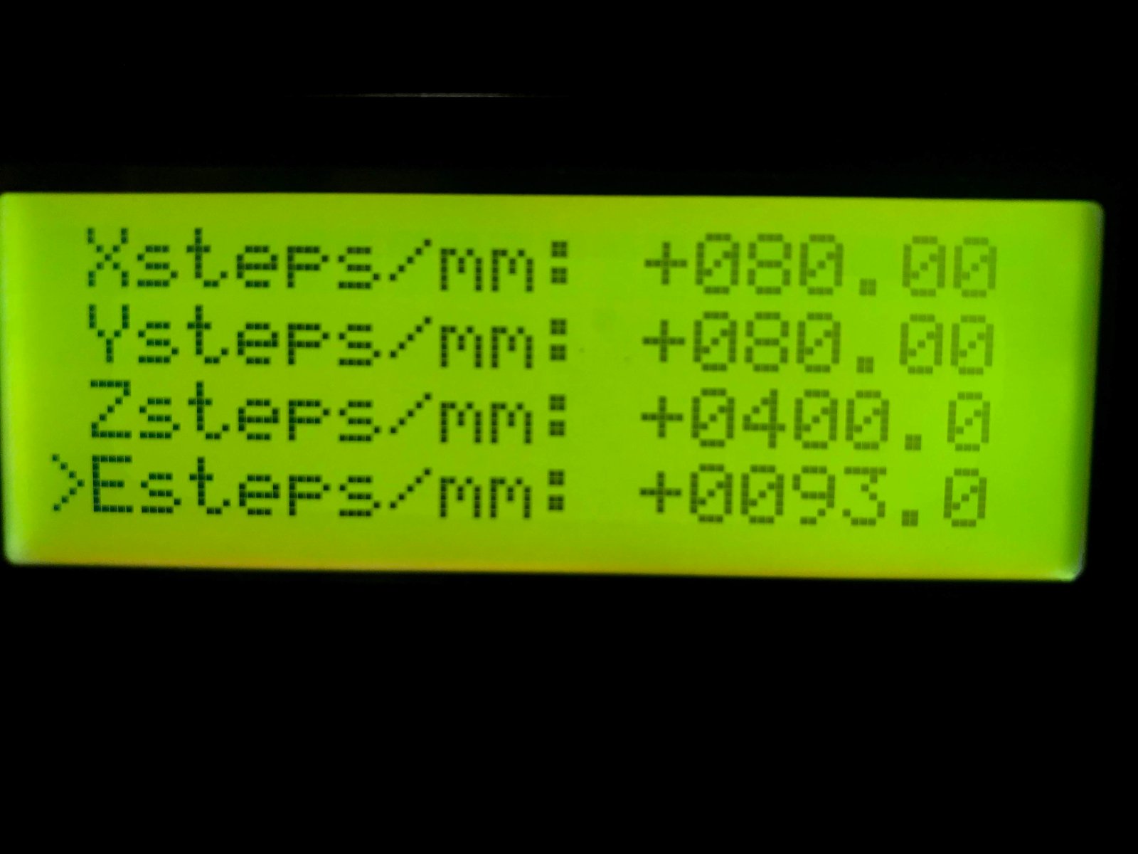

now i have opened the link b for the adjustment of the Z axis, for me the lead screw is installed only i am unsure where i change the settings.
Re: I need help setting up my I3 Pro W.
:D Hi,you can choose control- motion-steps-z steps
to see

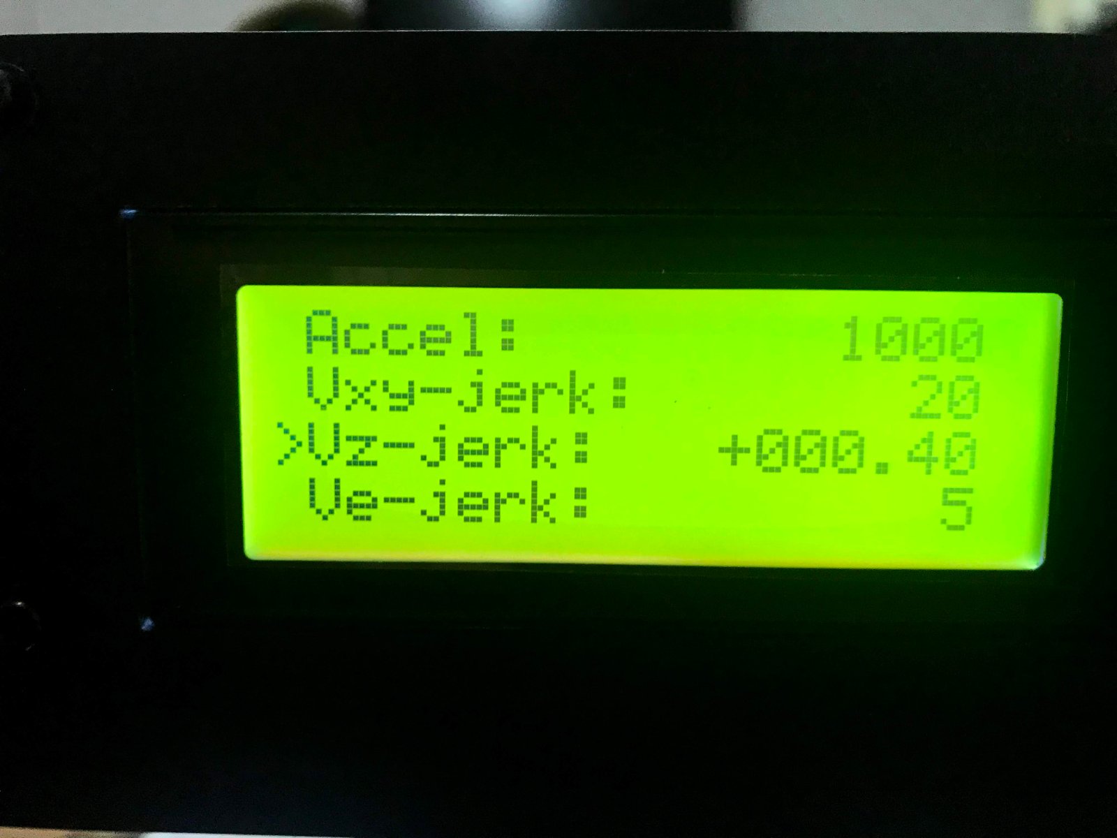

Hello Everybody,
OK, I checked that!
Can you take a look at that please. I suspect that your mistakes are still Hidden.

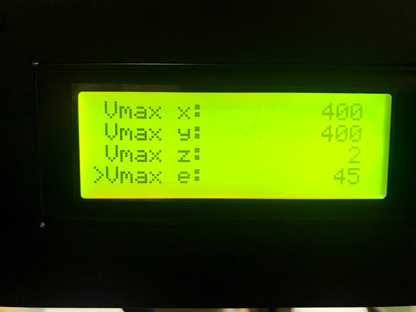

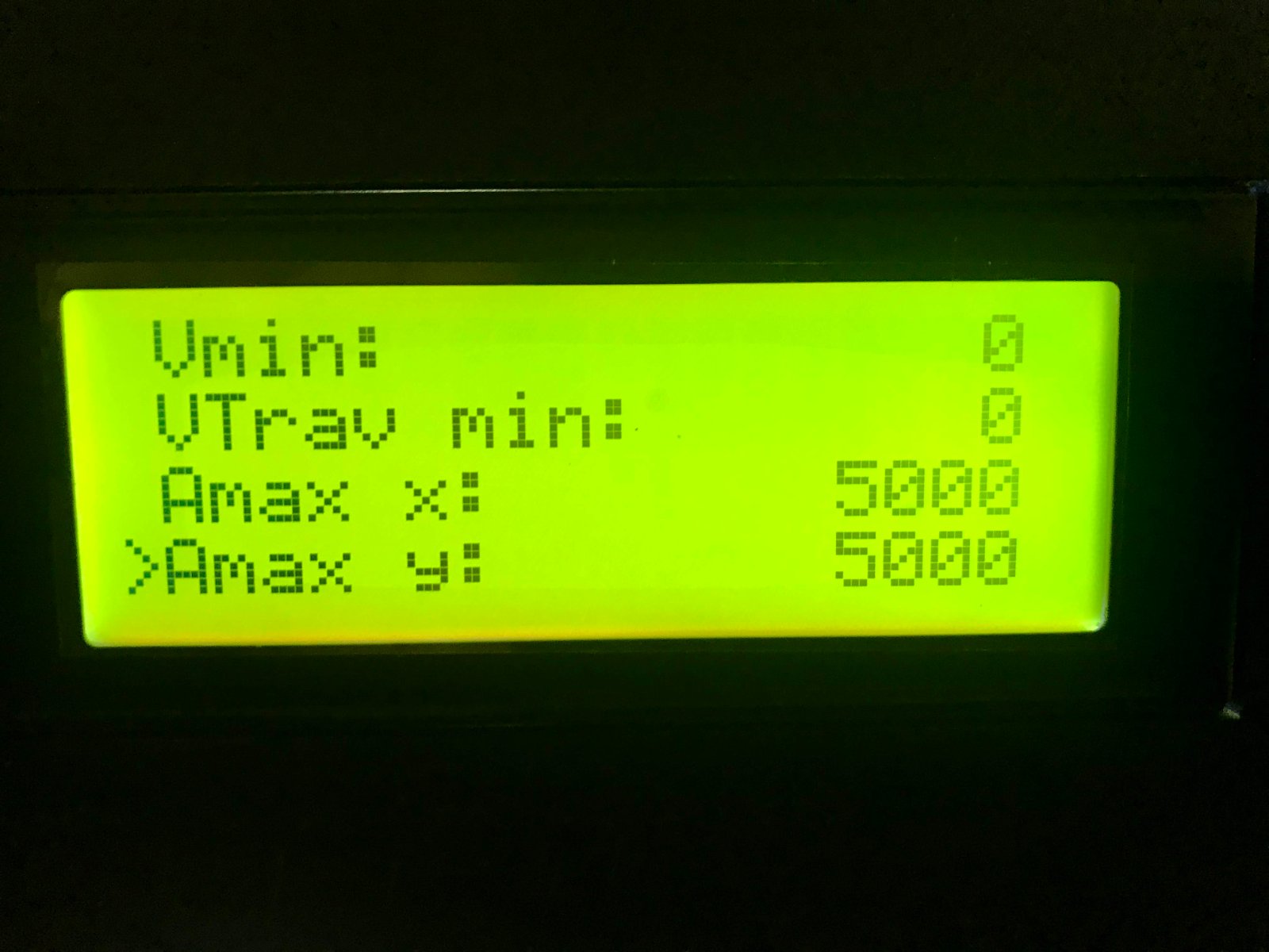

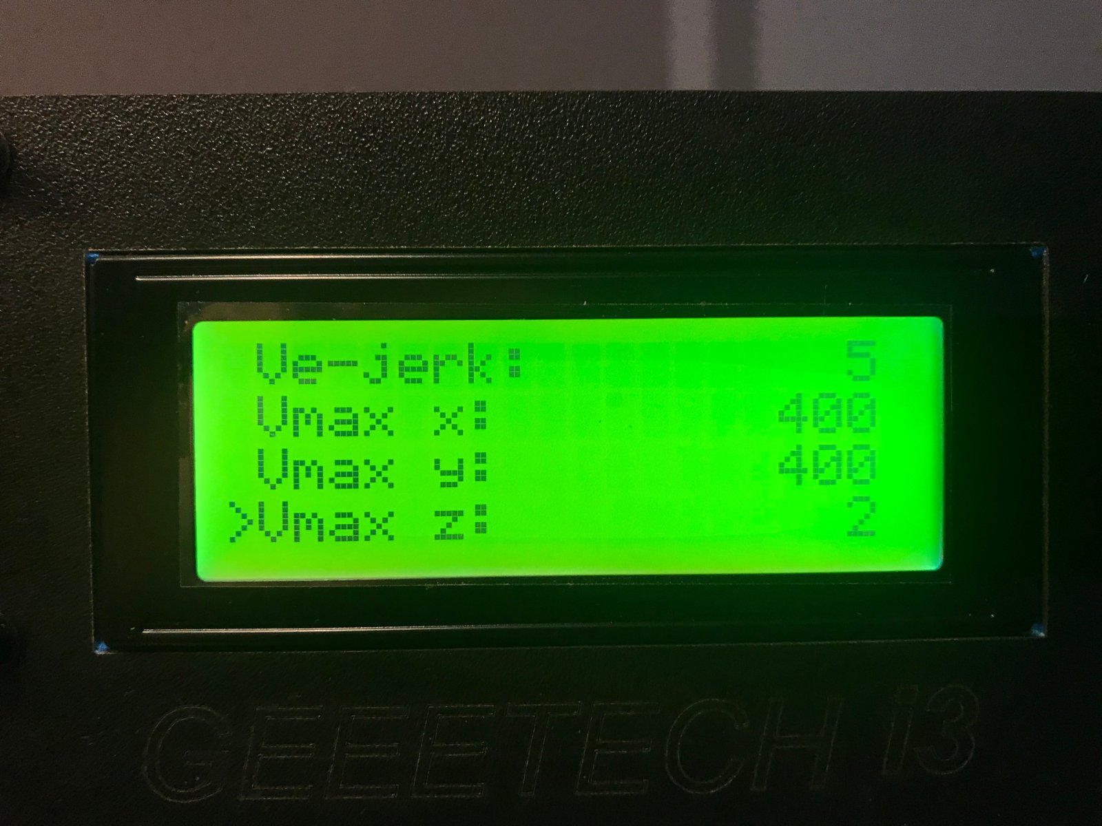

Hello Everybody,
maybe that's still important, yesterday I played the Software Marlin Recommended by Geeetech! I just Started a test Print, unfortunately nothing happened changed.
!!!The Error was important before the software was installed!!!
Here are three more Pictures.

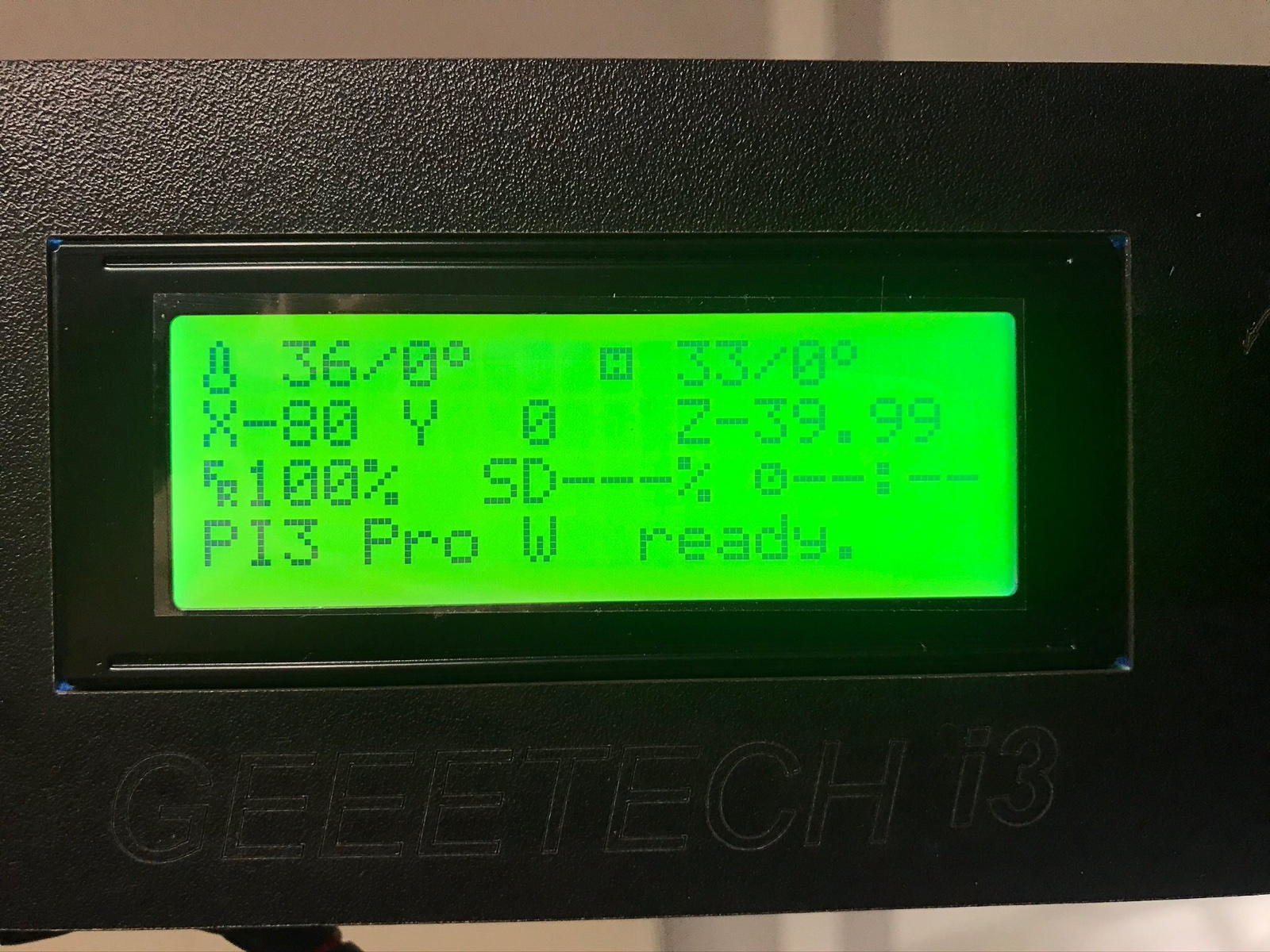

Hello, Everybody,

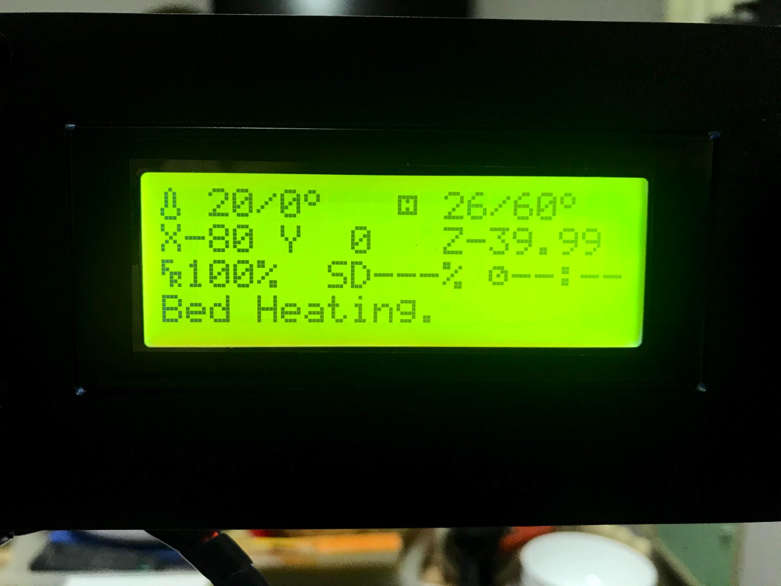

I have checked some more settings and noticed that x -80 and z -39.99 is in the home setting.
The Home setting should be X=0, Y=0, Z=0 ? Or is that wrong?
If I want to set the 0 value spokes Home Offsets.
I have done this several times now but without success.
Is there a description how to save the default setting.

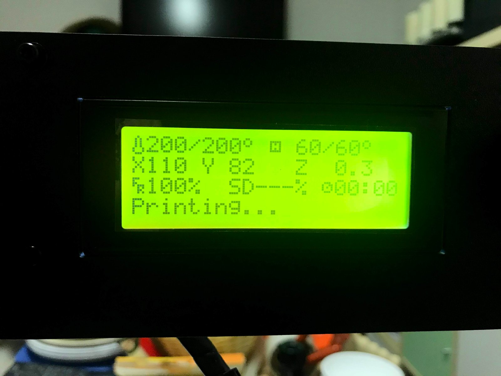

Post by Lukas71 »
Good morning, William,
last night I changed the firmware.
Right now, I've been calibrating the printer, which I did as follows:
the printer(X,Y and Z) are in the home position, then I unlocked the motors and adjusted the height of the Extruder to the printing plate on all four corners and the middle with a paper strip.
Then I moved all elements to the Home position and confirmed with Set Home Offsets.
Unfortunately this did not help, the printer does the same as before. :shock:

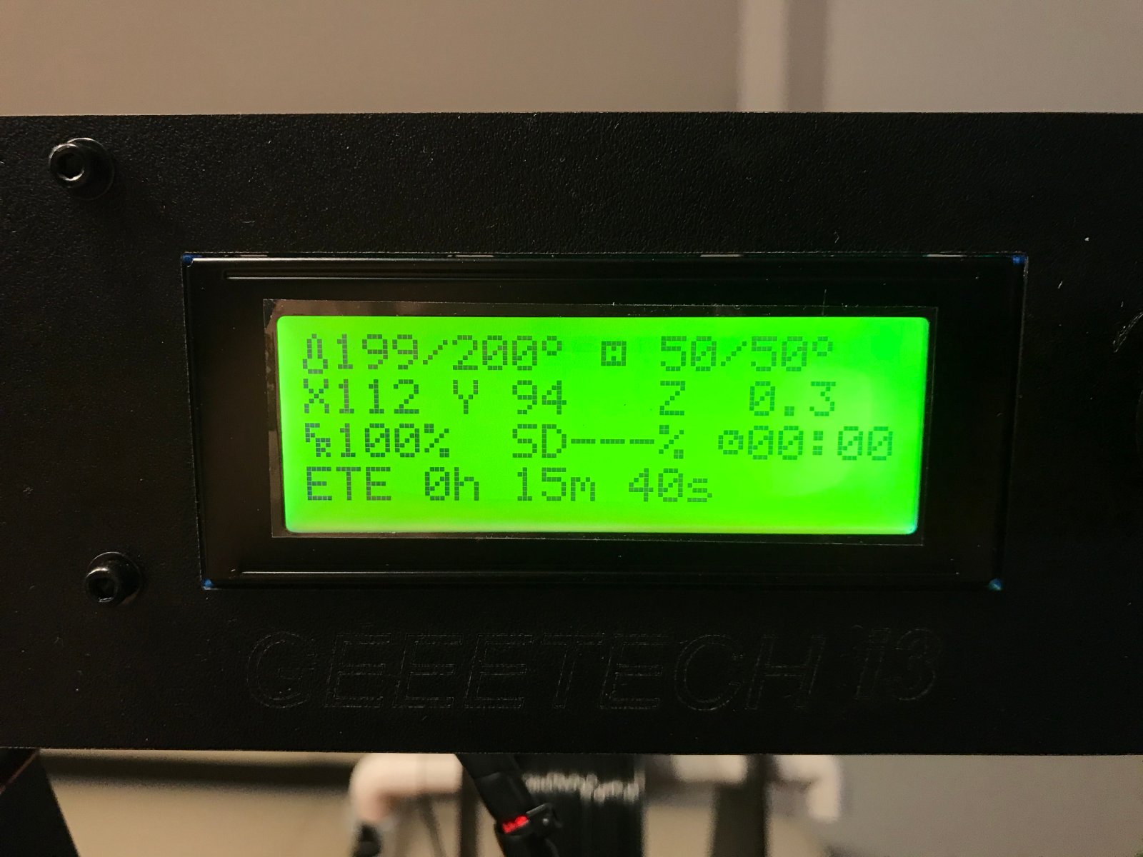

During printing the display shows: X 110, y 82, z 0,3, that means the printer is printing in the air :lol:
If I move the printer to the home position, the display reads: X-80, Y 0, X 39.99.
Am I doing something wrong during calibration :?:
Greeting Arndt
