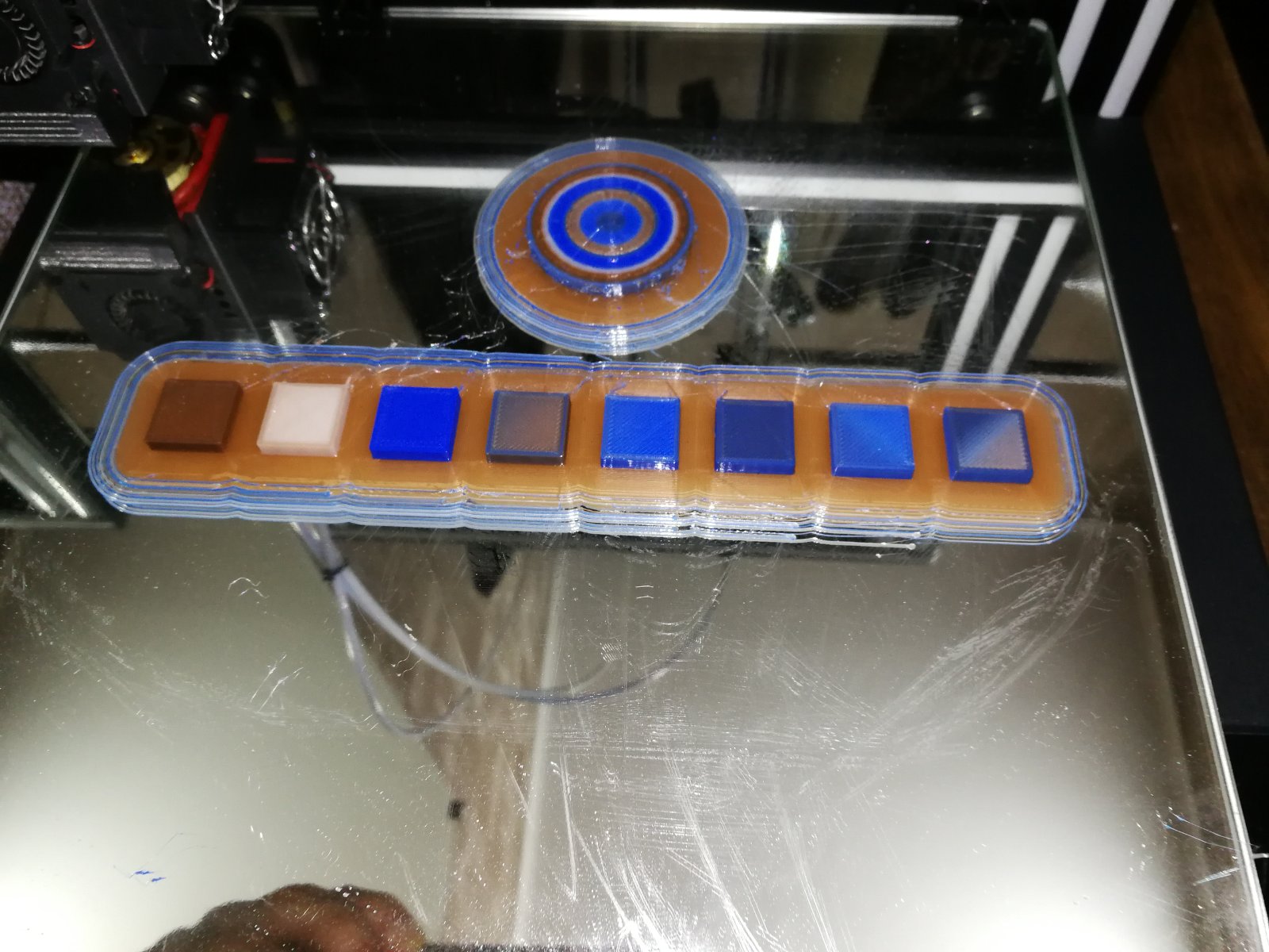

I wrote script and have printed test squares. My settings for virtual extruders were:
T0: 1.0/0.0/0.0
T1: 0.0/1.0/0.0
T2: 0.0/0.0/1.0
T3: 0.5/0.5/0.0
T4: 0.0/0.5/0.5
T5: 0.5/0.0/0.5
T6: 0.0/0.7/0.3
T7: 0.3/0.7/0.0
I have used following filament: brown, white and blue (yes, it is not the best choice for color mixing but this is the only colors I have at the moment). Result photo (8 small squares):

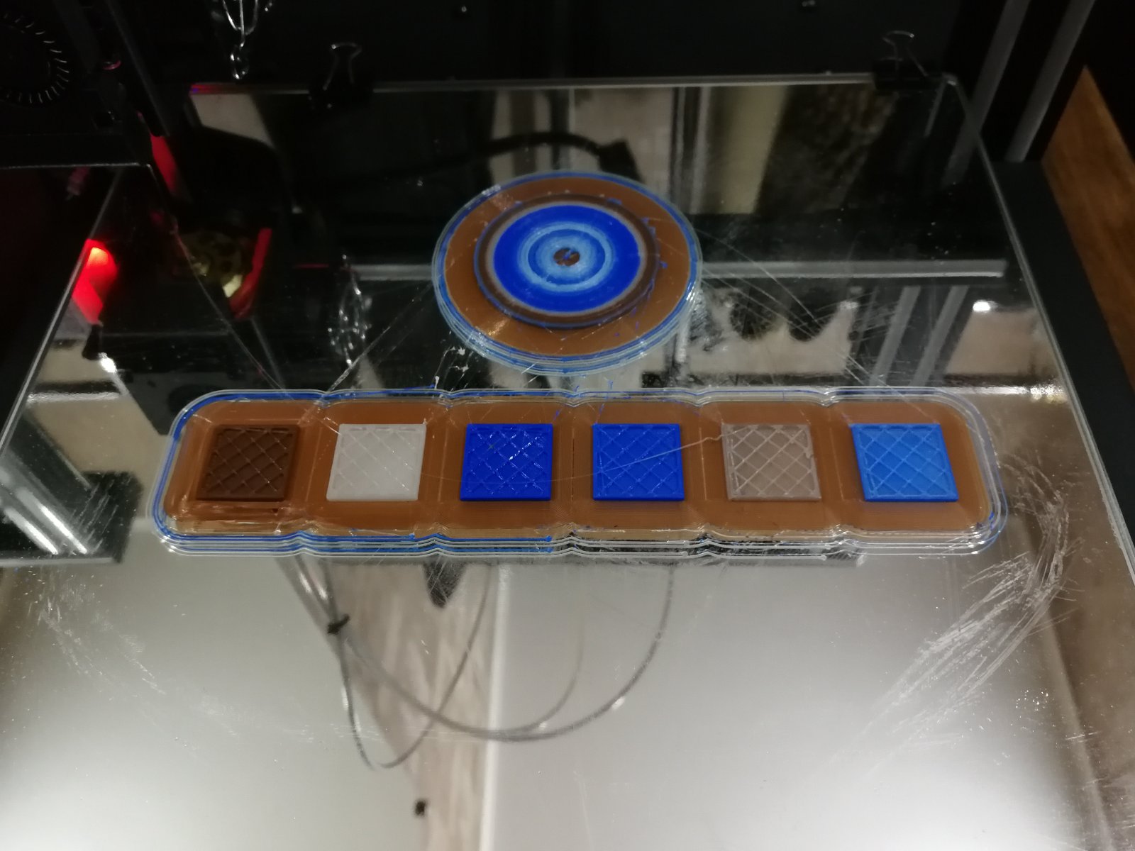

Another test (6 big squares, slightly different settings with prime tower volume increased):
