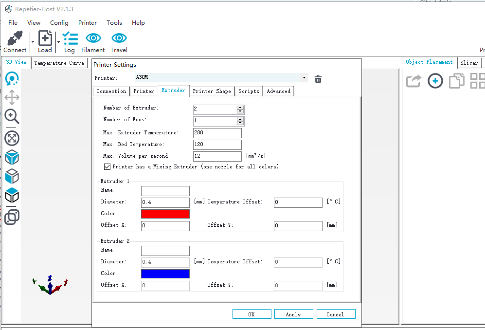

Also we can not use two extruder - may our setting is incorrect. how to check for use two color?
Re: Geeetech A30M profile setting for Simplify3D and Repetier-Host
:D Hi,this is my settings
you can refer to this:
I hope this can help you.

we do this setting, but don't work! :roll:
Our output is only one color. What solution do you have? :idea:
:D Hi, the extruder is the hot end of two in and one out,
If it is a color mixing setting, you can set it on the screen according to the color mixing ratio;
Or use the color mixer to set it up.
If it is the choice of extruder you can refer to: https://www.youtube.com/watch?v=yY2QvpWOXYE
