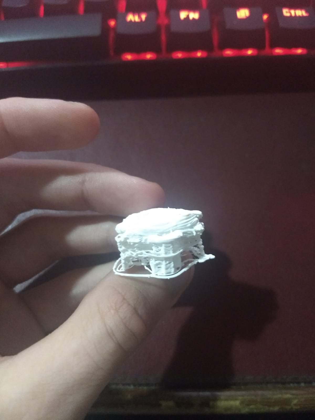

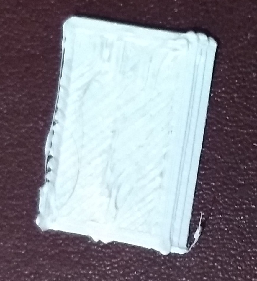

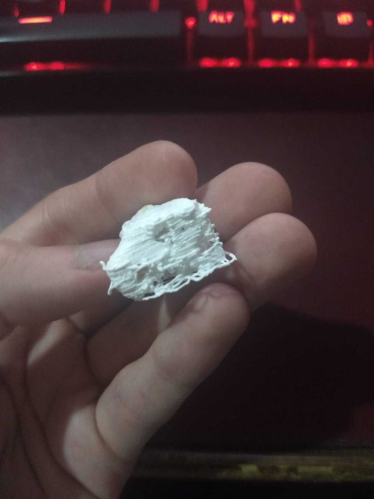

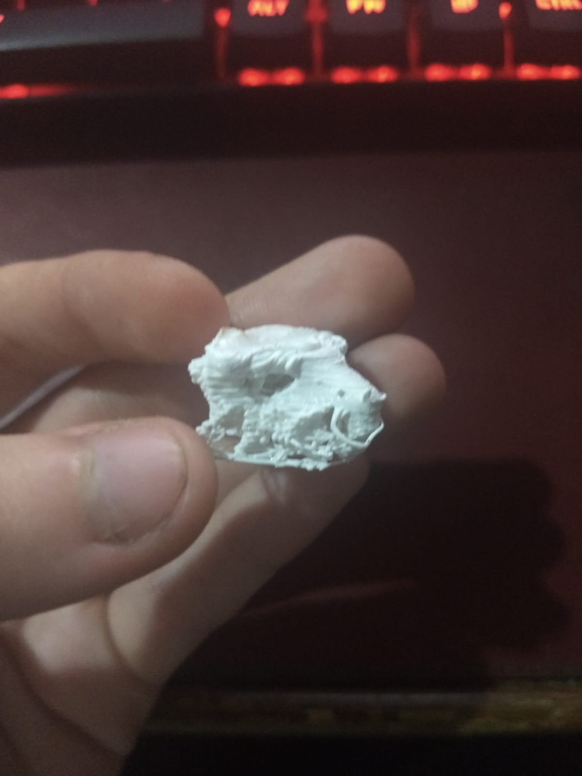

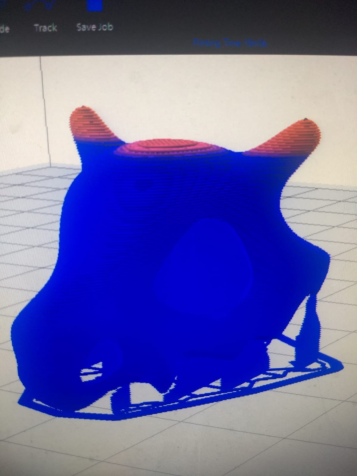

I have a problem which is that it prints the pieces badly, for example in the xyz cube it does not print the letters (here a photo), or this cubone skull also failed in the end and the horns were missing.
Another rare mistake is that when printing has rare errors, an example, I want to print a mini drone frame and when it is round it prints a weird line or does not follow the guide that easyprint 3d shows me
bad impression
bad impression
- 662ee0f6-5352-4460-87c8-dbddeb2bab94.jpg (107.08 KiB) Viewed 5921 times
- eb2aba73-1ab2-4f84-bdde-ec22b15b03e2.jpg (75.86 KiB) Viewed 5921 times
- a205121b-d9c6-4409-8f48-97bd66e86ba5.jpg (76.03 KiB) Viewed 5921 times
- 655bd493-bdc5-4363-9a1d-7ddb3cd48789.jpg (95.58 KiB) Viewed 5921 times
- 25f5673a-d737-48c9-a3d6-6d7bd5b59713.jpg (120.44 KiB) Viewed 5921 times
Re: bad impression
Then check the flow rate in the section settings;
For slicing software, you can use Repetier Host or Cura.
Printing speed reference range is 30-60mm / s;
If the model itself has a large inclination, support may need to be added.

Re: bad impression
it seems to me you have problem with printer setings
Maybe you have a layer thickness too large. For starters and even later, 0.2mm is just right.
did you set the correct printbed height?
watch this video
https://www.youtube.com/watch?v=3DjCE6qvYmc
also you have the first layer too thick.
if you have a nozzle of 0.4 the first layer of 0.3 is enough.
watch this video too.
https://www.youtube.com/watch?v=fb7lit5ZRq4
I don't think that print has anything whit support. first layer is bad.
for start and calibrate printer, use models without support like xyz cube or 3dbenchy
and
if I may mention
this is a great site for troubleshooting
https://rigid.ink/pages/ultimate-troubleshooting-guide

Re: bad impression

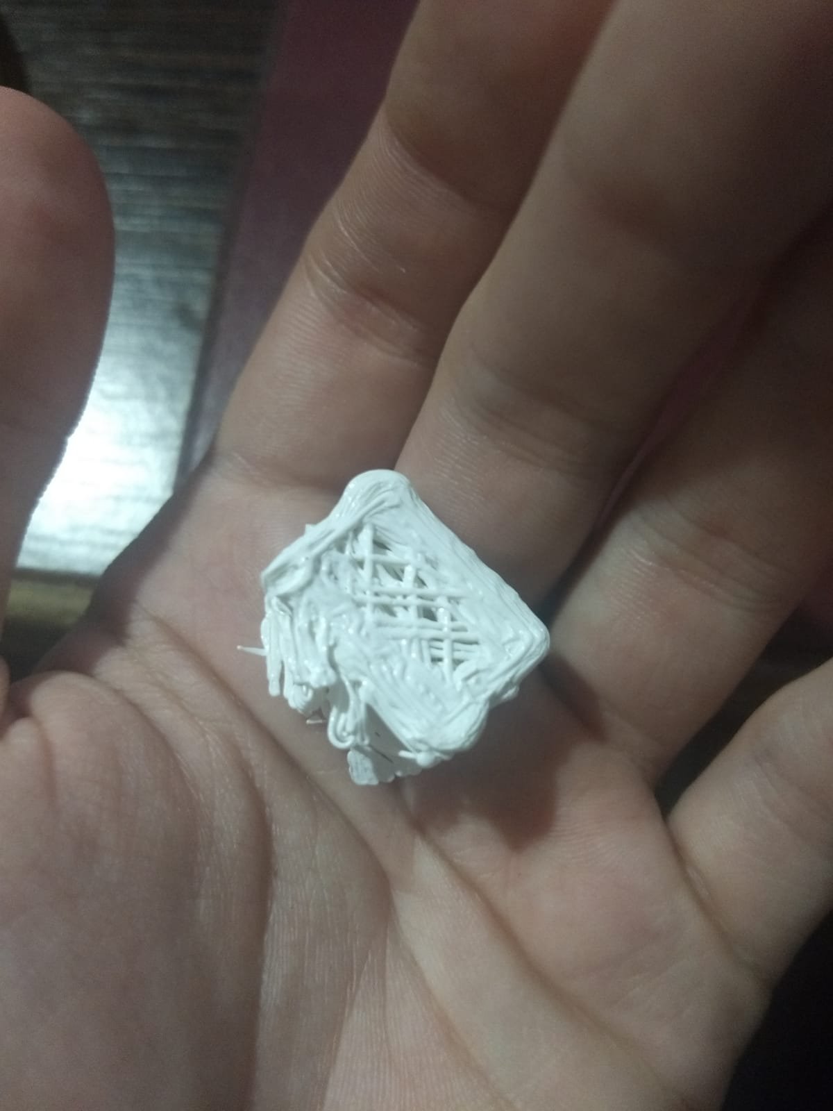

I was following the videos and in cura when printing goes well but I have layers shift, How can I solve that?
Re: bad impression
You can check:
1. Adjust the tightness of the belt properly;
2. Whether the bearings and pulleys are issued with cards and the cards are lubricated with lubricant;
3. Reduce the printing speed appropriately;
4. The driving board voltage is in the range of 0.8-1.2V.

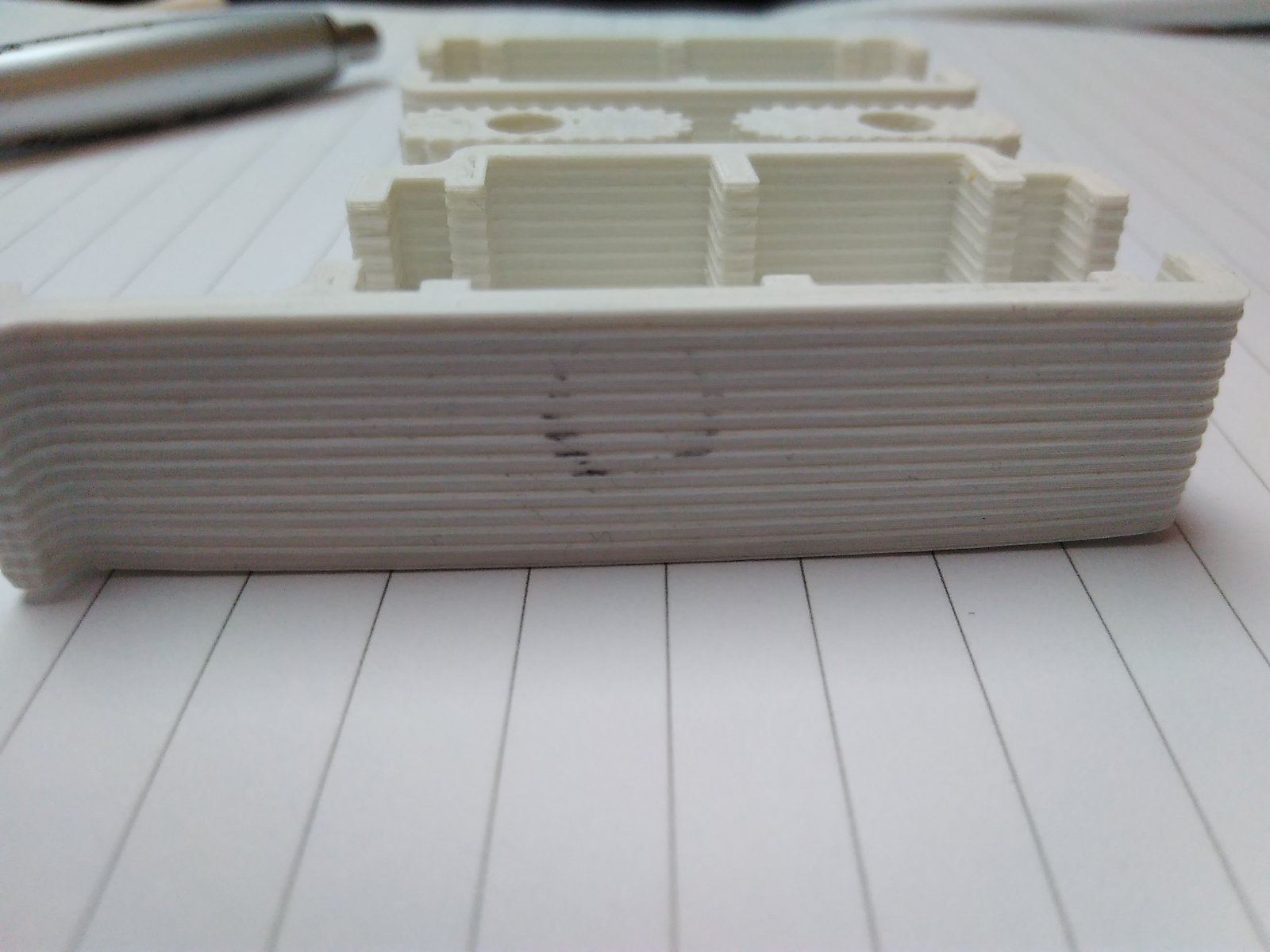

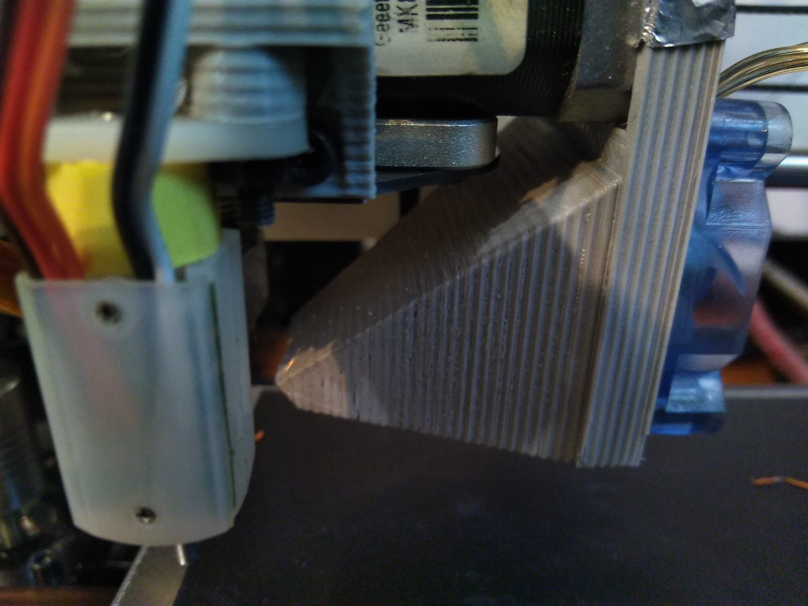

Does the layer shift look like this?
Just a question.
- IMG_20200123_095655.jpg (149.74 KiB) Viewed 5840 times
- or this
- Z WOBLE.jpg (211.64 KiB) Viewed 5840 times
Re: bad impression
I already reduced the speed and the same thing happens, this is how the layer shift looks
- IMG-20200122-WA0008~2.jpeg (128.81 KiB) Viewed 5793 times
