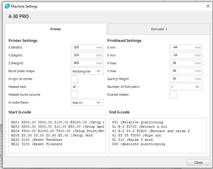

Hello i Need Help for I need help with the configartion of the a30 pro Printer for the slicer Cura 4.5
Someone can post a Profile please for the correct setting. sorry but I'm here an absolute beginner

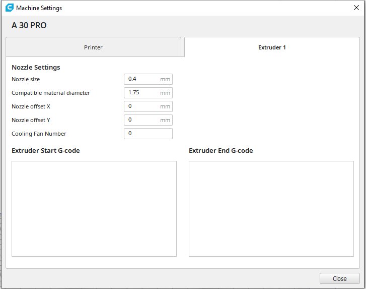

I received this from Judy Yu at Greetech compliments of my GREAT sales rep.. My start and end GCode is the same as my CR 10S pro for now. You can also add the CR 10S Pro, change the bed size from 300-320 and just rename the printer.
A30 PRO Printer CURA 4.6.jpg (70.24 KiB) Viewed 21195 times
A30 Pro EXTRUDER for CURA 4.6.jpg (35.72 KiB) Viewed 21195 times

Thanks Ricbru and Judy Yu. Newbie with an A30pro so this is very helpful. Just setting up my first prints through Cura. Test print came out OK, so trying my own designs now. Happy Days! :)

Post by Agoodevans »
Ditto! New machine so this provides a great start. First print was OK but not symmetrical. Printed 50mm cube so hope to adjust.
