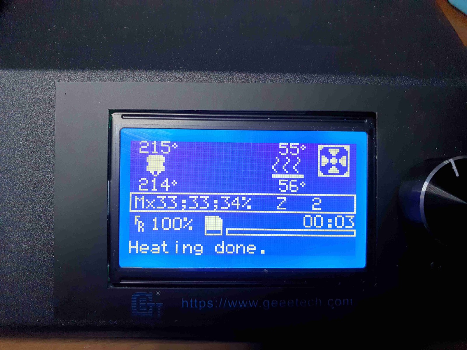

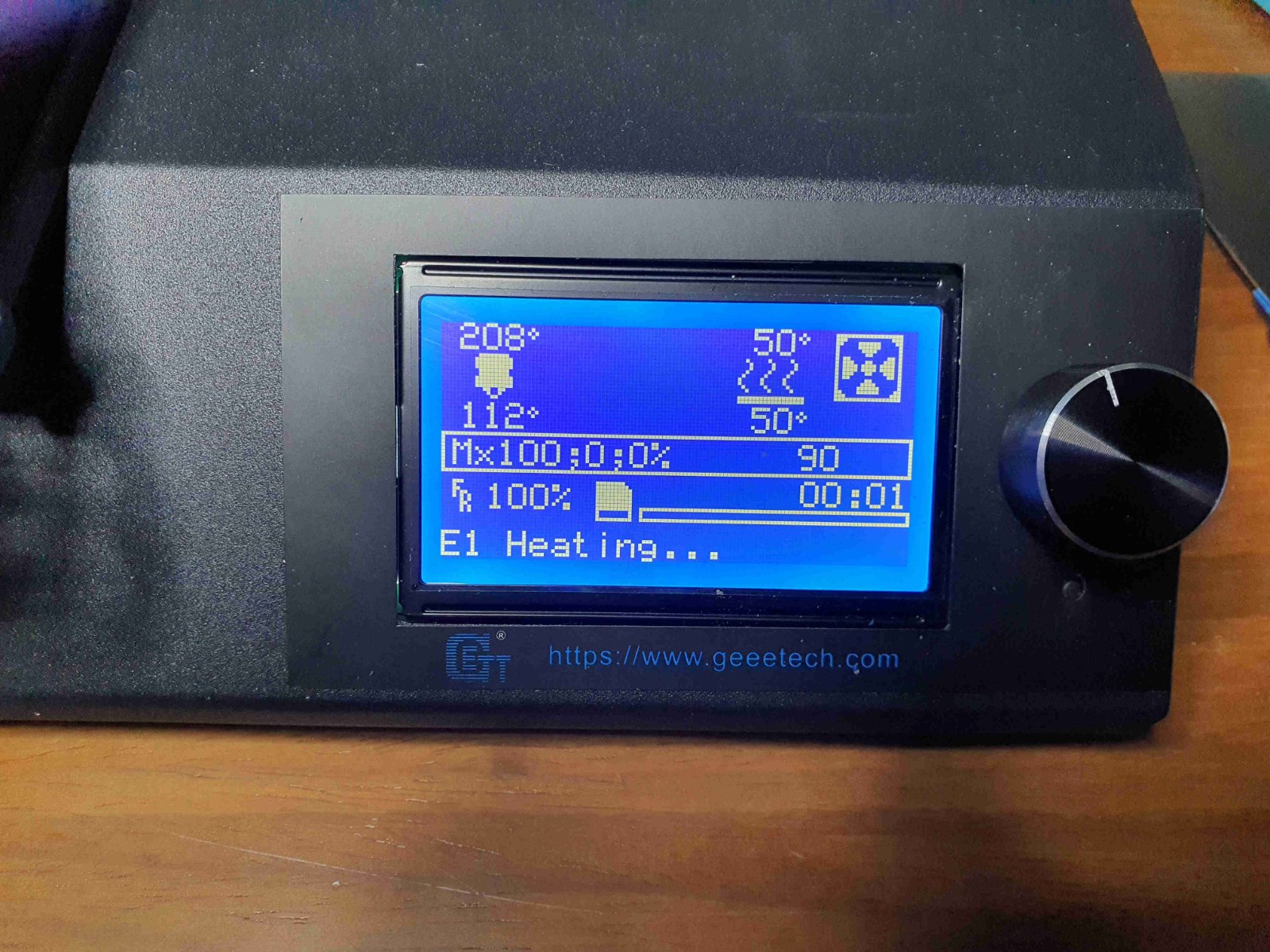

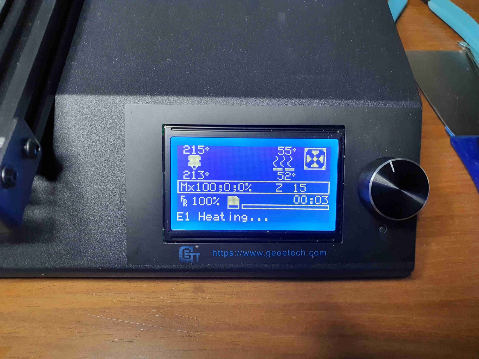

I'll explain what happens with the photos of the various phases of the display. Given, as already mentioned, that with Cura I disabled the other "extruders" and enabled only the number 1.
As you can see, following the img, everything starts well when it reaches the temperature that I set from the slice, automatically increases both the temperature of the nozzle and of the plane to default values that I have not set.
Then he always mixes the colors completely automatically, not caring about the settings I gave to the slicer. To make it print with a single color I must necessarily act on the display.

Re: Print with a filament
Hi, your picture shows that when the heating is completed, the color mixing ratio is not 100: 0: 0.
You can try changing the model and re-slicing.
