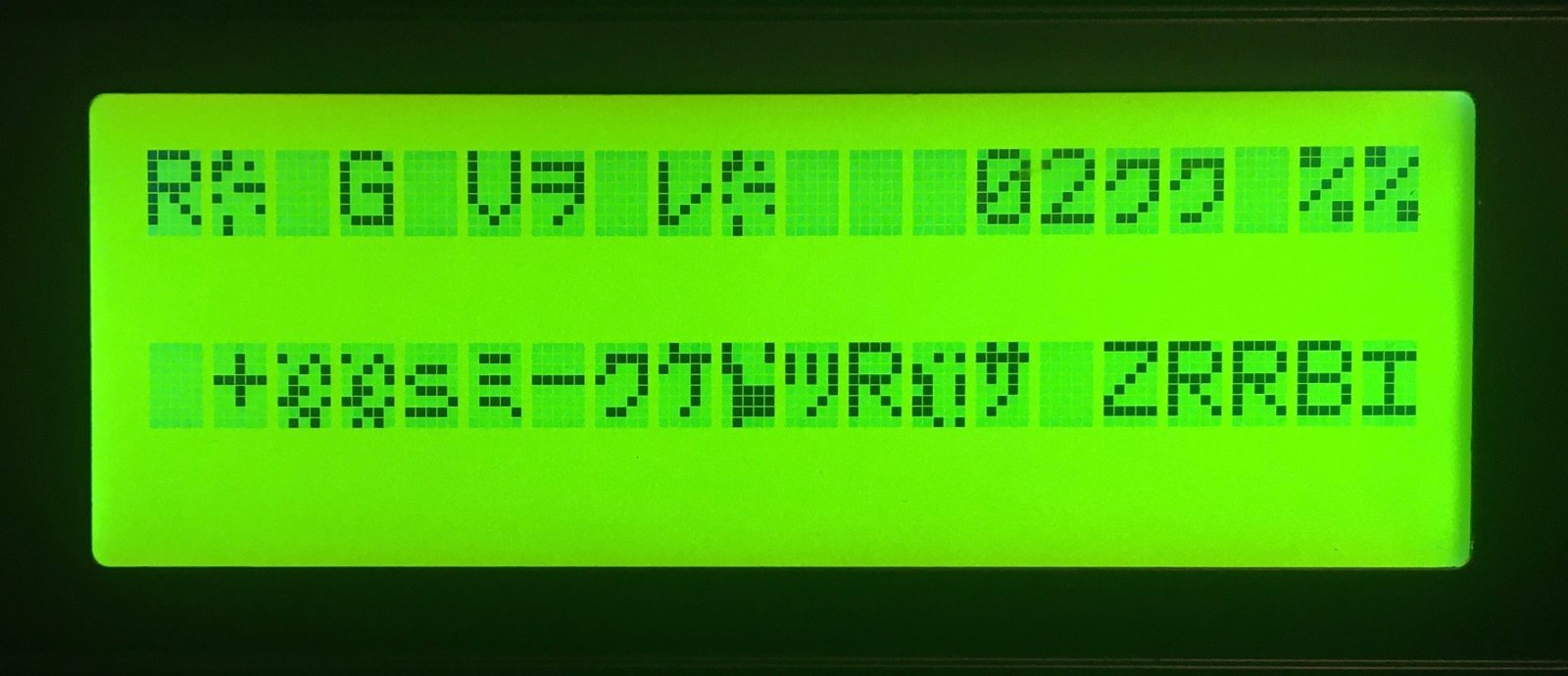

I just received and built my new I3 Pro B. Everything went smoothly during the build, but every since the first time it was turned on, the LCD only shows a series of garbled characters that change every second. I've googled around and tried as many suggestions as I dare.
Board versions are GT2560 Rev. A+ and DZ2004A-V1.3.

Resolved the LCD display issue after many wasted hours because I was searching for a .bin firmware file. A simple mention of the fact that it's a .hex file and that that's what you need to change the dropdown box to look for would be a nice thing to add to the Firmware Update Guide.
