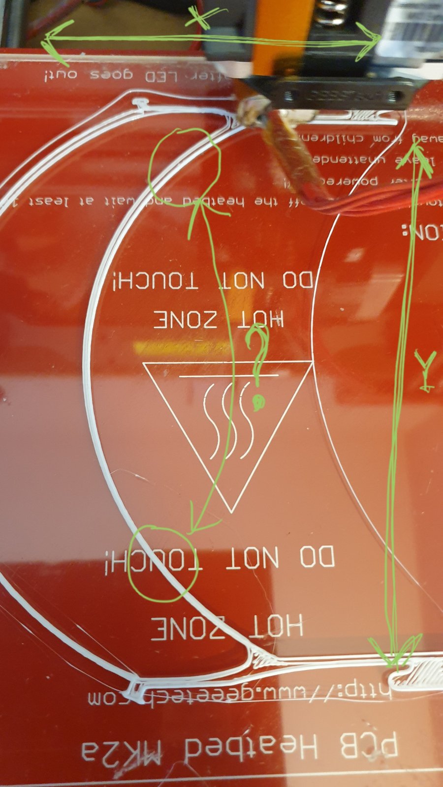

We are printing FaceMasks for hospitals. I am getting the following disadjustment on them, attach picture.
As am not used to print in my 3D, I do not want to touch if I am not sure it will improve the printing.
Could some one please help me to adjust X Y axis ( I think it is the problem)

The model is big but I have no error to be out of range.
Yes, I calibrate with a paper and hot bed is ok, it prints good.
But it seems that X axis and Y axis is not well adjusted because curve is different in each side.
As you can see in the image.
Any idea?

Hi, you can adjust the belt of the x/y axis.

I tight the belt of Y axis and now it works.
Thank you very much!!!
