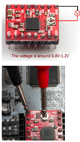

Hi, my X-asxis A4899 (red) have a bad voltage from the srcrew and the ground, i find 0,02V and when i try to increase it jump to 5,00 V without any intermediate value. The oders A4899 are set correctly to 1,1V. I must change the controller?

red A4988 Bad voltage value
- red a4988.png (203.23 KiB) Viewed 5272 times

Hi, Can you adjust the knob,
Increase voltage clockwise
Adjust the voltage counterclockwise
Can adjust
Measure while adjusting.
Can adjust
Re: red A4988 Bad voltage value
Hi, yes i try to adjust via the screw but it jump from 0,02V to 5V no intermediate value is possible to set even with millimeter movement of the screw :
Thanks
Thanks
Hi, if so,
May lose control of driver board adjustment.
