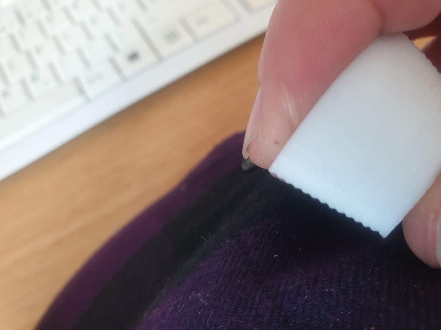

after i printed a calibration cube i see that the z edges of the cube are note 100% straight.
i looks likes a liite zig zag but only very very little zig zag. is there a solution for this?
is the temperature to high so that the pla dissolves unter the presure of the above layers? what do you mean?
here is a example of the printed object

Hi, You can see if the z-axis threaded rod is bent
Check if the z-axis fixing plate is loose,
Tighten if loose.

the rod is a little bit bend and i correct it a little.
but the couple on the video is also not in center therefore i think it is a problem because it shake the rod or isnt it?
