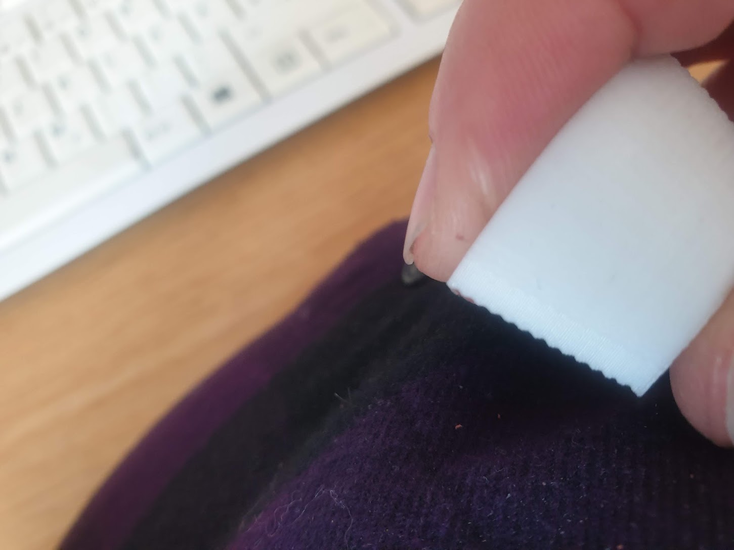

after i printed a calibration cube i see that the z edges of the cube are note 100% straight.
i looks likes a liite zig zag but only very very little zig zag. is there a solution for this?
is the temperature to high so that the pla dissolves unter the presure of the above layers? what do you mean?
here is a example of the printed object
