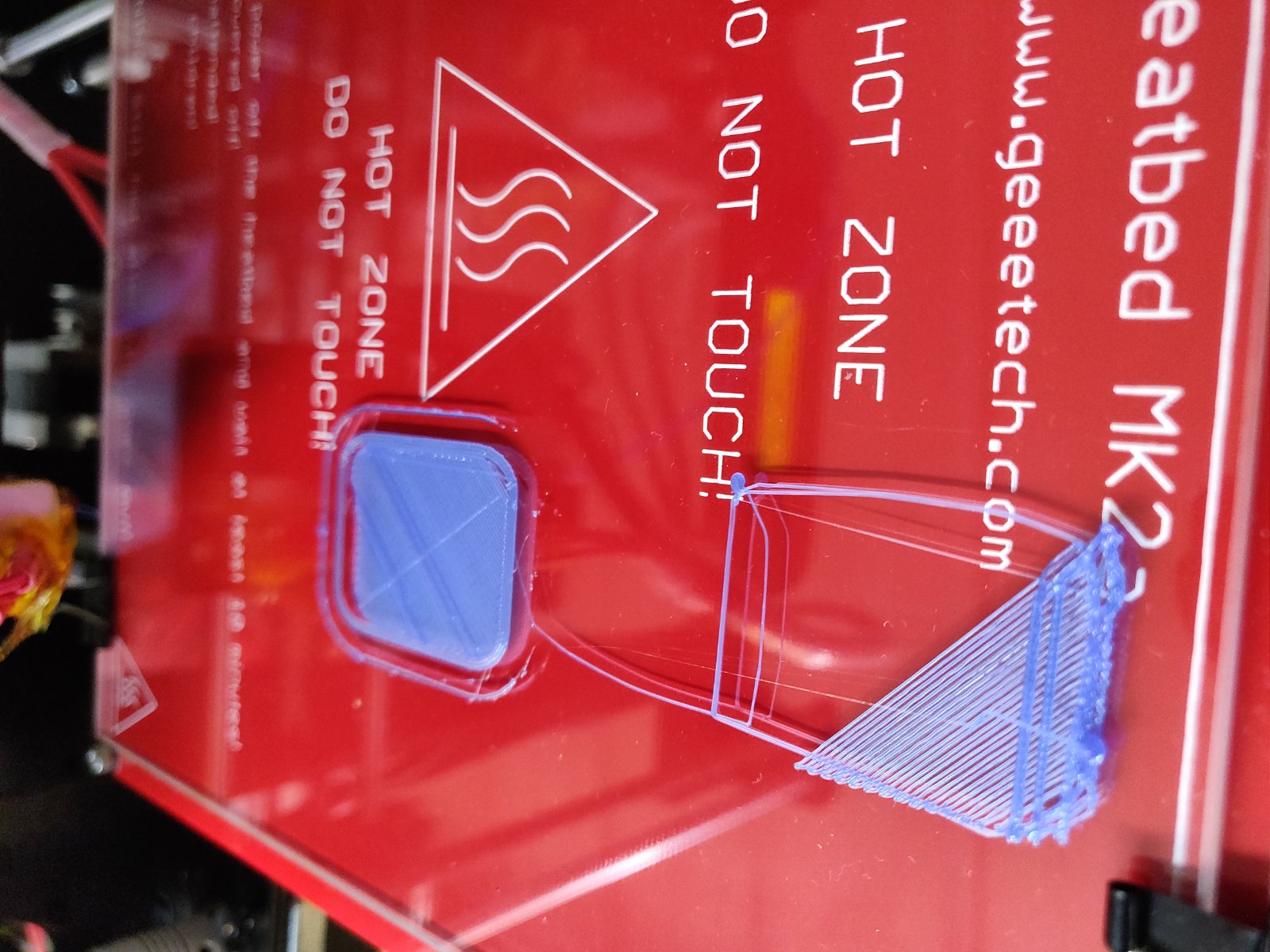

I have an i3w pro and this is happening (with any software) - on the second layer it goes to the wrong place on the bed and tires to print off the bed.
I've tried different print files and they do similar things
can you tell me where to look to fix it?

I slowed down the speed in the printer config and tried again and this is what I gort
I don't see how it can be either speed or friction. The error is EXACTLY the same every time I print - the misplaced layer is in the same place with each print.
DIY build, about 6 hours.
Getting the stupid thing to work, about 3 days so far.

It is not too large - that image shows you the base eof the model - about 40 mm x 30mm and apporx 15 mm high.
ever single model i try this with this happens - first layer goes down nicely then the ptrint head goes off to a completely different place for layer two.

It looks like the leveling is bad. The backside is getting smushed and the front is extruding too high over bed and not sticking.
I'd also add a second stroke around the outside

but are either of those anything to do with the print printing in the incorrect place on the table?Sodium100mg wrote: Wed Apr 29, 2020 11:29 am It looks like the leveling is bad. The backside is getting smushed and the front is extruding too high over bed and not sticking.
btw - I levelled the table with the double folded paper at front left, front right, rear right, rear left and middle - it is the same (light pull) tension under the printhead in all 5 locations.
by "add second stroke" - do you mean edit the model? - this printing in the wrong place on the second layer happens with every model I print.
I'm not really concerned with the quality of the print at the moment - what I want to do is understand why the second layer is printing off the table and nowhere near the first layer.
maybe I'm doing something incorrect with the print process - at the moment I have this and a couple of other (gcode) test prints. I load them(in repetier host or EasyPrint3d), connect to the printer and click "run job" - am i supposed to do something else?

go down to 1 layer of paper. The pull should feel like somebody is holding the piece of paper fairly lightly. You feel some resistance when pulling, but not much and for sure, it should not rip the paper.
The nozzle needs to be about half the nozzle diameter off the bed. The back area looks to be too close and the front too far. Think of it like spreading peanut butter on bread. If the knife is too close, the bread will tear, where if the knife is too high, it will not stick to the bread.
From the photo, it looks like the problem is bed leveling.
The line I was talking about is the skirt that is added by the slicing program to the model. Yours looks incomplete. When the printer first starts printing, it takes a bit of extruding to get thing flowing. Being too close to the bed makes it hard for the nozzle to extrude. When printing, if the nozzle isn't flowing good, it will have problems. The slicer has a parameter for "skirt outline" (simplify3d under additions) or skirt line count (cura under build plate adhesion). You want to see a nice solid line for the skirt.
For PLA, I have good results with a 50c bed temperature, filament 200c is a good starting point.
Download a bed leveling test file and follow the bed leveling video. Not until all of the patches lay down the same with good adhesion will the printer work right. With the test file printing at the corners, the corner that is not spreading right can be raised or lowered and try again.
https://www.thingiverse.com/thing:34558
https://www.youtube.com/watch?time_cont ... e=emb_logo
