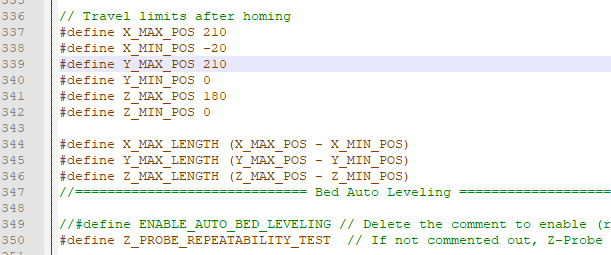

Re: i3proB with 3dtouch Sensor Alignment :?
Hi,I'm sorry I didn't help you before.
The offset is normal, it will not affect printing.
But you can set the offset in configuration.h. For example, an offset of 20, you can change it as shown.
Hopes can help you.
Hopes can help you.

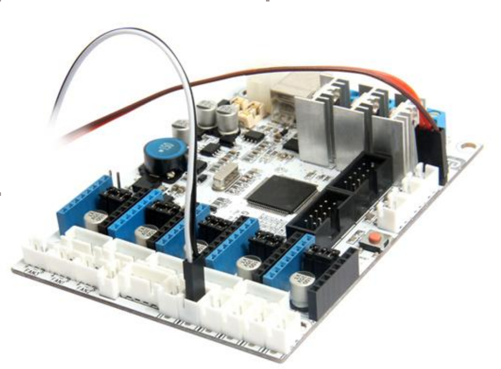

It appears the firmware update I downloaded from the site here that was for the i3 pro b gt2560 A+ with 3d touch either did not install or expects a different configuration. It was treating the sensor as a z endstop as far as I can tell hence the single self test at power on and no response to commands to run the self test.
The instructions for installing the 3dtouch call for it to be connected instead of the z min endstop, is this correct? Another version of the firmware available here calls for the 3dtouch to be installed in the z max endstop socket instead. Short of going through the arduino code line by line i'm not sure what to do.
Hi,It should be connected to the z min endstop, as shown:
