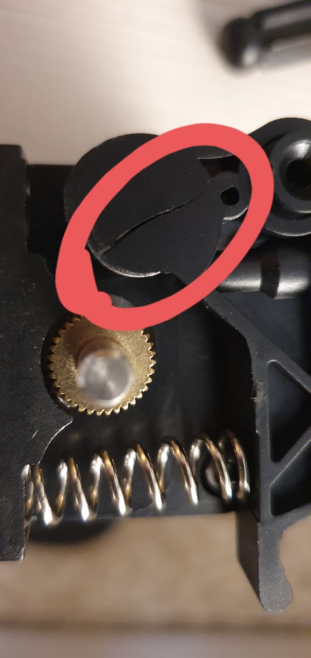

The extruder started to make a clicking noise, I found out that the extruder piece, was damaged,
photo_2020-04-26 20.32.50.jpeg (69.81 KiB) Viewed 8532 times
The clicking noise was the stepper motor that coud not rotate.

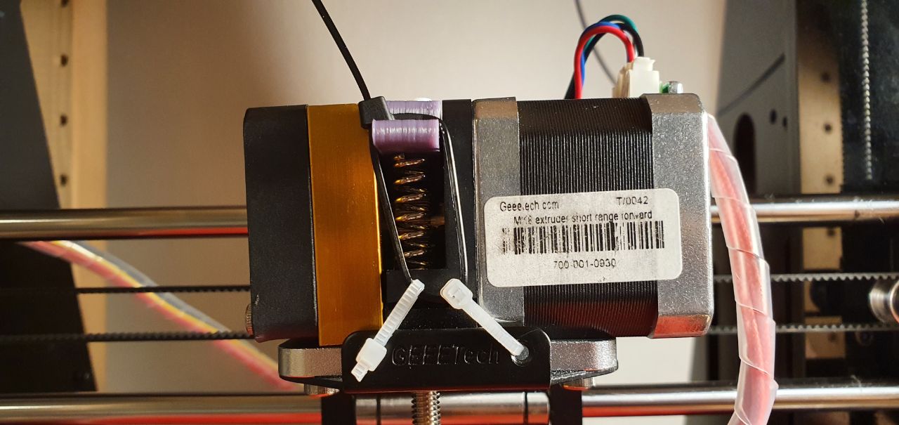

Thinking that the problem was the ABS, i put the PLA back swearing not to use ABS ever again. (even because the plate took a while to heat up and was boring) the clicking continued, but when I pushed the filament or press the release buttom, the filament extruded fine, so I just put a rubber band to keep the release button pressed.
Then I printed a new piece, and replace the broken one. For half print was fine, then I put the rubber band back.
Now I update the rubber band with some cable ties
photo_2020-04-26 20.40.54.jpeg (108.41 KiB) Viewed 8532 times
There were a couple of soved problems i didn't mention, like the distance between the nozzle and the plate, and the jammed z axes, but now they're fine...
Now, my problem with is that the printer can not extrude properly, I mean, I launch the print, it make a couple of loops extruding and not extruding, and then it start to print the model, but sometimes it fail to extrude some parts, it does it randomly: sometimes is the filling, sometimes is the perimeter, the lack of a recognizable patterns is frustrating.
